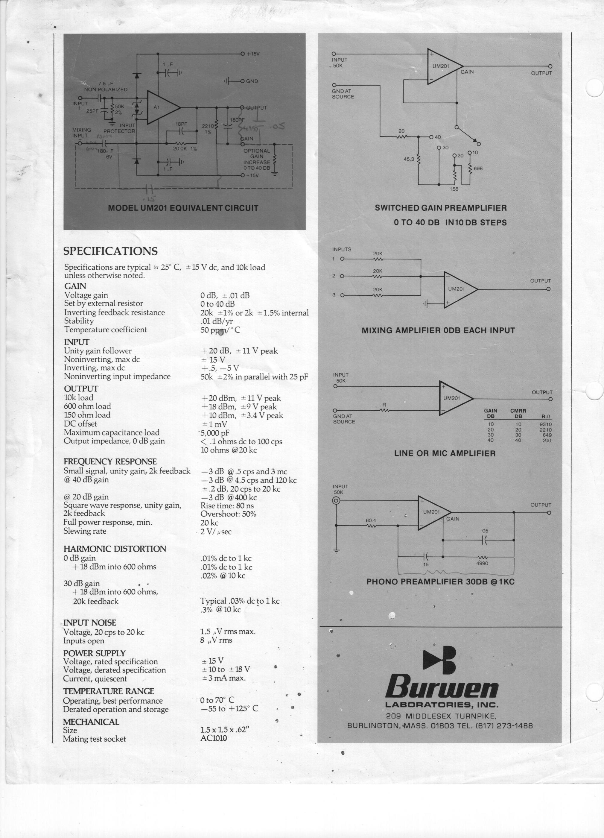

What we could do with IC's in 1970.
Waly, it would be interesting for someone with up-to-date experience with IC design to tell us about the state of resistor non-linearity in modern IC's both for industrial and consumer applications. For example, what sort of linearity would we expect of the resistors in a device like the 4558, perhaps compared with the resistor linearity of a single resistor if it were measured separately, from an AD797?

I started with a history of being enthusiastic about IC's even 45 years ago. However, they never quite did what I needed from them, SO I went back to using discrete component design with great success.
Now, what about more modern IC's? Some are pretty darn good, so long as you don't use them at their limits, however I can still get better subjective performance from discrete components, typically jfets, so I design almost exclusively with them.
If you, Max, do not know the intrinsic linearity of jfets compared to bipolars, then I just can't answer your question.
What it essentially comes down to, is the OPEN LOOP LINEARITY of an individual design. Negative feedback, while reducing steady state harmonic distortion, appears to convert the open loop nonlinearity into another form of distortion not picked up by THD or IM testers. In any case, the human ear tends to notice it.
