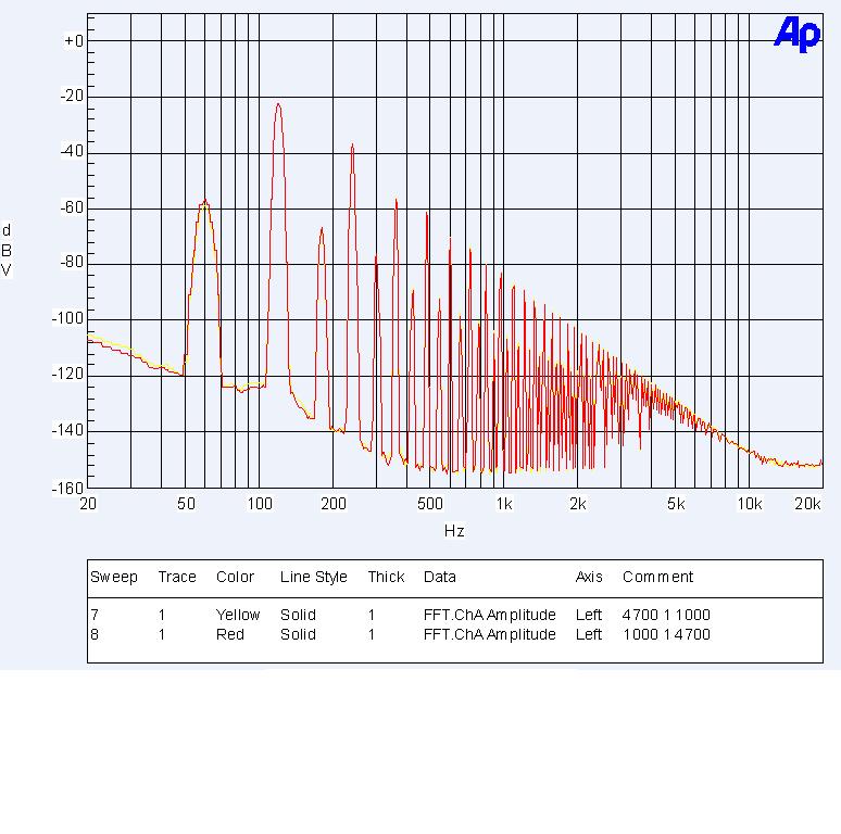

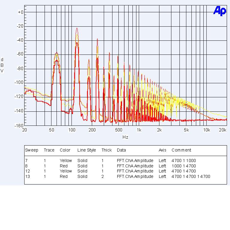

George,
I reran the ripple test and got more of what I was expecting.
Attached is an FFT showing a CRC of 1000 uF 1 ohm 4700 uF and then reversed 4700 uF 1 ohm 1000 uF. Almost exactly the same.
The big Duh moment was when I tried a 4700 uF 1 ohm 4700 uf against a triple 4700 uF 1 ohm 4700 uF 1 ohm 4700 uF. Results that stood out.
The other issue was capacitor brand. The cheapies had the same results for the first few harmonics but were no where as good at the upper ranges! So now I have to order in samples of all the common brands!
Ed
What was the source of noise in your previous measurement?
Before start ordering bags with capacitors, try to test what happens with these 3 psu setups when the load is not a simple passive resistor.
Connect them to supply power to a small amplifier.
Feed a freq sweep to amplifier input.
Do this at 3 power levels low, medium, high. Probe the psu rails.
Then spell some #@%!! on me
(I am not in a good mood)
