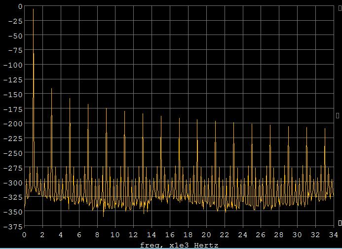

Mathematically this is the spectrum of a perfect 1ppm square law compression. Ignore the numerical noise.
Thanks, pretty much as expected, not quite as measured, not really a surprise as has been mentioned there is some second harmonic, possibly related to thermal radiation.
