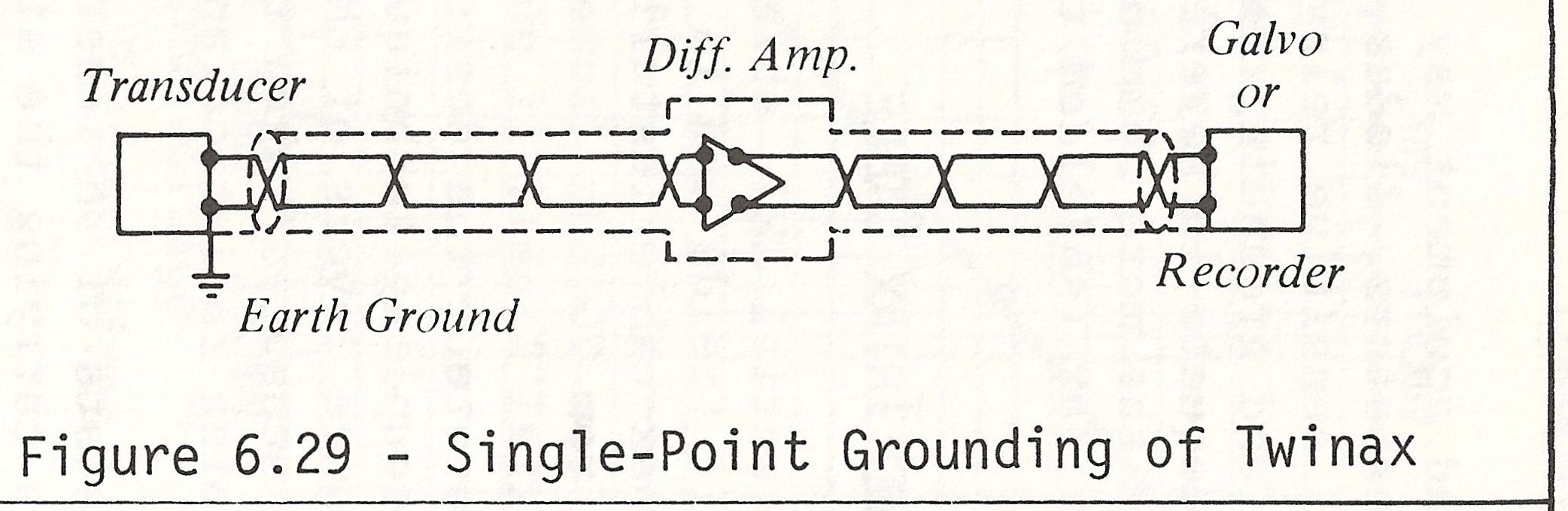

... which actually is the purpose of the XLR pin 1 - there IS NO 'pin 1 problem' just connect the screen, through pin 1, to both chassis, right where it is bolted to the case, et voilá there's your tunnel.

Suppose you had 2 tunnels, and just one Pin-1 exit on either side
(sorta stiff neck vision)
Useful stuff, thanks! I am apparently using the one with the asterisk and the way Jan describes.

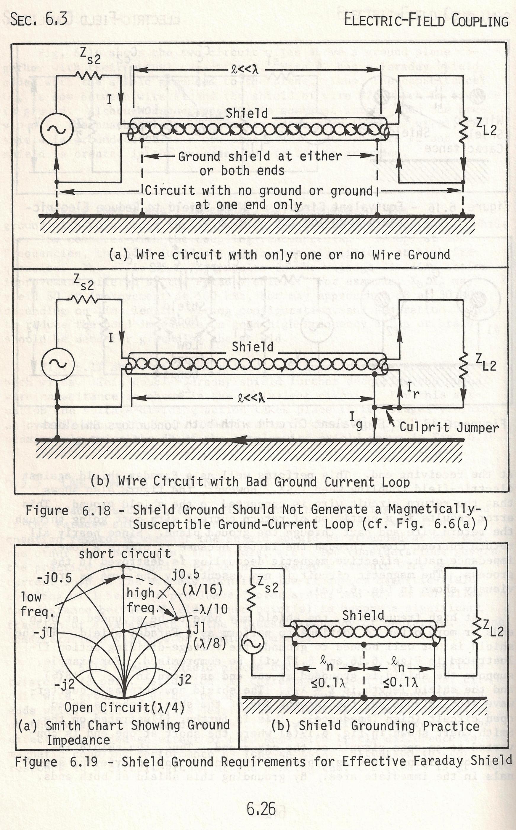

yes, it is a very good way. See below. However, -- and there is always a however -- There are many ways the shield can be connected to each other at both ends and thus be compromised in effectiveness; Pathways which are not immediately apparent to the eye [this relates to Demian's/1Audio comments]:
One is to have the ground wire on the ac power cord/plug put each end together.... only takes one pair in the entire system of equipment.
The other is paths to the chassis from transformers (leakage and field induced currents). Thx-RNMarsh

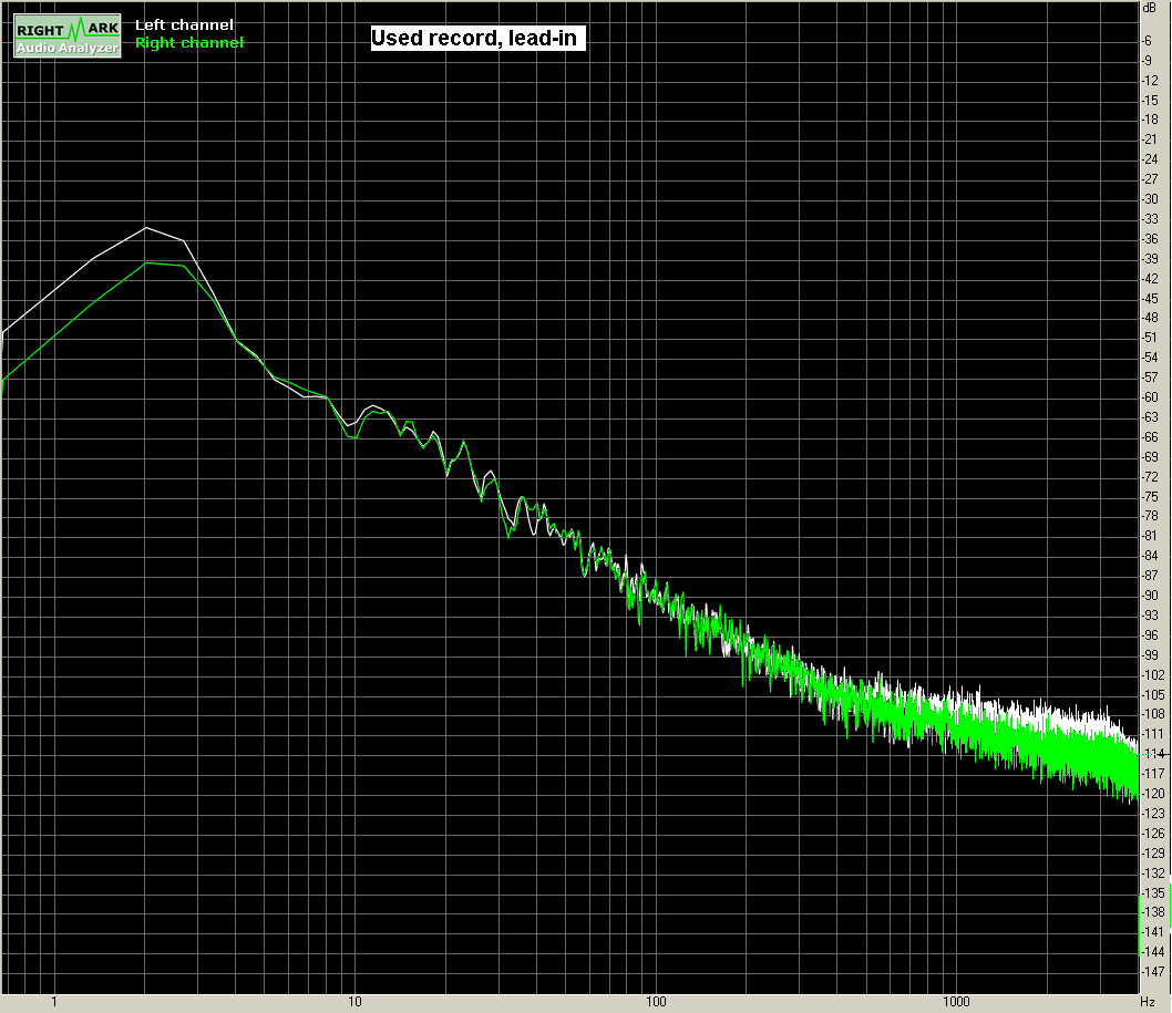

Some numbers regarding LF noise content of records
http://www.diyaudio.com/forums/analogue-source/96521-low-frequency-content-lp-vinyl-records.html#post1138292

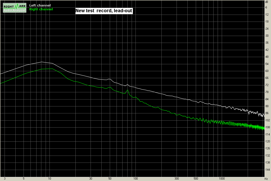

attached are two snapshot from testings on my set-up 3 years ago. Pick-up point is the output of the RIAA preamplifier
(1 Khz reference tone 7cm/s modulation, reads –22db)
George
George
So these data are after RIAA equalization, and certainly point to the need for good overload margins (one of my reasons for using tubes). And they are consistent with my estimates for the extremely low levels of LF at the input. Thank you, George!

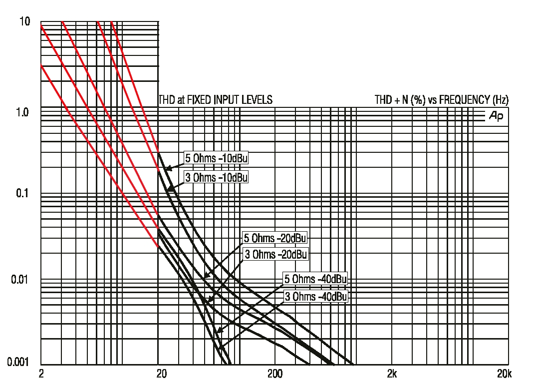

Can anybody extrapolate the transformer distortion curve shown down to 2Hz? '-)
There you go.
There you go.

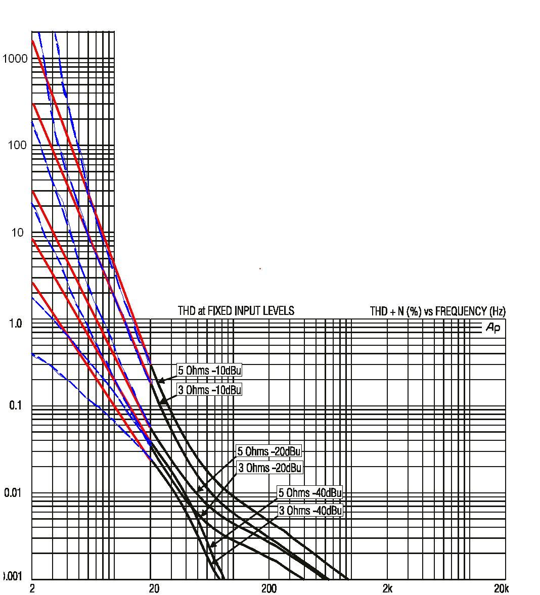

One step further
The original –40dbu curves seem to me bending a bit downwards. The rest curves seem bending upwards. If this is true, it should show something like the blue lines. But real measurement data at theses frequencies may show totally different distortion (for better or worse).
For me UL signal distortion itself is not important. What I find of importance is the amplitude of the UL signal, as it (a) will eat up overload margin (b) will intermodulate with the audio frequencies.
George
