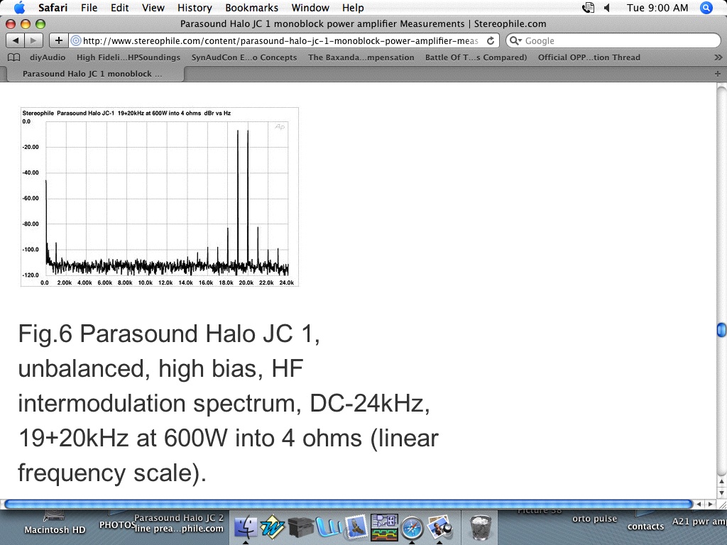

PMA, you are right. There is some 7th harmonic present at -120dB. It should go down at lower output levels. I suspect that the JC-1 power amp following it will be clipping at this point. Let me check. Yes, I checked: The output to the speaker would be 800W into a 4 ohm load. I suspect that even the JC-1 would dominate the distortion spectrum.

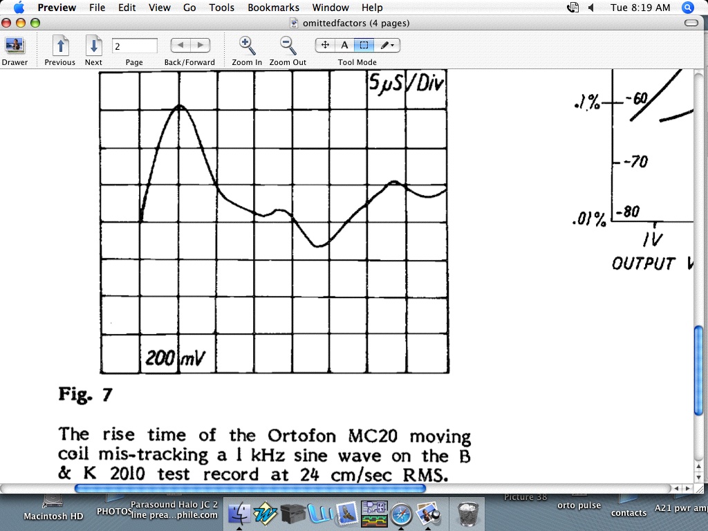

That is what I use in my JC-3 front end to amplify the first 30dB. Therefore it HAS to accurately pass the mistracking artifacts of the Ortofon cartridge which is a large pulse with a 5us r.t.
What my phono front end has to amplify 30dB with the LME49990. The AD797 sounds just as good, (but different) and is more expensive.

What is quite interesting is the fact, that the AD797, with no extraordinary slew rate 20V/us, performs in a 19 + 20 kHz test much better than many (or most of) devices with slew rate > 50V/us.
Not really; the large signal slew rate (usually specified in data sheets) has little to no relationship with the small signal slew rate (defined by the gain-bandwidth product), which is involved in the small signal 19+20KHz test results.
I've tried my 1/3 octave noise test at two speeds too, the stylus can't track the recording even when it stays in the groove. So remind me why this thread has circled again back 35 yr. to talk about why 741's are not good for audio.
