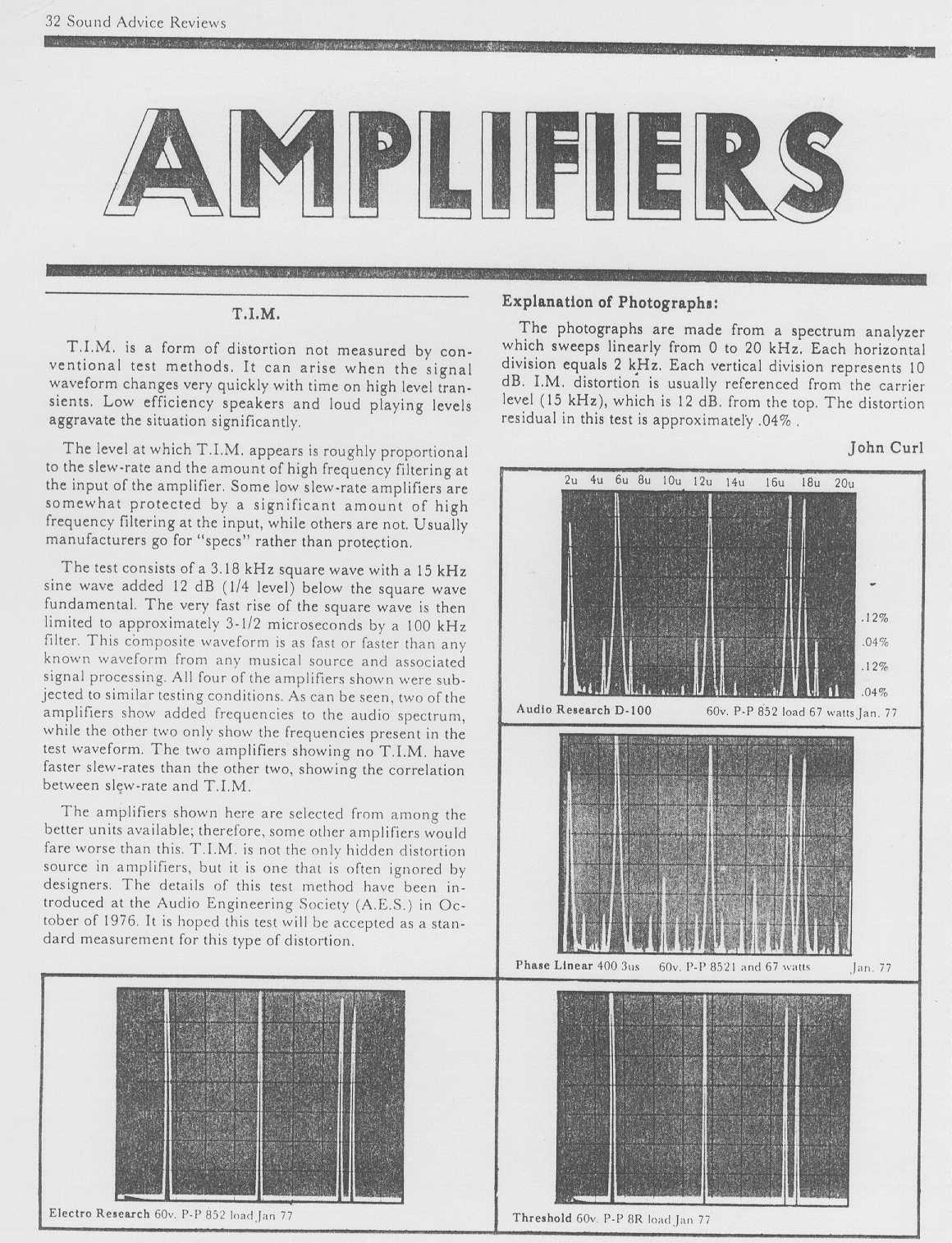

When I first started to work for Alembic, who did the PA and recording for the Grateful Dead, in 1970, I saw a DC300 parked in a corner. I was told by my associate that the amp sounded very 'weak' compared to its rated power. This we found was because of the extreme protection circuits that cut in very often. It should be remembered that this amp was originally designed for servos, both AC and DC. Audio was sort of an afterthought.
In 1977, John Meyer and I tested 4 amps for TIM(30) and published the results. The Crown and the new (at the time) solid state Audio research failed the test at 100W out. Two other amps passed.

I don't suppose it was this:
Somehow, my last response was lost. Thanks, Nelson Pass for giving me the more 'correct' version of what we measured 36 years ago. We did also measure the Electrocompaniet, (passed) and the Crown (failed) but these were not the amps that the magazine gave us to test. This test was TIM (100) that is the most stringent test that we could devise to include ultrasonic garbage as well. TIM (30) (10us r.t.) is a somewhat easier test, but it can be shown possible to generate its waveform characteristics without added ultrasonic interference or hard clipping from previous stages.

The interesting question about these earlier results of the TIM testing would be why these other amplifiers did so bad in the test? Not that the results were incorrect, but what specifically caused such disastrous results say in the case of the Phase Linear amplifier. I remember the very early Phase Linear amplifiers again in pro-audio. What I remember of them was that they actually sounded good but that we had nothing but problems with the power supplies, at least that is what I remember about them. It could have been the extremely difficult loads being driven at the time and perhaps it was the reactive loads that did them in. How does your own design of the Blowtorch show up in this same testing?
Kindhornman, it is the LOW SLEW RATE of the Phase Linear power amp that made it show distortion. The same for the Audio Research, and while not shown, would be the same for a Crown power amp of the time. The test signal TIM(100) is one of the most stringent test signals ever devised for audio, and in many cases, it might be somewhat more than really needed for many practical situations, but it is still a useful tool to show TIM.
Your question about the Blowtorch shows a complete lack of understanding as to what the CTC Blowtorch is or what would make it distort. It would be the same for the Hirata test. You would not measure anything useful, BECAUSE the Blowtorch is UN-SLEWRATE-ABLE, and you would only get risetime limiting.
