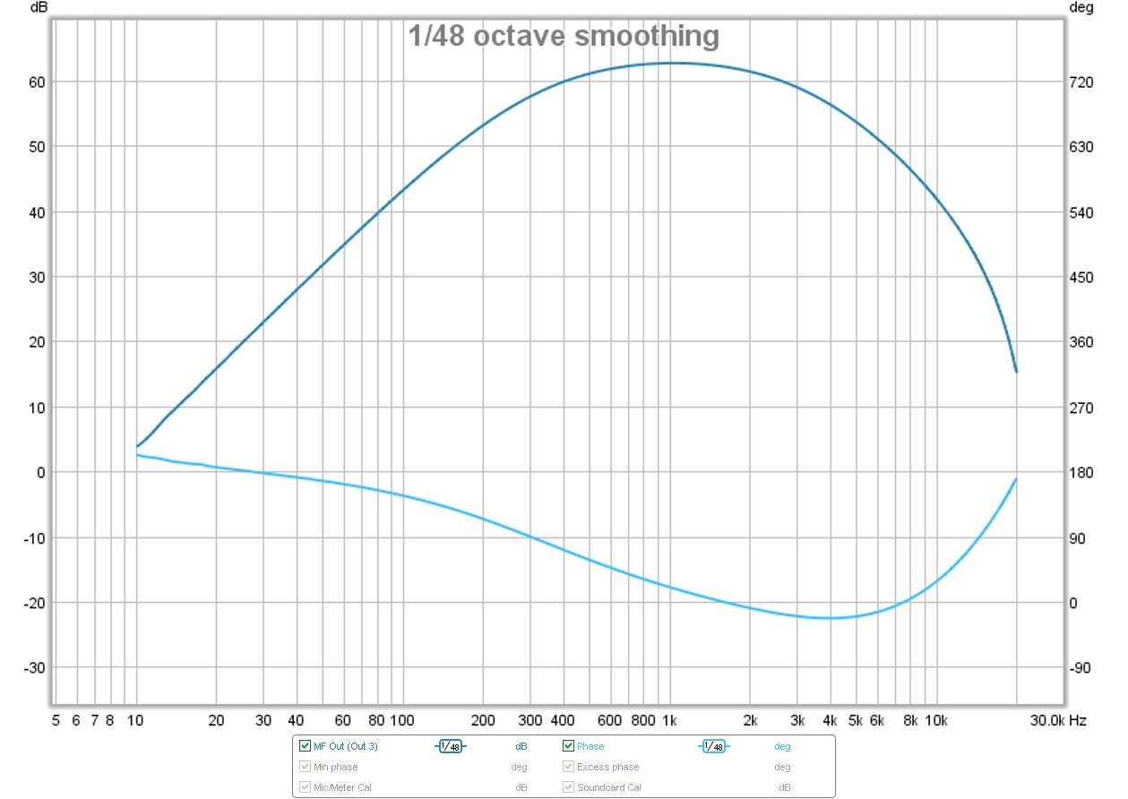

Thank you for confirming the acoustical effect of phase change.
Regarding digital filters, if I read you correct, you say that they do not produce phase changes.
Here is the measured freq (upper trace) and phase response (lower trace) from the output of a FIR digital bandpass filter (-3db at 3300Hz (LP) and 320Hz (HP), both LR 12db/oct ).
As you see, phase does change with these digital filters.
Perhaps it is only IIR filters that do not change the signal phase as you say.

George, there is two types of digital filters. The ones i was reffering too is called 'linear-phase'.As you see, phase does change with these digital filters
I googled for you and found this: Linear Phase vs. Minimum Phase EQ
I would had talk about group delay, btw.
