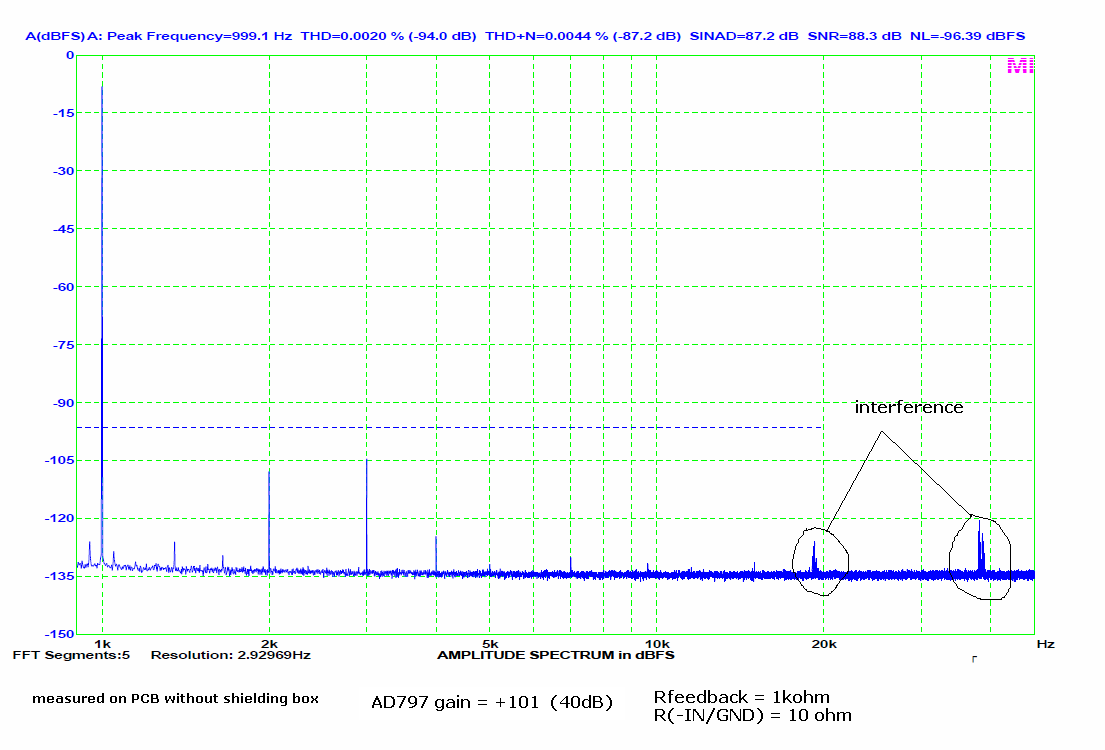

For the reason of quarrels here, I have decided to make a measurement of the AD797.
The test circuit has non-inverting gain +101, i.e. about 40dB. Feedback resistor is 1k, -IN to ground resistor is 10 ohm. Decoupling caps 100nF//4.7uF. The test circuit is built on double-sided PCB with ground plane, but no shielding box is used. FFT measurement attached. We can see no support to fairy tales that the AD797 is unable to drive its feedback network. And no significant 7th can be seen, once again the gain is 40dB. We can only see some interference above 18kHz, for the reason the test circuit is unshielded and PC and PC screen run near the circuit.
P.S.: measured at about 1Vrms.

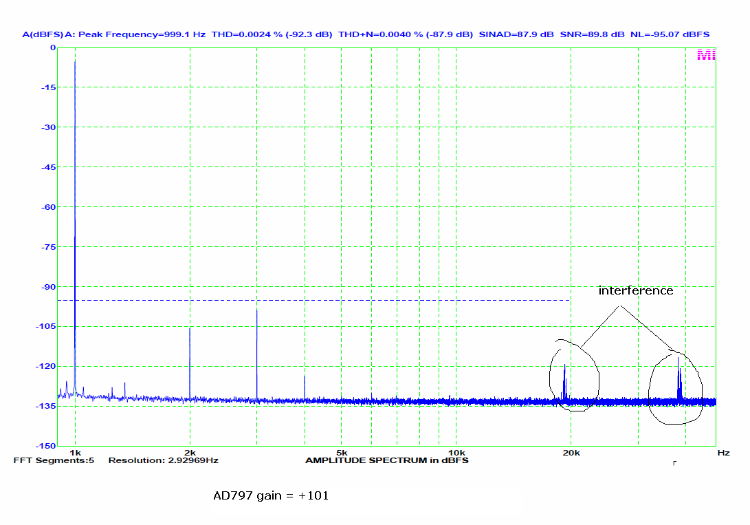

One more, again 40dB gain, artifacts below -125dB are measurement artifacts rather than opamp's, same for previous measurement.
Aha! I can actually see the 7th! You failed miserably

Pavel's measurement results are also inconsistent, if setup stayed the same.

Pavel, I must be missing something obvious- what's the difference in the test for the two spectra?
The small difference is only in about 4dB of output amplitude. But it affects level of high order harmonics near -130dB, which is a measurement fault, not opamp's.

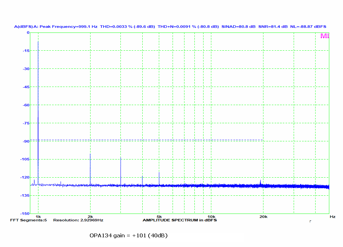

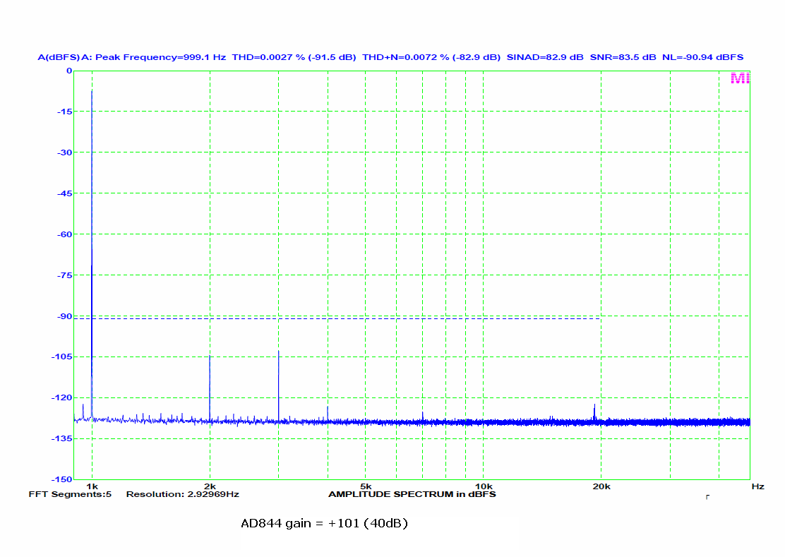

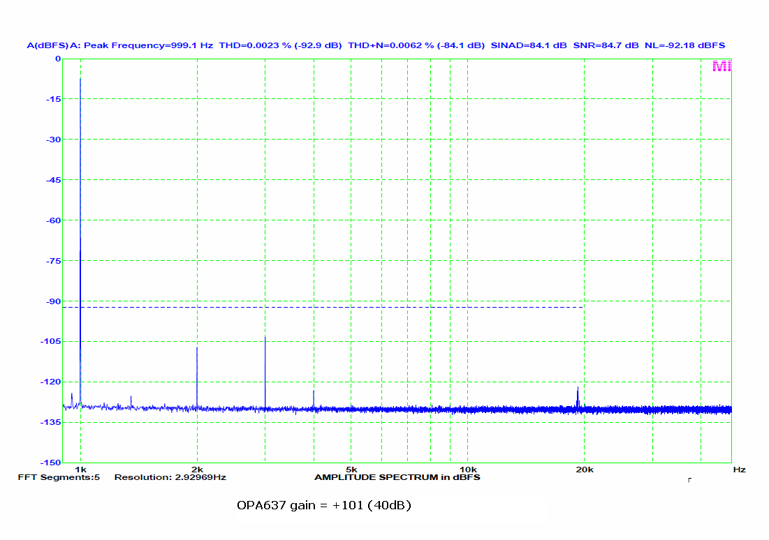

I can later measure more opamps like OPA134 etc. in the same setup, i.e. with gain +101.

Measured with SB X-Fi HD, USB soundcard. THD 0.002% is at the limit of the card.

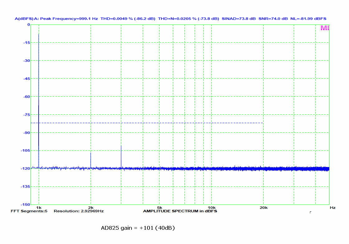

AD825 vs. AD797
This is the result of John's favorite AD825, compared to AD797. We can see higher noise (and distortion) with the AD825, but, as expected, much better immunity against interferences. But, it might be burried in noise for the AD825.
