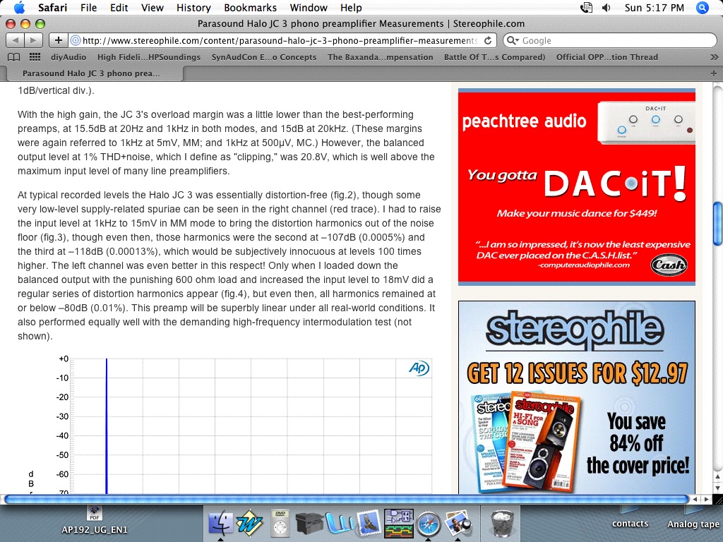

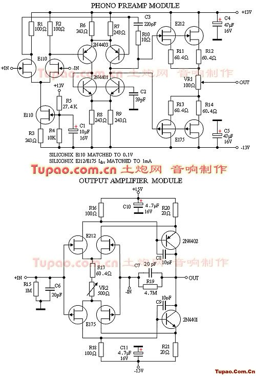

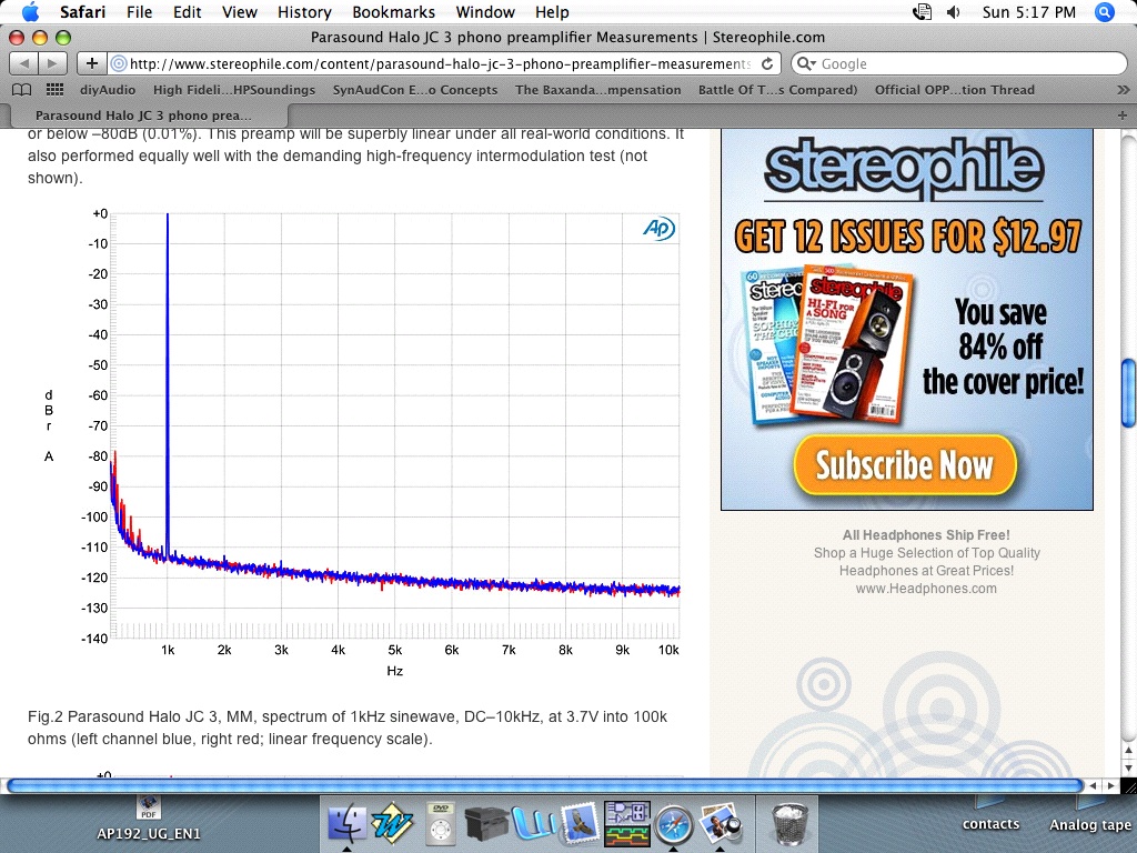

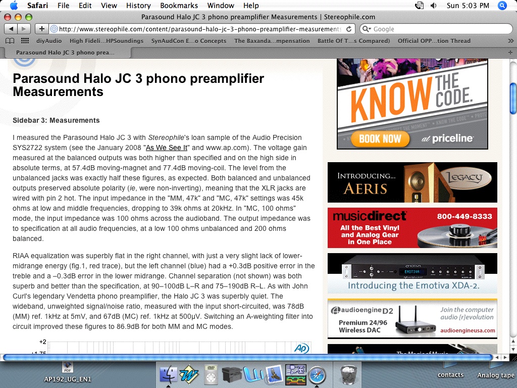

No, PMA, but I like the open-loop bandwidth and the subjective sound quality, and it uses a jfet input, which is the best that I can get from IC's.
JC, I'm not sure you are competent to do even simple designs with OPAs.
  • In JC2 Mk1, you use an excellent OPA (AD797) in an application which is completely unsuited to it (MM & MC preamp).
  • Your naive circuit introduces more than 10dB extra noise.
  • You ignore the datasheet recommendations on decoupling, guaranteeing the distortion is nowhere near its potential and the device probably unstable.
  • When the product is rightly criticised by the reviewers, you blame the OPA when the faults are due to your poor design & choices.
  • It is likely you didn't pick up these faults cos you were unable or unwilling to do even do the most basic measurements on the final product.
Before you use this example to demonise ICs, perhaps you should learn how to use them properly .. maybe even read the datasheets.
