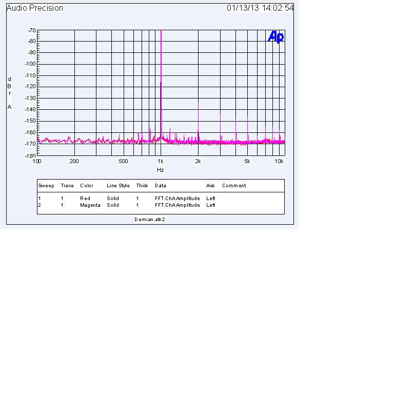

You are a grrfter nerzzog frakidle! Attached is a picture of the test setup and the FFT with the wires close a shown and then pulled back. The third harmonic is identical and extremely low. That would be from resistor distortion not quite being the same. There is a clear spike on the second harmonic with the wires close. It is greater than the thermal distortion.
As this took me 4 hours I am not inclined to do much more.
But the peanut gallery as usual is arrogant and wrong.

The peanut gallery is neither arrogant nor wrong. They are peers. This is a peer review.
I expect this effect to be more prominent as the resistance goes down. There is also no need to really match resistors unless there it is a consequence of the AP limits.
