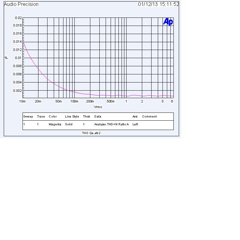

I have had a chance to think about the last set of measurements and the Scott,
Don't pull the rope! It is not a snake or a tree or even a wall. Don't pull the rope. As usual I think we both have quite different perspectives on the National IC test results. When I presented what I thought was a simple circuit to write the equation virtually no one could do it. So below is attached the schematic of how I perceive their test setup. You are welcome to try the circuit equations or to model it. I suspect my back of envelope calculations are certainly within an order of magnitude or much closer than the factor of 100 you feel is right. (I can do the equations for a "Noise Amplifier" circuit as shown. The basic issues are not what is the noise gain (I think we agree it is 100) but what is the signal gain and input impedance. I have set the input source to model the AP System 2. I think this will help clear the air about the differences we get, (I think we are starting with different assumptions.)
The signal gain is one and since the 10 Ohm resistor is bootstrapped by the Aol of the op-amp (divided by the feedback factor), the input resistance is very large, any bench generator has no trouble driving this +-10V. ALL errors refered to the op-amp input noise, CMRR, distortion, etc. have a gain of 101 to the output. Do you really not see that? Simply consider a nearly ideal op-amp put 10V on the + input the op-amp forces the - input and the output to 10V by feedback i.e. there is no current in either resistor, the circuit acts like a gain of 1 follower, and the input resistance is very large. If need be say the op-amp has an Aol of 10^6 so 10uV appears across the 10 Ohm this is all the generator needs to supply i.e. the input looks like 1Meg Ohm.
It would take 5 min to drop this into a plug board and see what this circuit does, we have used it for 40yr. The 10 Ohm and 1k Ohm have no effect on the noise or distortion (except at the third or fouth decimal place). If you want take an op-amp that is only -90dB thirds (so we can eliminate subtleties) you will see -50dB thirds at the output. jcx is right the distortion is not separable from common mode effects limiting its usefulness.

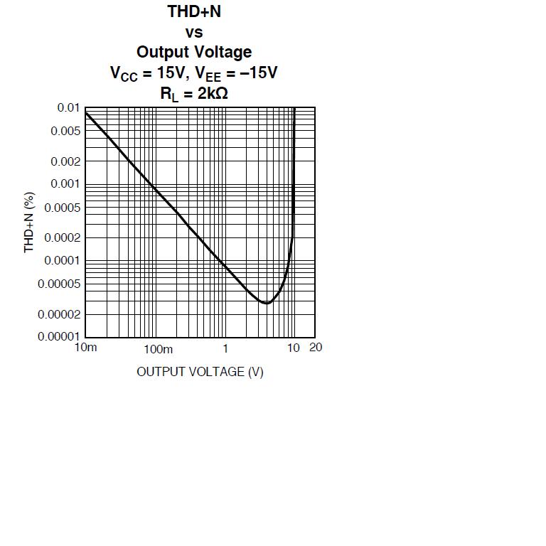

Similarly as in Scott's link (Ed's image). 80dB is a noise gain and 0dB (= gain +1) is a signal gain. Try OP177 datasheet, Figure 26, e.g.
Careful PMA this is the inverting version of distortion amplification, it does not rely on synthetic input resistance. The non-inverting version is related to gyrators, SRPP, etc. and I don't think think yet that Ed see's that the test circuit is no load on the generator i.e. the generator impedance does not matter at all and to the first order there is no signal current in either resistor.

Scott,
I don't think you got my reference to the parable of the blind men and the elephant. Each looked at parts and thought they had the whole.
Making standard measurements of the AP is mostly autopilot. If you don't pay attention to the details you get very pretty graphs of nonsense.
Attached is a THD curve that shows the noise limit and the maximum voltage out of the unit. (It gave me an error message when I tried higher source voltages.)
The second attachment is the best curve of the LM4562 as there is a gain of about 100 be sure to reduce the label values.
I showed you the current source version of the test circuit as shown in the data sheet. Now from prior questions it seems almost no one here can even write the loop equations, which I thought were obvious from inspection.
Trying to get the same view of the Elephant how do you read the limit of the AP trying to display what is shown?

PS I see I forgot to do log on the voltage so the graphs don't look the same!
