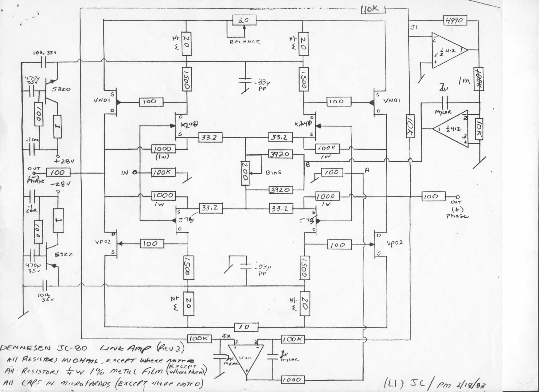

Hi Scott,
am I wrong or the VN and VP output jfets are exchanged ?!
eD
John should comment, it's just a scan of what he sent me 25yrs. ago.
As promised with JC's permission this is the JC-80 line stage. John you may want to comment on the crossed out/unreadable values.
There are also some bugs in the schematic (mostly missing wire junctions and a few parts values) but, as you said, looks good for the time.
It does?
I've worked on old Sansui, Marantz and Sony (and other) pre/control amplifiers older than that that were lightyears ahead in terms of sophistication.
Everyone, this is a working schematic made by Peter Madnick, formerly president of the company, and he made the oversight. However, that is an example of something that we often overlook or change on our own personal working schematics, as we note this slight mistake. This schematic was never made for publication. It will have a few errors, as it was not checked and re-checked by 3'rd parties for errors.
For example, in 1967, when interviewing for my job at AMPEX, I was asked to look at a schematic of a line driver/amp and explain it. The first thing that I noted is that the bias diodes were upside down and the amp would self destruct on turn-on. This was noted by my interviewer, but I don't think that was the test. It was easy for me to see it, because I was NOT intimately familiar with that particular design. This is what schematic checking is all about.
Complexity does not equal sophistication.
