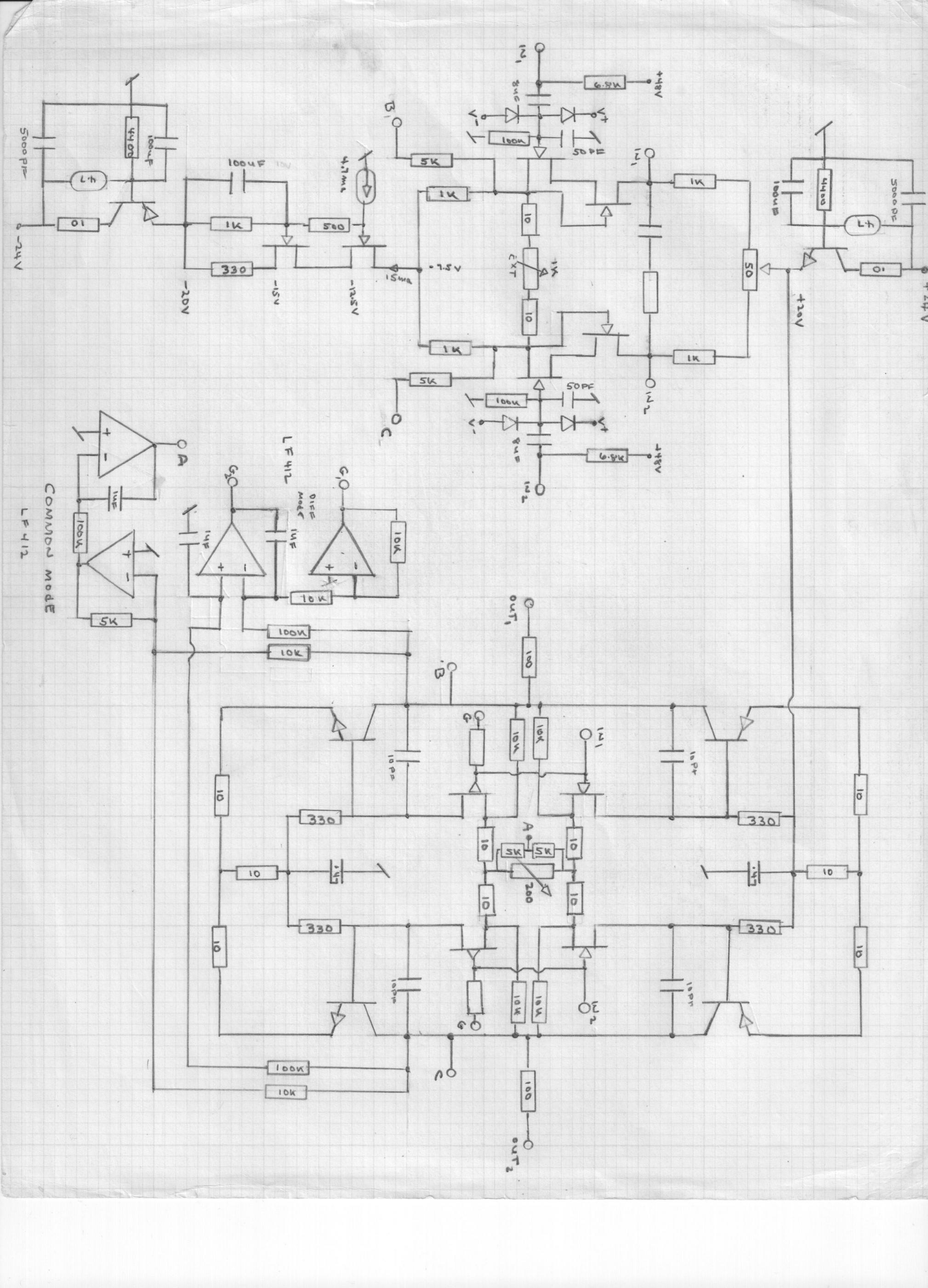

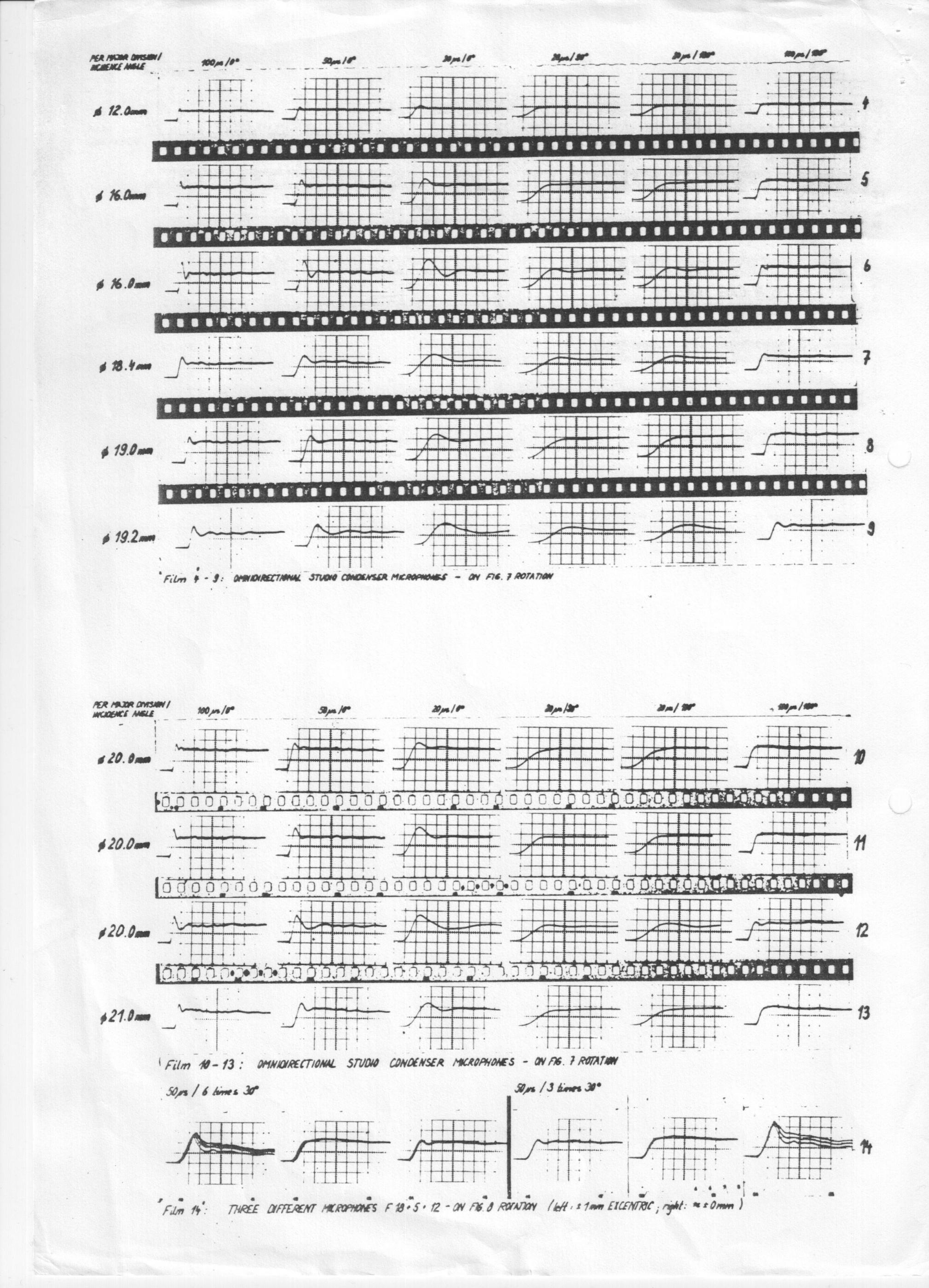

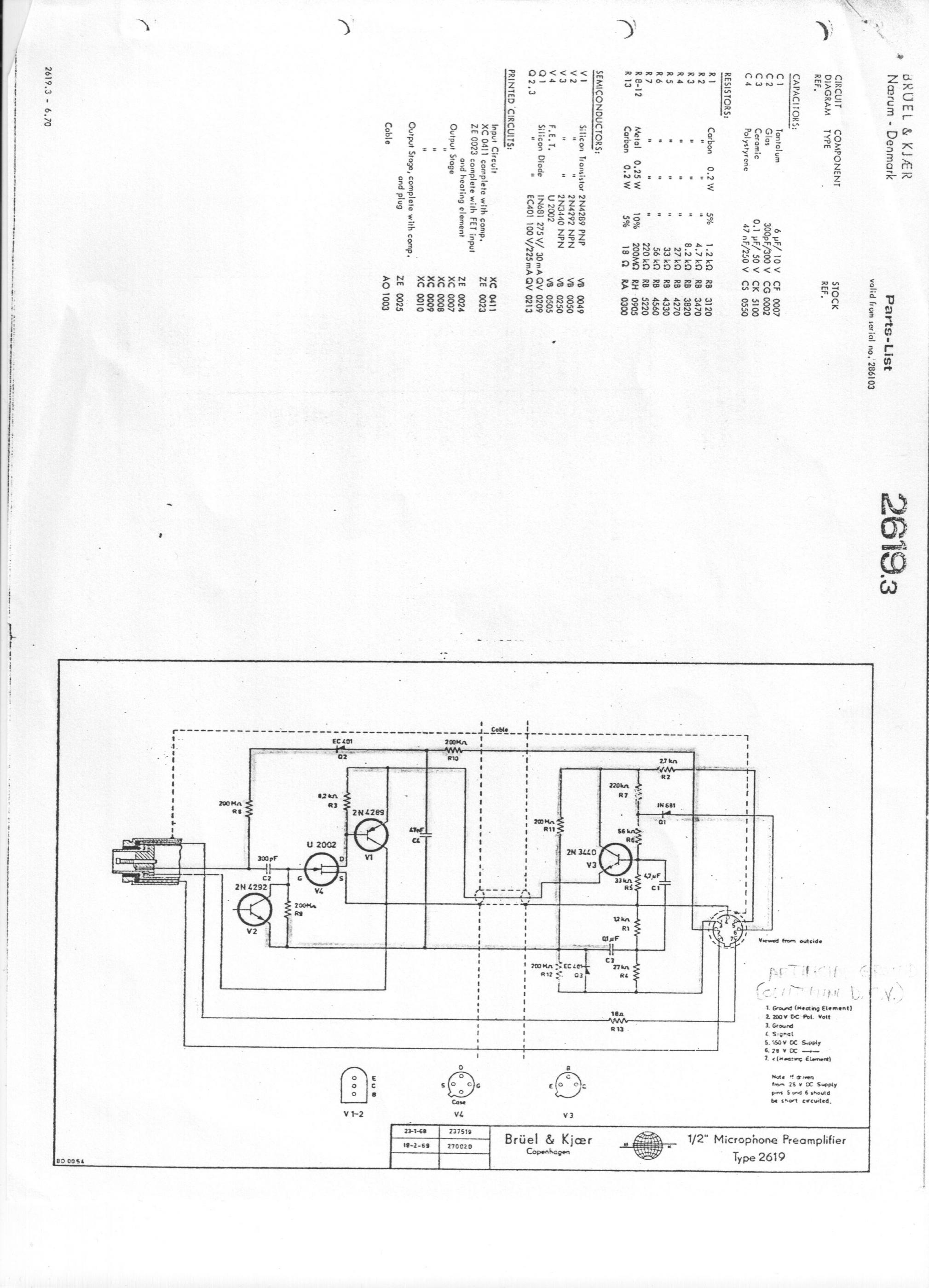

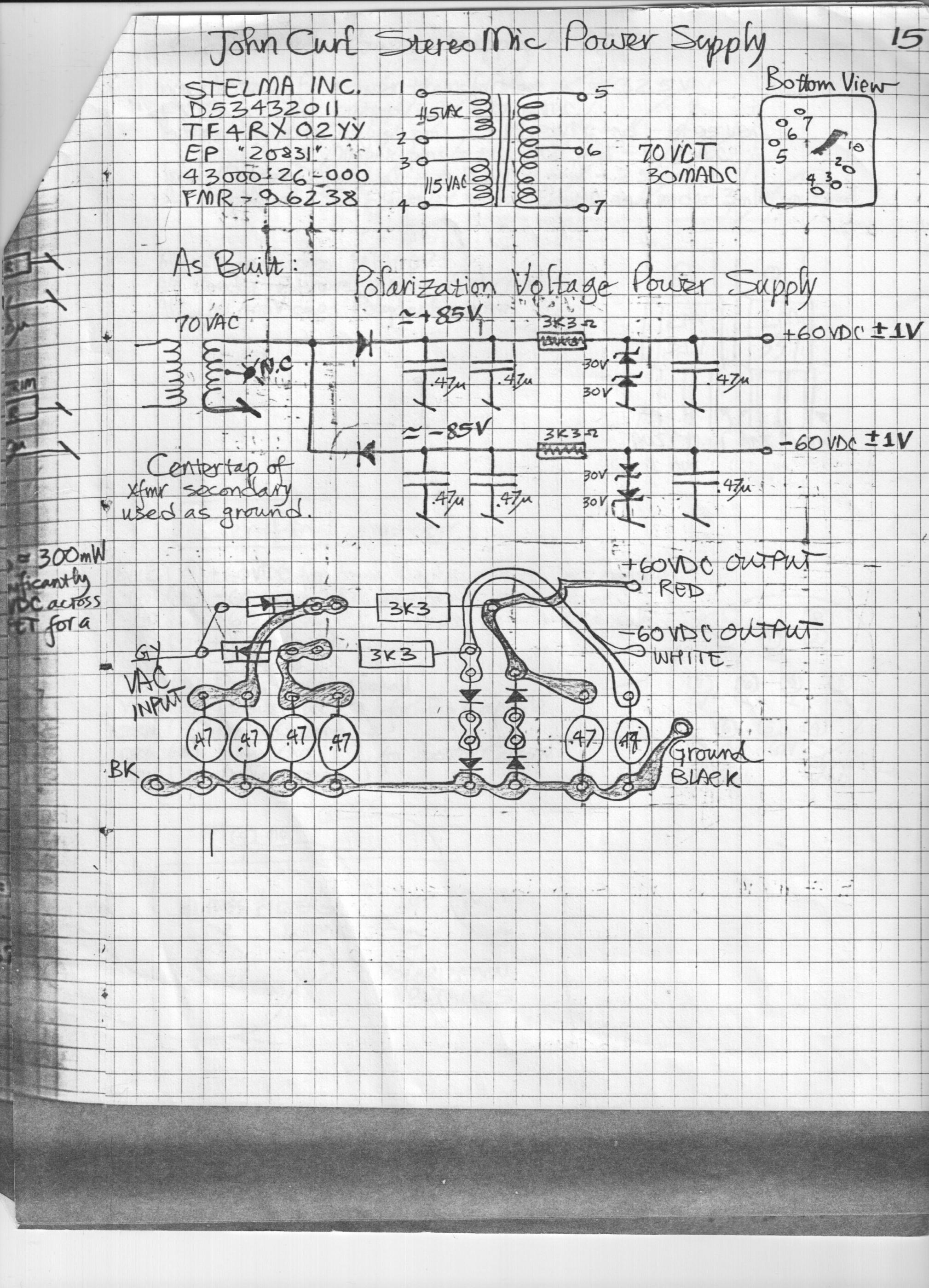

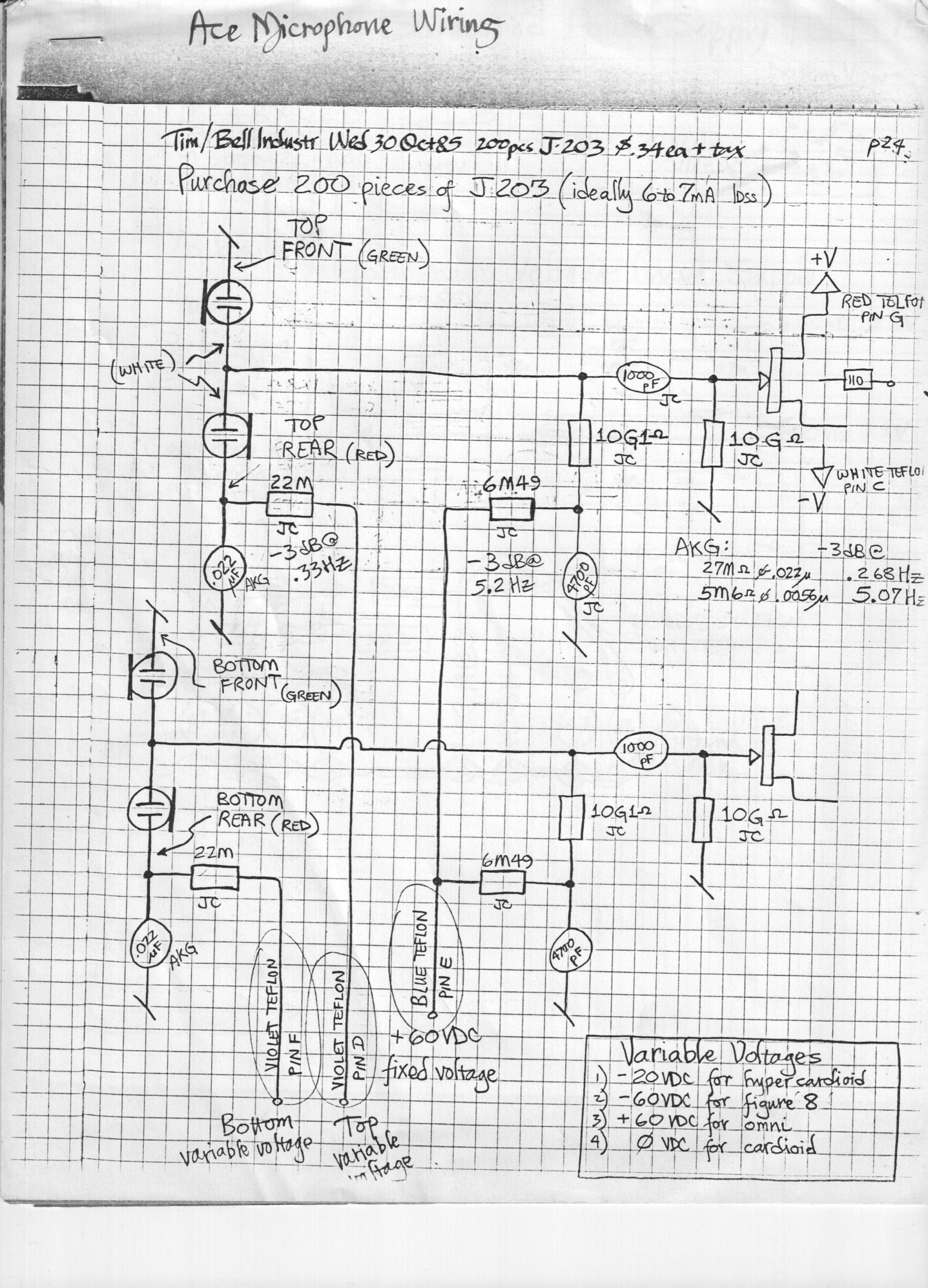

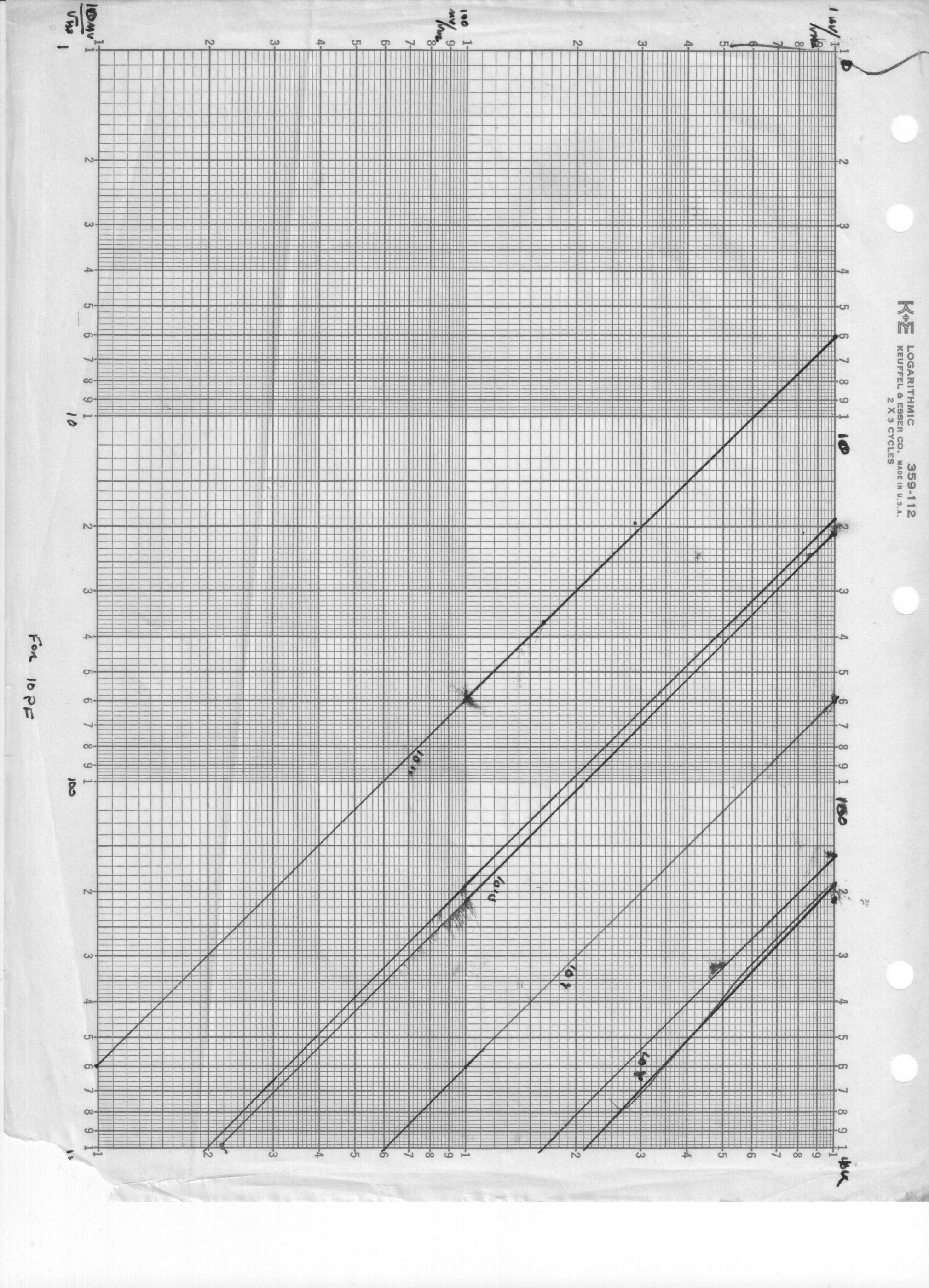

OK, PMA Here is a little that I just got from my mike files. I have not found everything, but this should be a start.
Note that the microphone input RESISTORS of the B&K 2619 mike preamp are 200 meg ohms. THIS IS IMPORTANT.
NOTE the 1966 article by Mead Killion for the AES showing 1 G input resistors at mike input. Let's give credit where it is due!

PMA, in truth, I am not here to GIVE you all my design knowledge, and you should not expect it, any more than I expect it from you. I appreciate what you have contributed here, however. You should feel the same about my contribution, and I am sorry that you don't. It is difficult to share with those who would potentially compete with me in the audio marketplace, you should know that. I think that it is enough that I care enough to contribute here and try to keep everyone learning something new.
