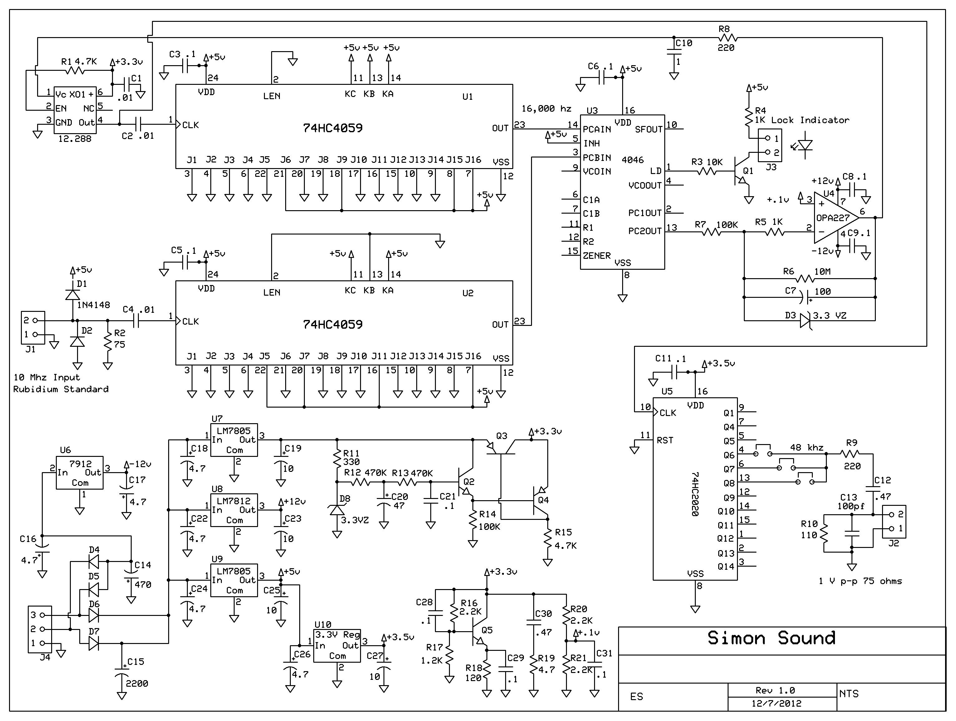

4059s have a Schmidt trigger on the clock input and are expecting capacitor coupling for inputs other than matching logic. The 4066 doesn't.
In my opinion, its too late if your depending on a Schmidt trigger.
