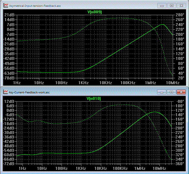

There is a very simple method to get an idea about how far we are from perfection in closed loop amplifiers. It is to look the bandwidth inside the loop, at the entrance of the second stage. it is flat up to...around 1Khz on the fastest amps (> 1Mhz)!!!!
Then the level increase by 6db/oct.
Those two curves are for the same amp, first in voltage feed-back configuration second in current feed-back. Notice the difference on the corner frequency.

The keyword is the slewrate inside the loop. IE the ability of the amp to respond to fast changes of signals.
All those *evil* components inside makes various errors. How fast will be this error corrected by the feedback ?
