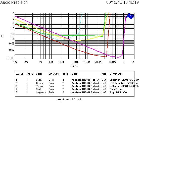

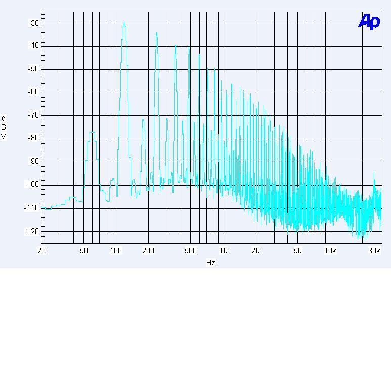

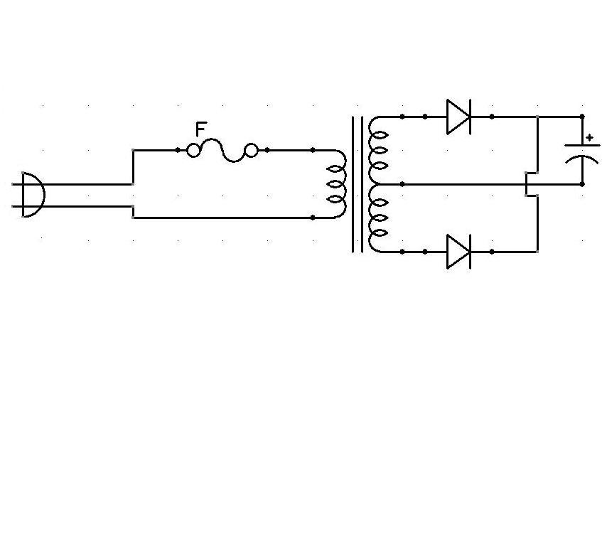

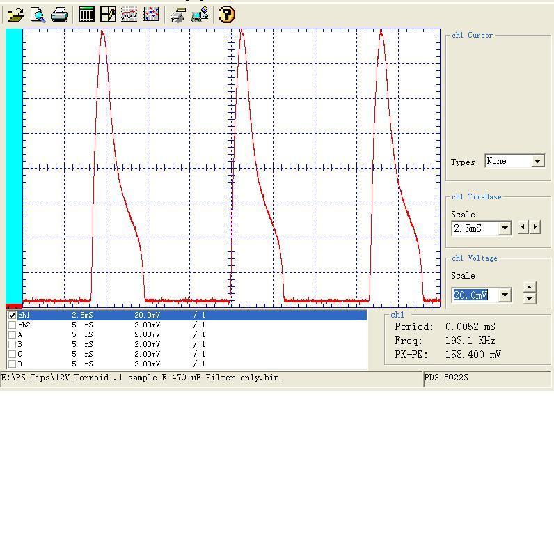

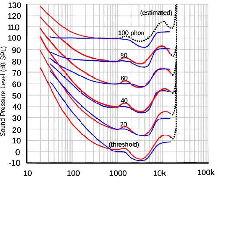

Here are some slides from a talk I gave this week.
The first one is a simple full wave power supply. The transformer was 24VCT 12A the rectifiers 1N4007 the capacitor 470 uF and a load resistor of 50 ohms.
The second is the current pulse on the transformer secondary as monitored across a .1 ohm resistor inserted in the center tap lead.
The third is the noise spectrum.
The fourth is the Fletcher Munson curves that can be used to see that the noise at 3-5k is perceived as louder than the 60 hz. fundamental
The fifth is a plot of input voltage vs distortion for a bunch of small amplifiers. NOTE that some of the amplifiers do not have the distortion continue to fall until clipping begins. These are noise limited amplifiers.
So what was the point of these slides?
