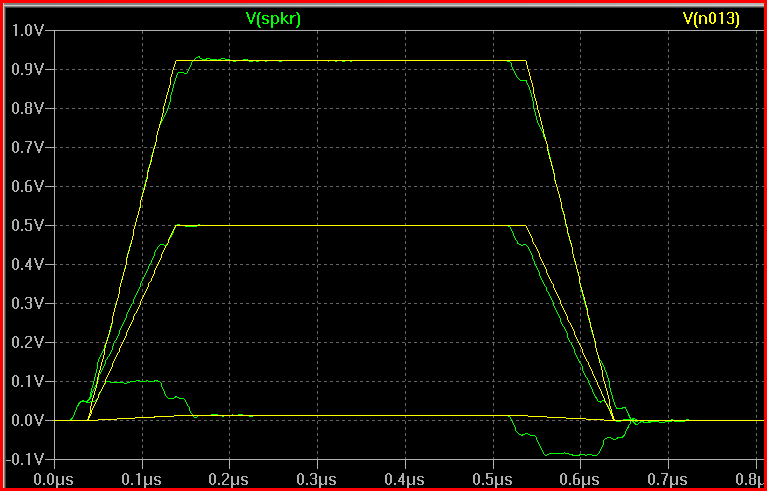

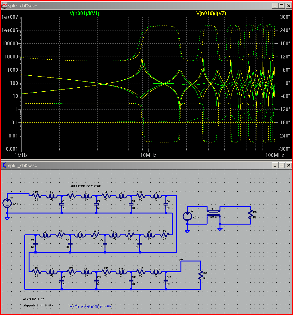

again with the lumped TL sim - added 84 Ohm spice lossless tline element, trimmed the delay param to 28 ns for OK match with my previous sim 12' Pass 18 awg zip cord speaker cable model
stepped termination R = 1, 84 and 1k Ohm - plotted Vsoucre V/I = impedance at driving end
sure looks like the lumped model shows some transmission line characteristics - to well over 10 MHz
the lumped model pulse waveform has some major features differing with short, open end, but the terminated rise time is delayed by the the same 28 ns that makes the Z plot match (pulse start delayed 10ns)
won't show multimode behavior - but do we need it for loudspeaker cable
I must say I'm not at all sure about where the 28 ns delay number comes from - I would have guessed 12' of not exotic Z cable delay ~18 ns I suppose I could look for the equations...

Two transmission lines with the same impedance, attenuation and time delay will behave the same, whatever their physical length. Differences will only emerge at high frequencies where the plain TEM mode is no longer dominant.
A lumped approximation to a line will become a better approximation at lower frequencies, or at a fixed frequency with more lumped sections. Putting a square wave through a lumped line may show differences if the rise time is short enough to probe the frequency region where the lumped approximation is no longer good.
