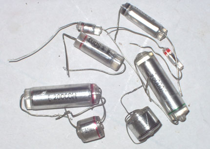

Mr. Marsh, you are right that it is the construction and mounting of most polystyrenes that give their microphonic behaviour.The film itself isnt microphonic. However, how it is made will determine if it will be microphonic .... As far as harmonic distortion is concerned the npo et al are very good. Ditto the ps type.
I feel confident to recommend Rel Cap out of so calif for the most reliable and well made parts - they are a specialty cap maker for communications industry and military... where high reliability and long operating life is foremost.
But polystyrenes I've used in the past, even in packages that allow tight mounting to the PCB, show this.
The polystyrenes that the unwashed masses and Golden Pinnae brigade normally worship, are unfortunately prone to this fault.
From this, I gather that Rel Caps, if glued to your "hand carved from solid teflon by virgins" PCB, with Unobtainium epoxy (without nasty dielectric factors), will be as good as NPO/COG ceramics.
I'd still like to see some evidence that polystyrenes are better practical caps than NPO/COG ceramics.
We'll ignore trivial issues like soldering and reliability.

John -- The dual ground plane I suggested to you all those many years ago, I still use. However, stray c is higher and important in specialized high Z circuits (like mic preamps). Never-the-less, I use it to great satisfaction when under distributed power traces to keep the Pwr Supply Z low and stable at high freqs. making the traces wide as possible and under the that trace put the pwr supply ground trace of same width. The signal ground plane should never cross the pwr ground planes. generally, if you make the pcb signal and power traces the same way you draw the schematic, all is well. I also put all signal traces on the TOP side of the pcb; Easier to repair, trouble-shoot and modify without tearing the thing apart. -RNM
Most caps used in speaker cross-overs are metalized film. They do not short when over-voltaged. They just burn-off met film area which over time reduces the c value. Not cool in cross-over filters. They are best used in low level signal apps.
The current capability of the ultra thin met cap is not the best for high current apps. You will get modulated esr due to temp rise. Often the C value is so large that only met caps are practical... unfortunately, the largest values are used where the current is highest -- low freq Xover- bass. I would rather parallel film and foils to get the total value required. The tweeter can usually be metalized (low current) without any side effects.
The film and foil is the more suitable choice for high current apps... like speakers and power supplies. but just be sure they are voltage rated far higher than any amp likely to be used on the speakers because they do short when over voltage causes film breakdown. But they will perform the best and stay like new sound forever in either PS or PP if made well... such as RELCAP. -Thx RNM

RELCAP is a speciality cap mfr -- makes for military and communications industries, test equipment makers etal which have to have a long life in mission critical apps and will be in the field for dozens of years without failure.
The additional requirement of higher temp soldering practices make ps caps unsuitable for many uses today. But for High End audio, use them if you can find them. yes, not all caps are created equally... you get what you pay for in that component....except in most audiophile caps sold to the unknowing.
What does practical mean? Its different for different people... but here -about High-End- I dont care about practical... just informing. -Thx RNM
Rel RT polystyrene caps are one of the best audio caps in the world. I use them in in the CTC Blowtorch, Vendetta Research, and Parasound products as a first preference. Ayre uses them too! They are DAMPED, and do not ring.
I found the tin foil is best and second the aluminum foil. The tin has a slightly higher esr but that helps damp transient signals. In fact, if anyone cares to know -- optimum series R for critical damping occures with a .2-.3 Ohm series resistor (.22 or .27 works fine). This value is subtracted from any other series r -- pcb/wire trace, etc. [I had a patent on this added R internally but never used it]. I also like to keep the number of dissimilar metals in the cap's joint/junction to a minimum... thus tin solder to tin foil to tin/copper leads.
There are a lot of fine points in making a superiour cap for the Highest-End products. Thx - RNM
... For caps, there is only one mfr left that makes a superiour ps dielectric for the cap industry - they are in China. ...
BASF (Germany) still makes "Styroflex".
Styroflex® Thermoplastic Elastomer - BASF Corporation Plastics Portal
(In Europe polystyrene capacitors are quite often called "Styroflex Capacitors".) And there are still other manufacturers of polystyrene caps, you even can get them at Mouser.
Different material. Styroflex is a rubbery copolymer of styrene and an olefin, similar to Kraton or Septon. Very good for use as the rubbery part of toothbrush handles. Lousy cap material.
The best plastic resin for audio caps would be COC (or COP), but no-one is doing that yet.

Yes. 100% sure. Your links confirm it- it's an SBC elastomer. That's the technical name for "thermoplastic rubber."
