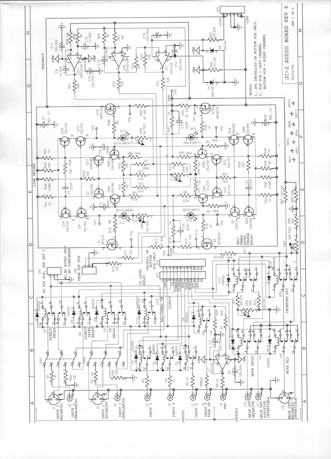

One topic that you bring up is partition of the various functions and channels. This is VERY IMPORTANT and not as easy as many engineers think.
My first experience was when I visited a competitor who made a much cheaper preamp than the JC-2. Playing a familiar record, and the same speakers I was then using, this competitor's preamp put CAT STEVENS right between the two speakers. MY set-up could NOT do that!. So, what is the problem? I found it to be asymmetrical X-talk between the left and the right channels. Now, was I alone in finding this?
No, at a hi fi show, I heard a glorious violin sound coming from one of the rooms. I said to myself, that is a REAL violin, you can't fool me, I married a violinist!
Well, I was fooled, by my own JC-2 preamp and Dick Sequerra's ribbon tweeters. However, taking to Dick about the JC-2, he independently stated that it was the best MONO preamp available, denoting that it had 'imaging' problems. Trust me, the JC-80 was deliberately designed not to have this problem, and the CTC Blowtorch, as well.
SO, partitioning is GOOD! Separation by air is good too. It must be remembered that most SPECS. are derived from IDEAL conditions, Zero drive impedance, input pot all the way down, etc. NOT real world working conditions.

That's the spirit, at least folks can take a stab at it. It's clear all the wining about IC's and op-amps is pointless, people want to try your discrete circuits. Do we need to repost the schematic, maybe a pdf hosted somewhere so we have something to talk around?

Is anyone ready for a real schematic? This is the Para JC-2. Want to build it? Be my guest:
