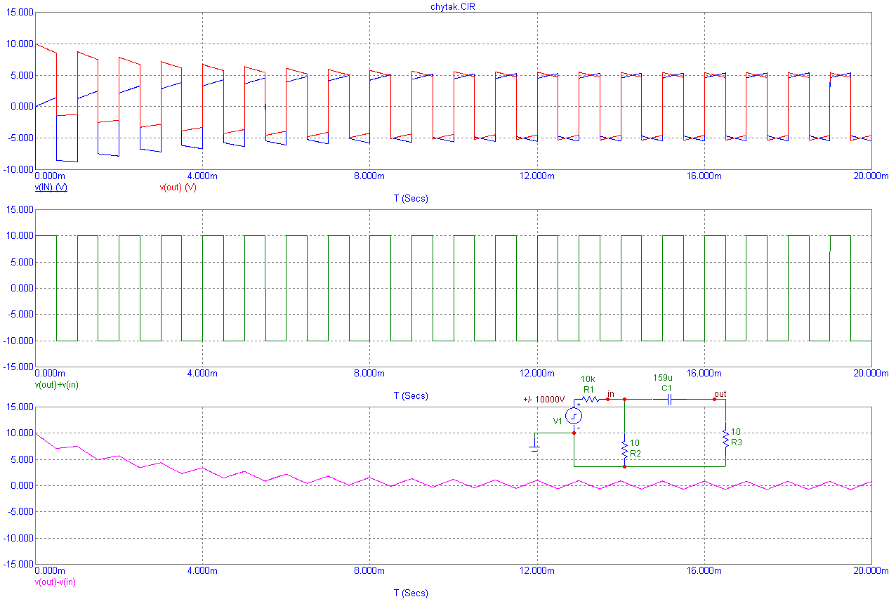

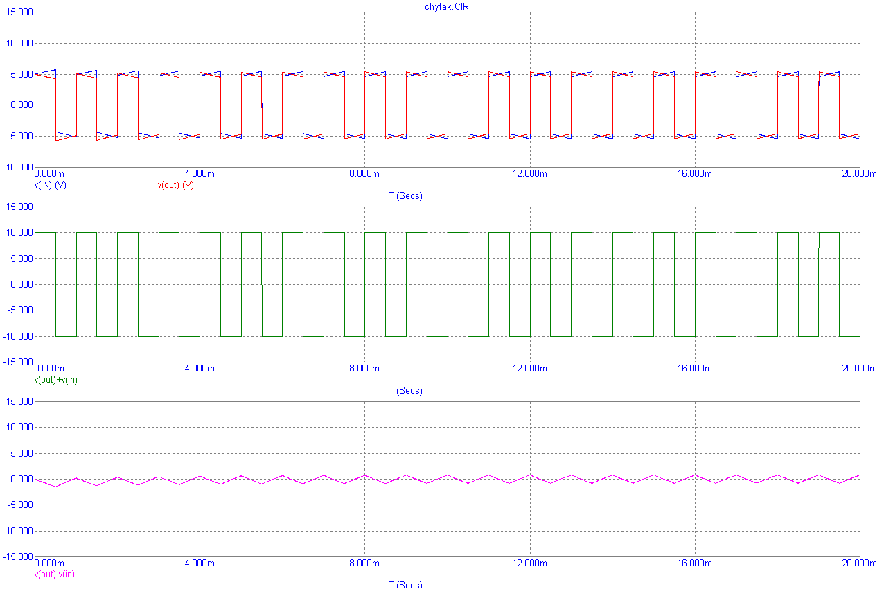

Oh no, I take into account the initial condition for T < 0 Igen = 0
for T > 0 Igen = +/- 1A with T = 1ms, 50% duty cycle
That's fine, but it is not made clear. And most simulators btw assume the initial value as the value at T < 0 (i.e., -1A) and having been on thus "forever". To do something else requires more work setting up the sim. However, with sinusoid,s the generator's T < 0 value is 0.
I'm sure the instructor would have put this in context, and the students knew what the convention was. My point is that it is not specified in the stated problem.
Actually the prior tests would have been with a switch shown and the questions asked about the transient analysis. This is a steady state problem. Of course if a student was confused they would have raised their hand and asked the question.
Now a few shy folks have PM'd me their solutions. So if you are shy feel free except of course for the peanut gallery guys.
More than words - the waveforms.
The choice of the approximation to a current source (agreeable to me) is eerily reminiscent to the testing and characterization of IV converters in other threads and recent articles Unfortunately in those cases (not this one) the use of that high of generator resistance obscures mechanisms of distortion that will be present when using real DACs, including code-dependent modulations of said resistance, and distortion due to nonconstant IV converter input impedance.
Laplace transform and integral?
Way too much work. The three digit accuracy answers can be done with a simple calculator and some basic techniques.
