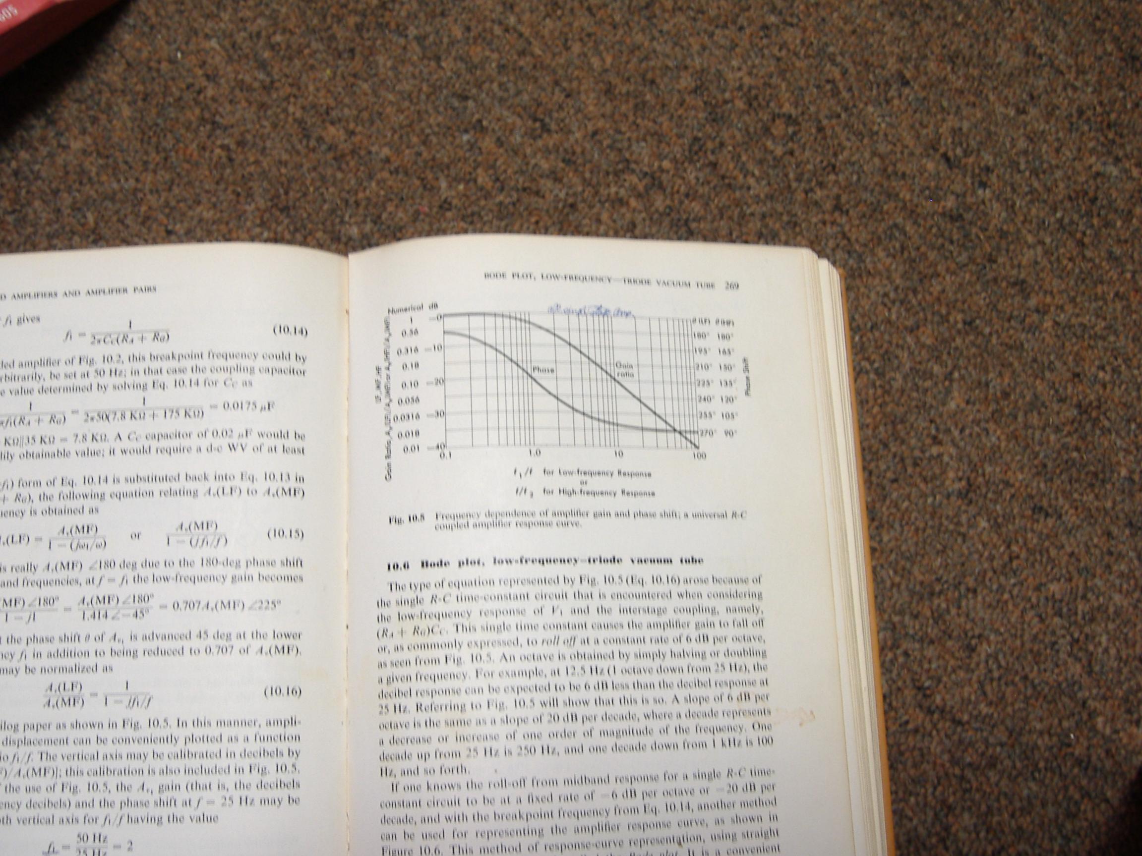

Here is another gain vs phase shift, a universal R-C coupled amplifier response curve. The top is gain and the bottom is phase shift.
Hope this helps.

Pay attention, Scott! You have the chance to get educated! Don't miss the chance! R-C coupled curve must go backward!
PS: I knew that Positron will come back, skip the discussion with explanations, then start over and over. It is not phase shift. It is indeed time delay in 2 pages of explanations that leads to positive feedback and stable oscillations.

Ah, first year college textbook, "Semiconductor and Tube Electronics, an Introduction".

The graph on the page that you use to teach Scott shows integrating R-C network, while your remark is about R-C coupling that is differentiating network. What it has to do with "propagation time" nobody knows.

I will try. When you read the answers and try to digest information presented in them it can be viewed as a phase shift, i.e. you start learning immediately, but the process takes time, so your understanding is getting better and better. The same happens with integrating R-C networks: when you apply input signal voltage on the capacitor starts following the signal immediately. It is the case of phase shift between input and output signals. You can call it "time delay", but it is incorrect: how do you go to measure the time? On which level of voltage on the capacitor you decide that it is enough to wait?
However, if you add some comparator after the R-C network you can call it "time delay" machine, because voltage on output will appear only after some certain time that depends on the level of input signal, time constant of the R-C network, and threshold level of your output device. And if you apply negative feedback to such device you will inevitably get stable oscillations.
Do you see the difference? One R-C device is not enough to cause oscillations because it shifts phase 90 degrees only on infinite frequency. The lower is the frequency, the less is phase shift. But if to add some threshold device after the R-C network you can no longer talk about phase shift, instead you are getting real time delay. And if amplification factor through negative feedback loop is slightly greater than 1 you will absolutely necessary get stable oscillations. Exactly what Demian said you from the beginning. And it does not oscillate because of presence of RC network and feedback! It oscillates because you skipped the information: the comparator reacts after voltage on the capacitor raises up to the certain level. From zero to this level the information was _skipped_.
The same, when you skip the information presented to you on the forum
turning the system with phase shift into the system with time delay. That also leads to stable oscillations. I hope you will understand it now, that will damp oscillations, but if you skip it it will go and go around in endless cycles...
