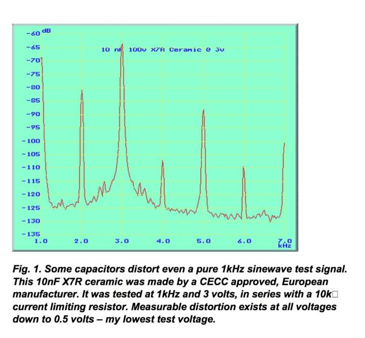

No! It depends on the signal voltage across the cap, and the extent to which any distortion generated there can find its way back into the signal path. Both of these issues depend critically on exactly where the cap is used in the circuit. I can't understand why so many people seem unable to grasp this basic truth: distortion depends on signal level, and generally the higher the distortion order the more it depends on signal level.

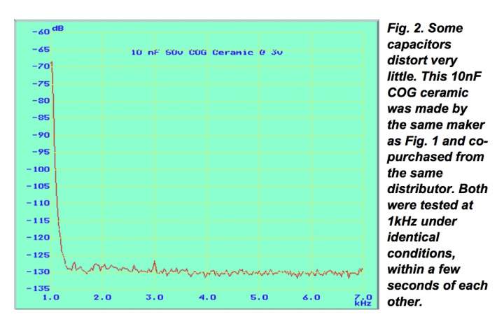

Signal-level distortion itself depends on the capacitor's distortion characteristic. Two ceramic caps of the relative same dielectric constant can have markedly different distortion characteristics. Compare the following two measurements from Bateman of two capacitors having the same or similar size, ESL/ESR, but a different dielectric material. The first is of an X7R ceramic, the second of a C0G ceramic:
Of course, that is obvious. You said
The type and level of distortion produced by a capacitor's dielectric does not depend on the application chosen for the given capacitor
which is not true. The level of distortion depends critically on the application.
To clarify still further: a particular capacitor may have a non-linear dielectric with a second-order (parabolic) response to applied voltage. Such a capacitor will generate 3rd-order distortion if run with an AC signal and no DC bias - the distortion will vary like the cube of the signal voltage. If it has a DC bias it will in addition generate 2nd-order distortion, proportional to the DC bias and the square of the signal voltage. So the basic dielectric response is a property of the capacitor, but the type and level of distortion will depend on the application.
I agree with the first part of your sentence and disagree with the second, if I'm reading it right. Yes, application influences type and level of distortion, but the type and level of distortion a given application produces will itself be influenced by the distortion properties of the dielectric.
In other words, dielectric distortion exists no matter the application. Thus for the same application, two capacitors otherwise identical or sufficiently similar in all other respects but their dielectric will produce different levels of distortion referable, therefore, only to the dielectric. Dielectric-induced distortion is an irreducible, non-dependent quality of the chemical makeup of the dielectric. In a given application, that dielectric will, yes, vary in its functioning or operation dependent on the application, but that functioning will carry and reproduce the distortion characteristic of the dielectric concerned.

No. Dielectric non-linearity exists no matter the application. The distortion produced by that non-linearity depends critically on the application, and the effect of that distortion also depend on the application. In the same way, amplifier non-linearity exists whatever the signal but distortion only occurs if the signal is big enough to invoke the non-linearity. I think you are confusing non-linearity with distortion. The former is the cause of the latter when combined with signal level.
