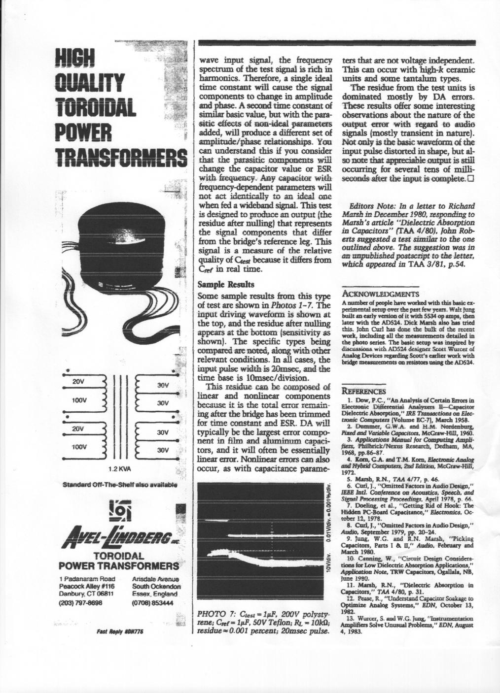

Here is the test set-up: This is the 'optimum' test found at the time, by Scott Wurcer, Walt Jung, and me, to 'bring out the error in the waveform caused by DA.
The key is to assess the audible importance of the errors, that is where we have some disagreement. As to FFT limits, the FFT is a mathematical process and its limitations are are easily quantified. They are often exploited to obfuscate the discussion at hand. Most folks that dwell on the limitations of the underlying mathematical processes are grasping at straws because they simply can not deal with having to understand what is going on.
Now some results. Note that Photo1 and Photo 6 are of the SAME electrolytic cap, just two different loads. P1 R=450 ohms, P6 R=50K ohms

It is important that -at the time - we had to listen more to get clues as to what we should measure. Sim programs were too crude at that time and would be too expensive - we didnt have cheap, powerful PC's at all. Listening tests indicated that my research showed that a characteristic called DA could produce sound that was closest to what was heard when poor DA caps were used. So, that led to further research and a test instrument I designed and showed on a scope waveform that DA had real audible consequences. Later, I gave an invited talk to describe the development of audible waveforms not indicated with tests using symetrical waveforms (sine waves). I showed how the extraneuos waveform was created on the black board. And, had done FFT on the extracted - unwanted - waveform from DA effect which showed primarily second harmonics (used a LeCroy scope with built-in FFT). Something I have never talked about since. But, note that sine waves will not show the problem. That talk was at WESCON in San Jose and was well recieved by the heavi-weights in the IC design and other researchers in the audience. I suggest more audio designers try listening and calibrating your ears as another tool. - Thx - Richard (Dick ) Marsh
I suggest an innocent misinterpretation of data from primitive tools in this case. A linear time invariant system that shows second harmonic distortion from a synthesized waveform but not sine waves is an extraordinary result. The traditional DA model has no distortion creating mechanisms. Capacitors with a voltage coefficient of capacitance are another matter, to be rigorous these effects must be separated. It is not fair to present results without taking the care to persure all avenues of well known effects.
In this case we were looking for the effects of DA that might be added by INTERSTAGE CAPACITORS. Now, what sort of value would that be? 1pf? Not at audio, 100pf? Maybe, from a condenser microphone, and over 100 Meg Ohm load. 1000pf, not very practical. 0.01uf possible, but again not likely. Guess what, we are just about out of range of the COG or NPO caps. 0.1uf? Here is a value that CAN be used for both coupling (hi Z), power supply bypassing, or EQ. And guess what? We measured a couple of those, and got results.
However, it was easiest and the most realistic to measure 1- 10uf or caps that could be representative for AC coupling between stages, or model the RC feedback combination so popular at the time, before servos were used as often, and by many amateurs today.
Now, why did we chose a 20ms pulse? We could do the same test with 100ms or 1ms pulses, AND we did, but IF we went too long in the pulse, it was difficult to see what was going on, because the OFF TIME was so long. You had to use a storage scope to do it right, and I did not have one, at the moment. What about faster pulses? It would work, AND you could also see the inductive component of the cap, but it did not give as much error as 20ms, and we were trying to show: REASONABLE WORST CASE
However, we did compare the SAME CAP at 450 ohms load and 50K, or a difference of about 100+, and we got an error difference of maybe 63, or so, and this shows that loading or increasing cap value, let us say 10uf to 1000uf would probably do the same thing, but it is not unmeasurable, and still about 100 times above the RESIDUAL of the test itself,with the same set-up, testing two nearly identical highest quality caps.
Here is the resolution of the test shown by measurement, about 0.001%
