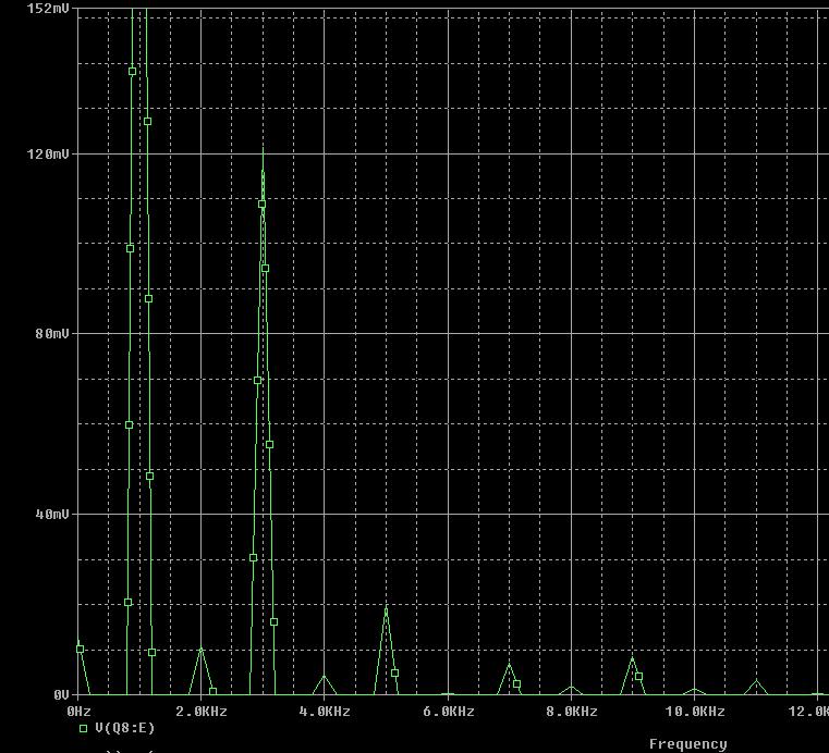

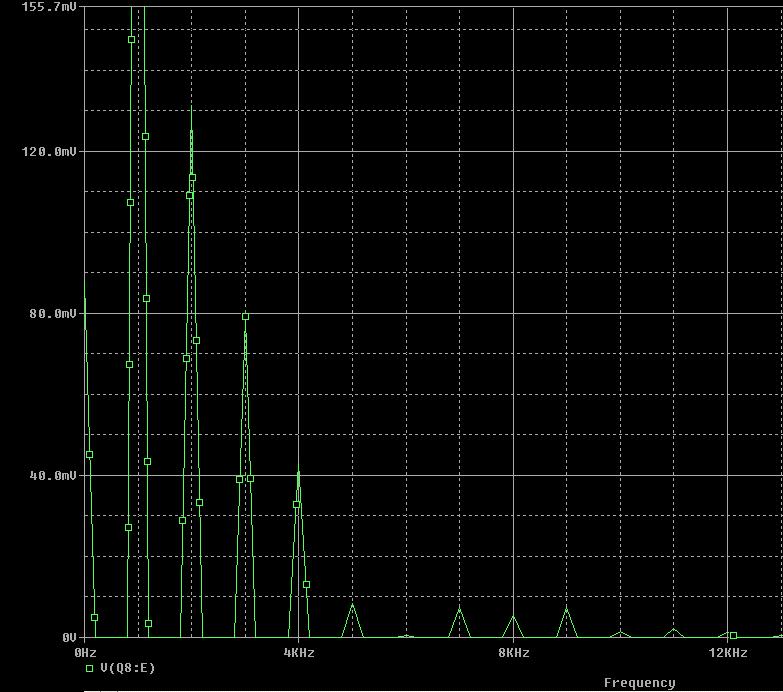

Before anything else, I am not sure why you think de-balancing the power supply would translate (e.g.) the crossover distortions from zero. To me, it's clipping which would be de-balanced rather than the crossover distortions.
Secondly, strictly about zero crossing distortions, I am having some trouble following your thinking on this. So, are you claiming that e.g. crossover distortions are less "damaging" (to what?) if they do not occur around zero?
Looking in the frequency domain there seem to be a contradiction here. The sum of harmonics of a signal with a dead zone crossover distortion (like in the extreme case of a P/N complementary stage with zero bias) has a minimum precisely when the dead zone is around zero. That's because the time domain signal is symmetrical and an odd function of time, therefore the signal would have mostly odd harmonics. If the dead zone is not around zero, then the function is no longer odd (or even) and the harmonics are both even and odd. It is easy to show that the sum of harmonics is now larger.
I'm attaching two pictures. The first is the spectrum of a sine voltage having a dead zone of about +/0.6V around zero. The second is the spectrum of exactly the same signal, shifted by +0.25V. Which signal has overall larger harmonics?
Now, strictly from a Fourier transform perspective, the only impact of adding/shifting a signal by a constant is a Dirac delta function at zero frequency, while the signal spectrum itself is the same. So even in the perfect world of mathematics, perfect shifting from a perfect zero crossing would not have any positive impact on the signal spectrum itself.
So I still wonder why you think de-balancing/shifting the power supplies is a good idea. Is this some empirical result, based on perception rather than signal analysis?
