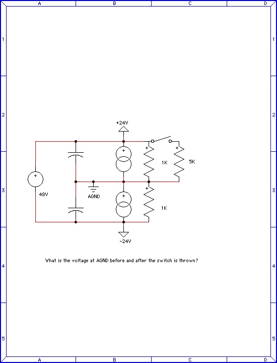

The LED can run between the + and - rails directly, (series 5K or 2 series 2k5 if you have doubts about Thevanin!)

Point AGND appears to be grounded, so the voltage there will be zero whatever position the switch is in.john curl said:Let's talk about 'balance'.
With the switch open the +24V and -24V points will be at the stated voltages, because of the 1K resistors which prevent the supply from being totally floating at DC. Close the switch and the voltages will shift - if my arithmetic is correct the '-24' will become -26.1818V and the '+24' will be 21.8181V.
If this shift disrupts the circuit (presumably modelled here by the 1k plus CCS) then that is the result of having a DC supply which is almost floating for DC purposes, yet grounded for AC. I assume there appeared to be a good reason for this unusual design.

If you need balance, why not insist on it by having suitable supply arrangements? It seems perverse to design a circuit which requires exactly balanced supply rails, then run it from a PSU which is guaranteed to provide unbalanced supply rails unless the circuit draws exactly balanced currents. I assume you felt there was a good reason to do it this way.
I think he mentioned not having ground attached to the xfmr as the reason.If you need balance, why not insist on it by having suitable supply arrangements? It seems perverse to design a circuit which requires exactly balanced supply rails, then run it from a PSU which is guaranteed to provide unbalanced supply rails unless the circuit draws exactly balanced currents. I assume you felt there was a good reason to do it this way.
It is attached, actually. But attachment is modulated with 120 times per second speed. It is the matter of preference.

With the power supply I am working on which has < 1mOhm @1500 Hz,the difference by closing the switch would be something like 2,2 uV. At DC it would be much less, but have no way to reliably measure.
Problems are lay out and higher frequencies. You can make supply with extremely low output impedance, much lower than realistic pcb-traces would add.
So that also means: where would you connect that LED, to see what the effect on the voltage at different points would be?
But you know all of that.
Also light can go on front panel through transparent plastic stick (to avoid "out of Faraday cage" effect)
