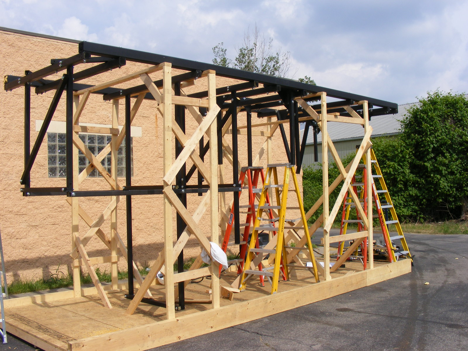

Here is a picture of the bridge we are loading today!
