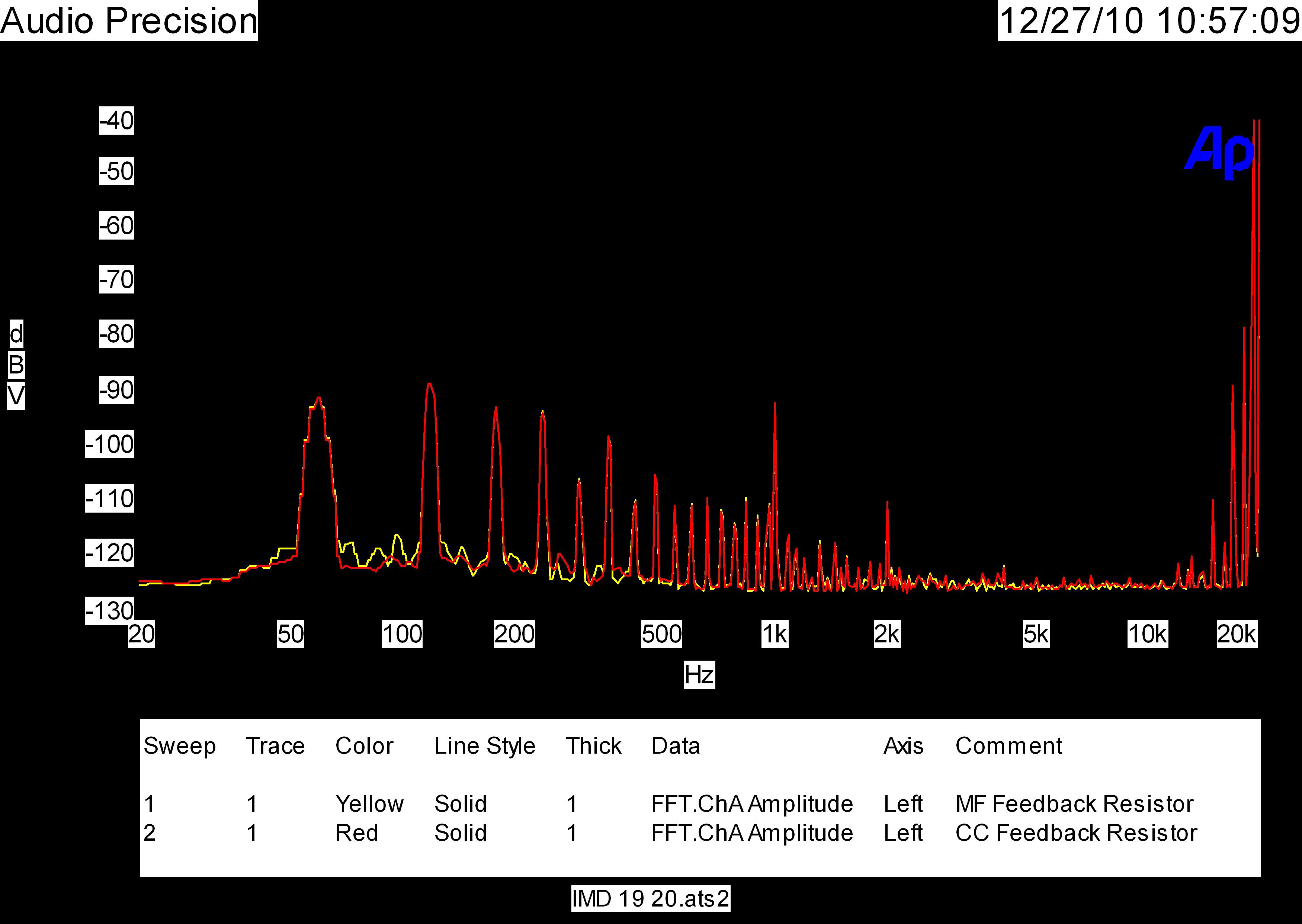

I was looking for my results with DC bias to see if the 3rd harmonic changed, but did not find it. I do think I posted it way back on this thread.

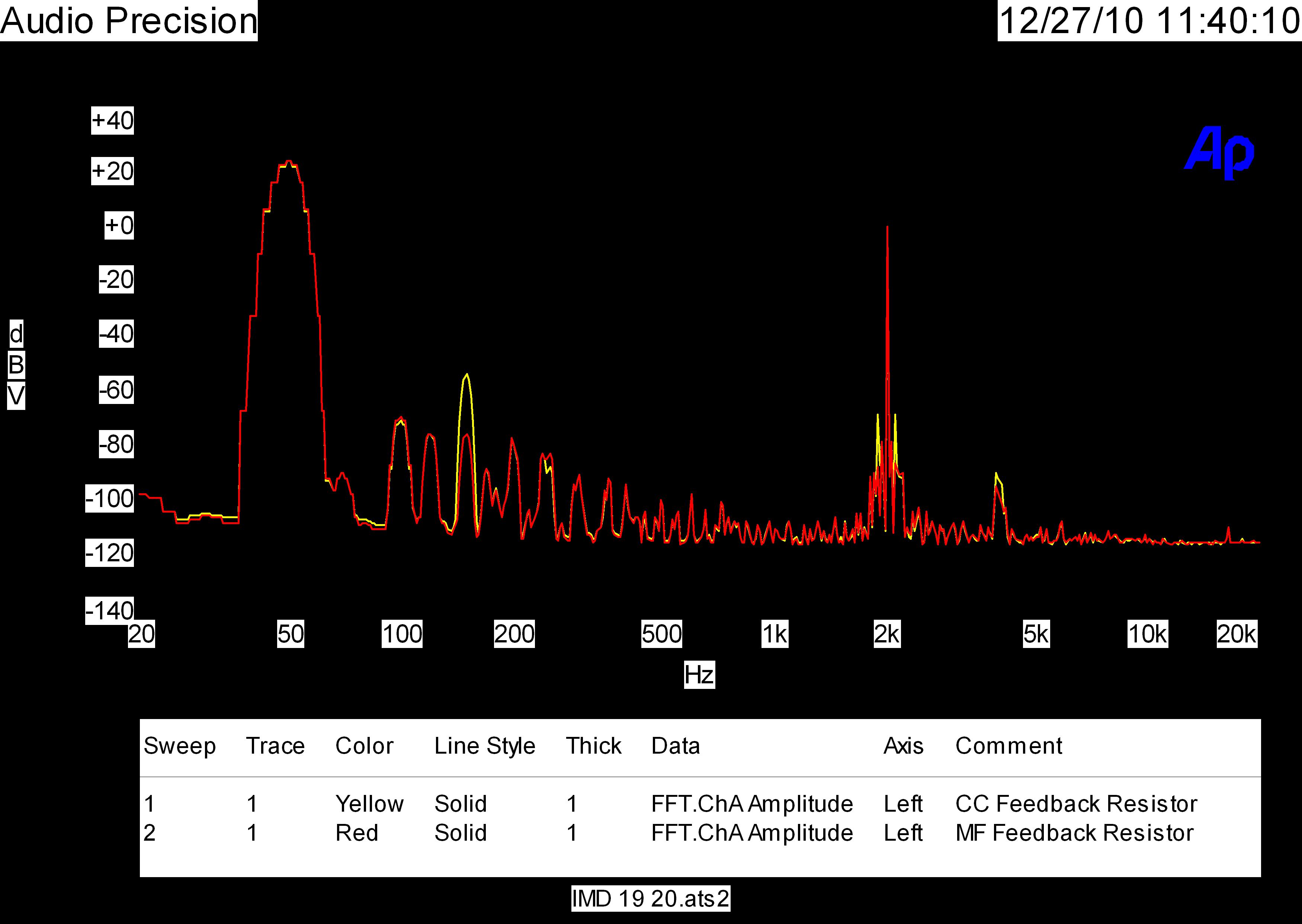

But I did find one interesting test that I may not have shown before. 2 KHz & 50Hz IMD using the same everything except feedback resistor.
BTY if you know of any -140 db amplifiers I'd be curious. (-140 IM @ say 1KHz -30 and .03 Hz -3.)
ES

have you seen this passive device distortion in large Bulk metal Foil R? - I didn't see any in common metal film with 10kHz+11kHz IMD test - maybe too high for the thermal time constants
Well Ed Simon, you have made it very clear why we have to take care as to what feedback resistor we use.
Just to remind everybody, I have been 'harping' about differences in resistors for more than a decade, especially with the feedback resistor, as it is the 'template' that the amp tries to model itself on. Usually to much 'laughter' as well. Well, now it should be clear, VERY clear. '-)

Ed,
Can you be more specific here? Maybe I missed something. Are you talking about a power amplifier? What kind of IM are you talking about? Two tone? SMPTE? Or did you mean to be talking about 1 kHz THD?
Bob
Bob,
IM dual tone, one at .03 Hz at a power level of -3db re full power, the other 1 KHz around -30db re full power. Just for you you can also try it at 20 KHz. :)
Yes I meant a power amplifier. Now most can't handle .03 Hz so you may have to run up the frequency a bit, but that will result in lower distortion.
The issue I have been playing with as shown by the two measurements of the same resistor comparisons is that the envelope of a musical note (often mentioned as ADSR) can cause shifts in amplifier performance. The question has become, are there forms of transient distortions (ex. once every 1000 seconds!) that are missed in testing but are large enough to be detected by an experienced listener?
ES
And just to be a B... show the same levels of distortion at the real operating point say one watt!
As you can see from this 19 & 20 KHz IM plot, it is the low frequency modulation that makes the CC & MF perform significantly differently.
Simon,
I find it difficult to interpret measurements in your second picture.
After zooming in, one can see that yellow trace is always underneath the red one, which means almost the same spectral content.
Yellow trace shows, what appears to be, higher noise floor in 20Hz-1kHz region, but according to text notes, yellow is MF. Is that correct?
Best,
Simon,
Best,
That is correct. Although they seem to be about the same below 40 and back by 250 Hz.
