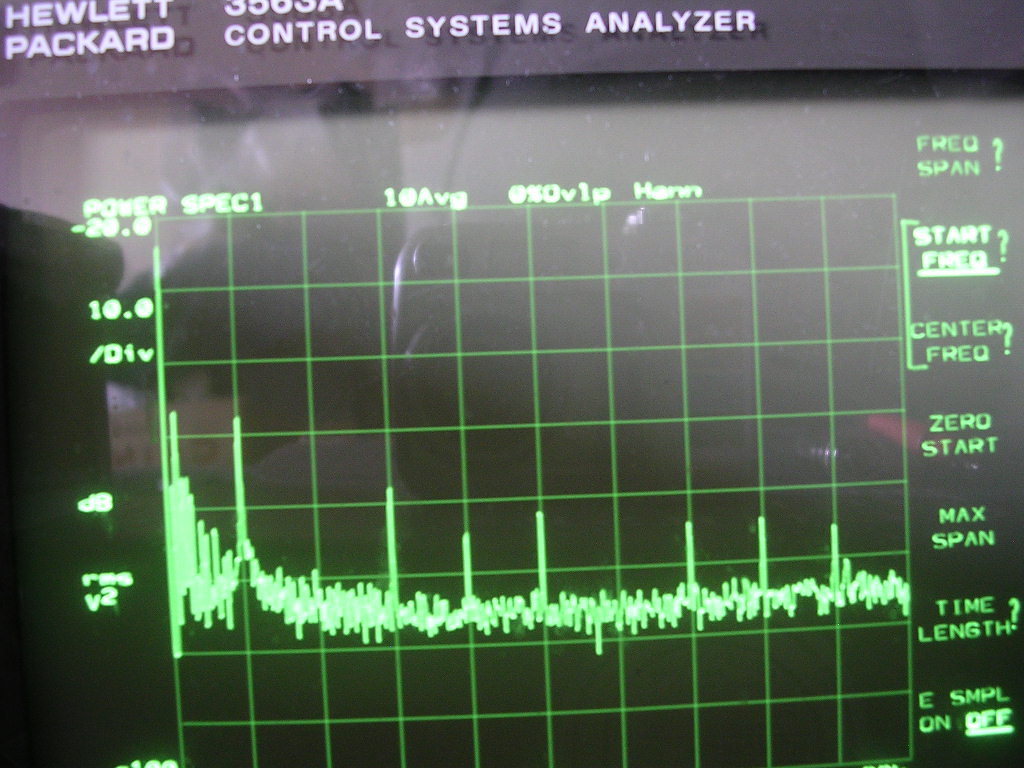

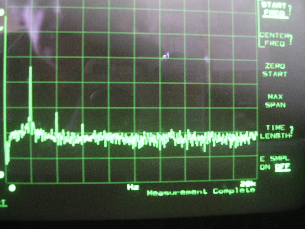

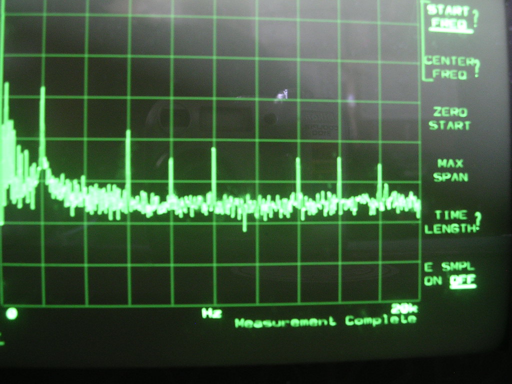

I am 'insulted' when people accuse me of making myself into a guru. I have more textbooks on physics, virtually surrounding me than most 'physicists' and certainly most 'engineers'. I have looked far and wide for the ANSWERS this past 20 years, mostly based in physics. I get 'laughed at' by people here, every time I put something forth let me give you an example:
wire test
See what I mean? These are 2 measurements taken with my digital camera, fairly recently, with an ST-HP3563 measurement for MY reference, not to show the world. What I care about is shown on the screen, but even the SCALE was cut off, due my learning how to use the camera to take pictures from the screen.
Should I IGNORE these differences, just because I cannot 'explain' them?
