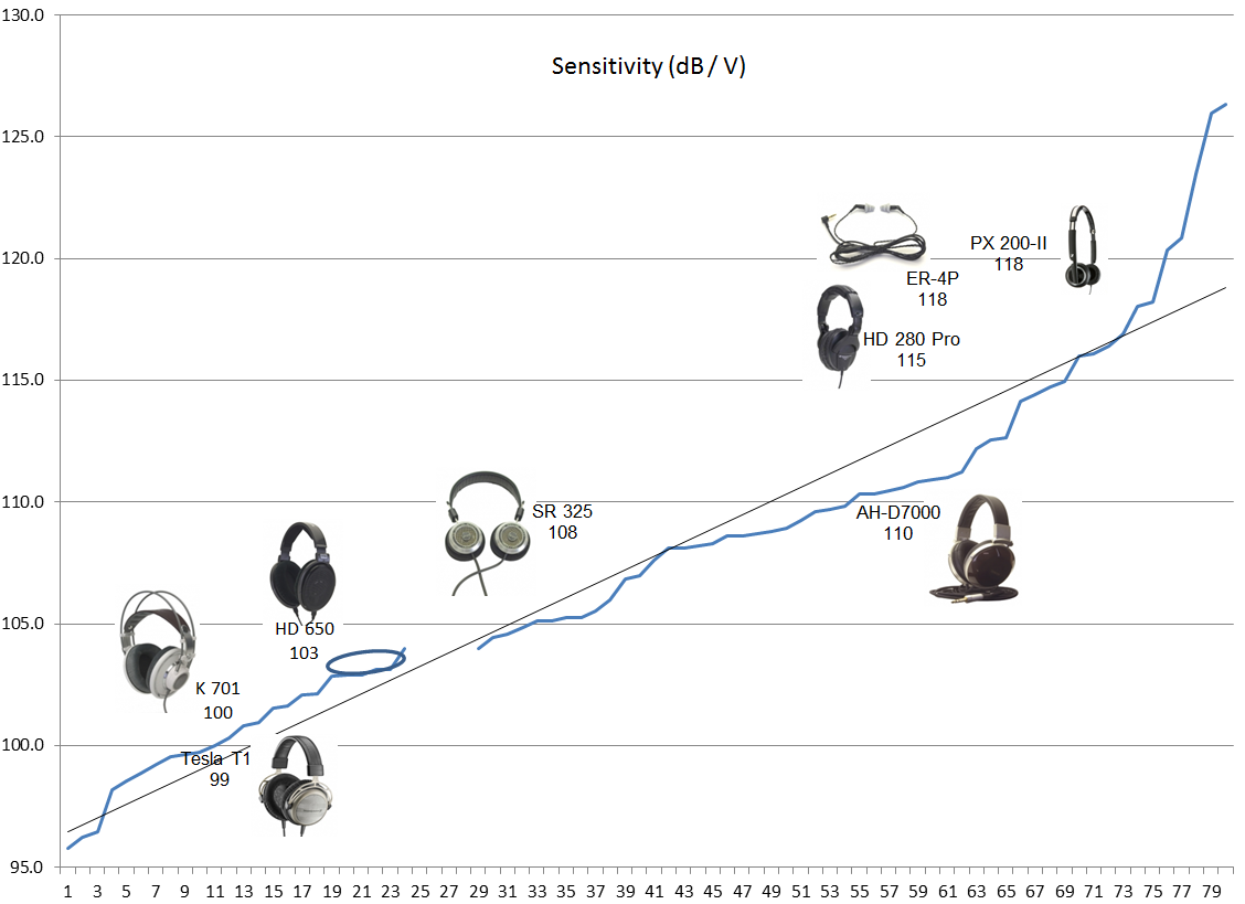

I'm not sure how accurate this is . . . (I created it awhile ago : ).

headphone sensitivity and impedance have quite a wide range
a "universal" headphone amp is impractical on dynamic range/noise floor limitations - sensitive iem can have >135 dB SL re 1 Vrms down to <90 for some "studio monitors"
senstive iem really deserve good step-down xfmr output amps
but most "over ear" headphones can be driven to 110-120 dB SPL with <10 Vrms, 100 mArms
Grado's 32 Ohm, 113 dB re 1 Vrms is a typical "low Z" headphone
Senn's "Audiophile" HD600/650/700/800 are 300 Ohm, 103 dB +/- 2 dB
some new "Audiophile" Orthodynamics are a challenge to standard op amp supply V - however they are wired "Balanced" and can be driven adequately with bridged output from +/-15 Vsupply amps
I zipped a Open Office spreadsheet from a older Head-Fi thread so its not up to date but still has lots of headphone's sensitivities
  • sensitivity (2).zip
