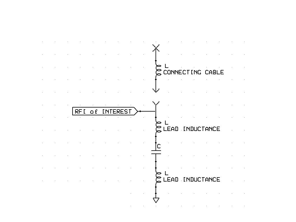

Well SY,
Today gear goes above 30 Mhz and leaded bypass capacitors are rarely used.
This is the circuit theory representation of what I am talking about. The top X on the circuit is undetermined. It can be another piece of audio gear or even an open cable.

No, we are talking about a solid ground on the shield.
What about installing a .01uf cap between the insulated RCA body and the case? This should bypass RF to ground. Not a perfect RF answer, but better than not using the cap.
The start of this was bypassing an RCA connector mounted in an insulated bushing on a metal panel to avoid grounding issues a bypass capacitor is added from the shell to the chassis at the point of entry. We are not talking about RFI removal from the signal carrying conductor.
In the case under discussion it is the RF leakage on the shield that is not decoupled at the chassis entry that can cause problems farther along the circuitry.
Your nice work is of the ability of a capacitor to perform under the best conditions for such a component.
If you add the inductance of the shield as I showed to the limits of a real capacitor you get at some frequencies essentially a tuned antenna! This signal is then coupled into the circuits ground plane and can cause problems.
A leaded ceramic capacitor at the RCA jacks point of entry connected to the chassis is of limited use to lower frequencies. This is not the same case of bypassing a noise source.
The issues are the source: Which in this case is not a local signal as would occur on a PC card, but the constant EMI that surrounds us.
The path: Through the air into the shield of the audio cable, past the bypass capacitor (which becomes ineffective past the resonant frequency of the shield inductance and the bypass capacitance) and into the zero voltage reference signals of the device under consideration.
The receiver: This refers to the parts of the circuitry that when the ground point is encountering EMI will cause other parts of the circuit to misbehave. If the circuit is designed in such a manner that the EMI level would be the same at all locations, then the issue would not occur. But as it is almost impossible due to what in circuit theory are called parasitic capacitance, resistance or inductance.
So no we are not talking about a solid ground on the shield.

If you bring a shielded cable into steel case and onto a PCB, RF on the shield will cause the PCB and components to move up and down (electrically and at the RF interference frequency) wrt to the chassis. Because of the capacitive coupling between the internals and the chassis, this is appears in many cases as a differentially coupled signal and you end up with serious problems. Shunting the shield to ground at the the point where the cable enters the chassis via the connector helps to prevent this mechanism. Lead inductances on the cap are an issue, but this technique is still successful because it effectively swamps the capacitive coupling between the circuit nodes on the PCB (and any interconnect cables) and the chassis - and this is what is important. In designs that take the shield to the star ground, the inductance between the chassis entry point and the star ground causes problems. The cure is the same - use a cap at the entry point shield to chassis.

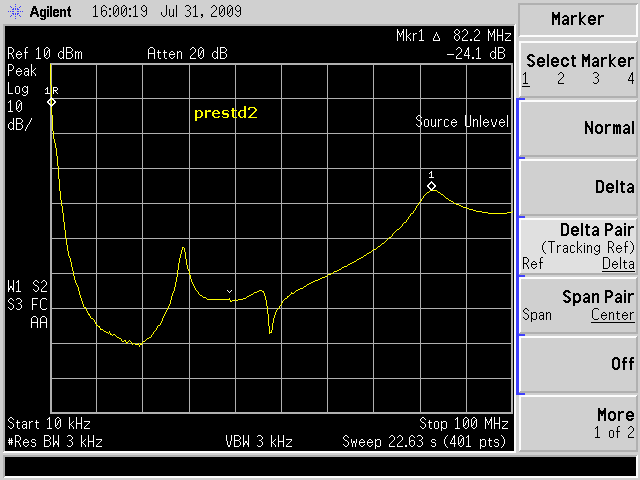

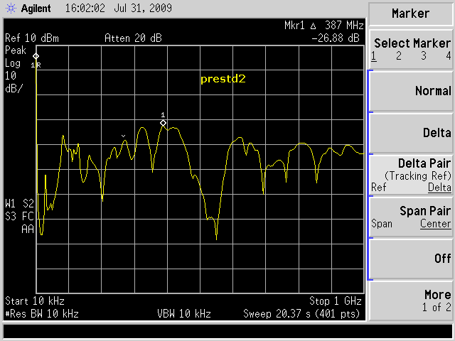

Hi Rick,
these are good points. Let me show the results of measurements of HF penetration through an audio preamplifier built in an 8mm thick Aluminum case, with RCA connectors insulated from chassis and the preamp board connected physically in one grounding point to the aluminum case. 1st measurement covers range 10kHz - 100MHz, 2nd measurement covers range 10kHz - 1GHz. My goal here is to show that there are many unsupported claims in this thread, like exaggerating influence of the thick Al case without any respect to connectors grounding and wiring used. We can see that the shielding effect above 20MHz has almost gone.
You will find the inside photo of the Blowtorch amplifier in the 1st part of this thread, which clearly shows insulated connectors and BARE conductors used inside the box. Such arrangement is almost ineffective in HF suppression.
I have been designing and producing measuring instruments for High Power and High Voltage testing laboratories and I am well aware of the construction practices needed for the undisturbed operation of such instruments. Even several mm of a wire interconnect between insulated connector and a shielding case is a big problem regarding HF interference influencing electronic circuits inside the case.
Thanks for your input.

Regarding the needed level of protection, I am not sure that we do not need it.
In my experience, the level and spectrum of HF interference penetrated into audio equipment is responsible for most of the sound differences. All that power cords, mains conditioners, link level cables, speaker cables etc. are mostly about just different electromagnetic interference.
I admit different sound preferences of different people and I have no problems with it. But I cannot digest unsupported claims like that on shielding, power supply design (with no measurements supporting EMI rejection) and I have already become tired of the never ending same reasoning. This matter of thick wall shielding (with no respect to HF rules) has awoken me for a while, but I will disappear again. I am quite busy with serious work.
