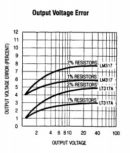

Re your -147 figure ref 1V, how do you arrive at such a low figure? Anything below -120dBVA needs to be carefully qualified. Throwing figures like that around without an explanation is to be rightly questioned. I think PMA is right to challenge you on this. Care to share the details?
First, resistor tolerances that are better than those of the TL431 are readily available at a cost of fractions of a cent per pcs. So the "improved accuracy" argument is highly specious.
Provide reasoning then, don't just make claims. In my estimation, tolerances typically add as sum-of-squares. Given typical accoracy of el-cheapo TL431 is 2% and resistors are typically 1% this does in fact still degrade the initial 2% tolerance of the TL431 to a (very) worst case 4%. Using 0.1% resistors would improve on that but having no resistors at all remains more accurate. A 0.1% resistor costs about the same as a bog-standard TL431. Unless you can show reasoning to the contrary?
I repeat, "stacking" references is a very stupid way to get low noise, as it does not get low noise and only unnecessarily increases component count.
Where did I claim that my aim was to get low noise? I'd certainly steer clear of TL431 altogether if I was serious about noise. The component count of 4 TL431s in series is precisely the same as that of a single TL431, 2 resistors and a bypass cap. QED.
I've attached a plot from Linear Tech's LT317A series regulator - the principle is the same as for the TL431 except the bandgap sits at 1.25V rather than 2.5V. As the output voltage goes up so the error contribution from the resistors increases too.
Sy,
Hence stacking references has not netted us an improvement in noise, it has only dis-improved the noise.

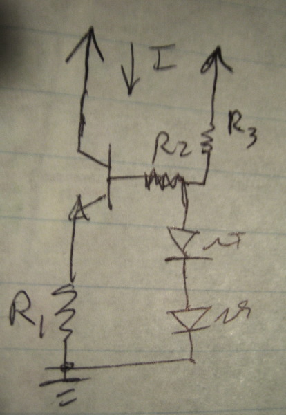

No, what SY said makes sense, for the current source shown below. Doubling the voltage makes you increase the degeneration resistance R1, reducing the gain by -6dB. Or as SY put it, increasing the signal by 6dB.
Lower gain means lower noise, since the noise only increases by 3dB, the overall circuit has 3dB lower noise.
It also makes sense for a normal voltage regulator that compares the output of a regulator to a reference. The voltage regulator amplifies the reference voltage- drop the gain by two, increase the reference voltage by two, and you have that 3dB noise advantage again. Yes, you could cover that up by incompetently specifying a noisy error amp, but that's the stuff of polemics and cartoons, not engineering analysis.
You could get lower noise by using my suggestion of using an amplified zenner diode, using a suitable transistor (much lower noise than the reference).
In other words, use the lowest noise reference available and scale it with unity AC gain will be lower.
So no, it does not make sense in the context of competent design of the circuit.
Ciao T
