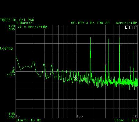

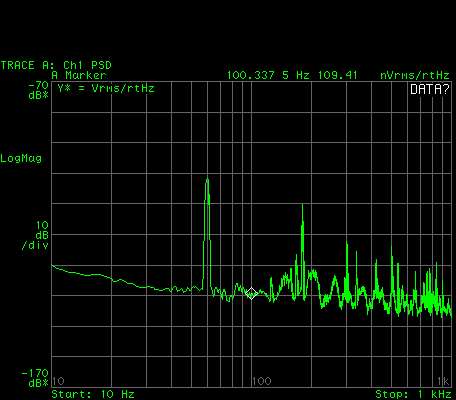

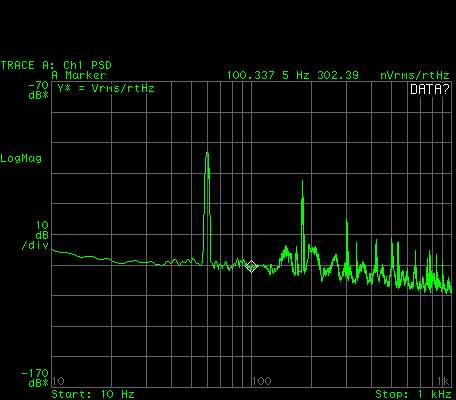

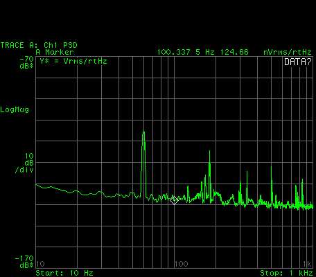

Here are the results for the Norton reference. All measurements are at 24V from a HP6624 low noise power supply. For each device, I measured the Idss and chosed a resistor R so that the output voltage is around 19V. Noise was measured with an HP89410A VSA, in 10Hz-1KHz, 1601 points. The first picture in this message is the analyzer noise floor (input shorted). It can be eventually extracted from the measured noise data (I have all the traces) but this won't dramatically impact the conclusions. No extra filtering (electrolytic or other) was employed in these measurements.
Here's the devices I had at hand (datasheet specs and my measurements). Measurement results are also attached, each picture is identified by the device name.

PN4392
Datasheet:
Idss=25...75mA
Vt=2...5V
Vn@100Hz=Unspecified
Measured:
Idss=47mA
R=390ohm
Vo=18.33V
Noise=109.4nV/rtHz
2SK246Y
Datasheet:
Idss=1.2...3mA
Vt=0.7...6V
Measured:
Idss=1.3mA
R=15k
Vo=19.5V
Noise=124.7nV/rtHz
2SK170BL
Datasheet:
Idss=6...12mA
Vt=0.2...1.5V
Vn@100Hz=1nV/rtHz
Measured:
Idss=9.7mA
R=2k
Vo=19.4V
Noise=302.4nV/rtHz
As you see, my previous comment regarding the JFET Gm and the output noise is totally confirmed. Gues who's the worse contender? The lowest noise device, having an average transconductance, the 2SK170BL. Why? because it has by far the lowest pinch voltage!
And the best contender? The monster Gm device, with unspecified noise, but high pinch voltage, the PN4392 from Fairchild. This exercise is a good example on how intuition can trick us...
One to another, my results show that it is possible to get around 100nV/rtHz with a Norton reference. We'll see in the next days how's with LM329 and LEDs.
P.S. I see the file names are not displayed. The pictures are in the same order as the devices above.

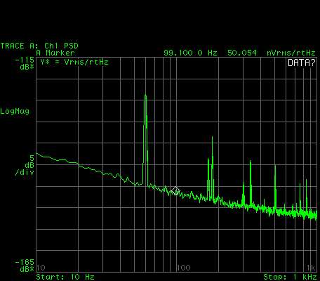

And here's a quick pass on a randomly selected LM329. Anode current is 1mA, reference voltage was measured as Vref=7.1V You would of course note the missing 60Hz peak, a good sign that the circuit has a low impedance. Also no filtering (electrolytic or otherwise) was used.
It happens that the noise is, at 108nV/rtHz, as good (or bad) as the best JFET Norton reference...

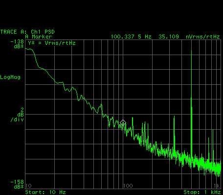

Ok, family is going to kill me anyway:
Red LED, manufacturer is unknown (got them from a Chinatown store) @5mA. Voltage across the LED is 1.86V No filtering (electrolytic or other) and the LED is fed via a 2.7kOhm resistor. I'll do a JFET current source next time, but I'm not exepecting to be anytime better.
About 50nV/rtHz and now I really have to substract the HP89410A noise. SQRT(50^2-35^2)=35.7nV/rtHz You need 4pcs to get to 7V, this will make it to a total of about 70nV/rtHz So far, the best of all, but I wouldn't hold my breath. As I've already said, LEDs have huge variations from manufacturer to manufacturer and from batch to batch. Also, the output impedance is not that low...
