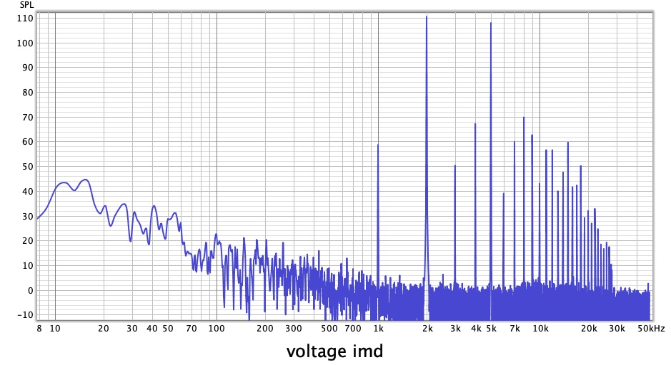

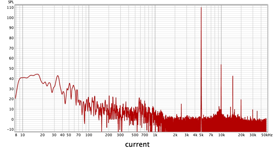

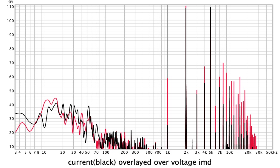

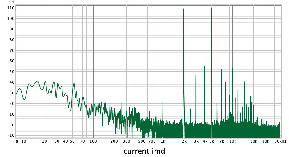

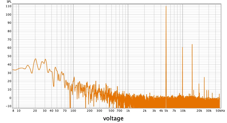

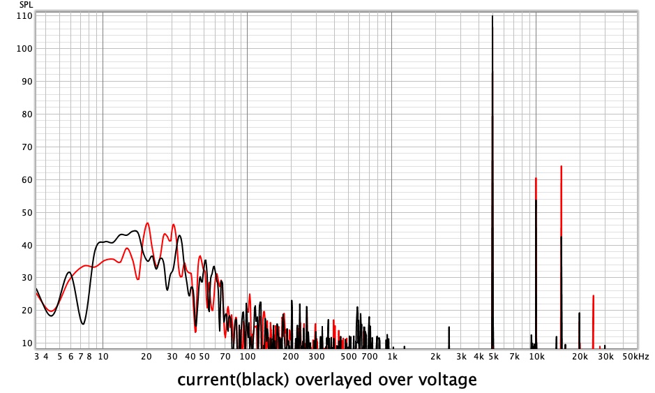

some measurements current and voltage drive visaton BG20 driver. acoustic output. just some measurements for myself so don't remember details like distance to driver kind of box if there was one.These where just for self check if the amp works in both modes.
I used to have those Visaton drivers, pair. Thanks for sharing, yes it is the acoustic output.
Now try to put a small inductor in series and see if you do not see a reduction in distortion with voltage drive, something that gets closer to current drive. You may have to vary the value of the inductor till you get a value that looks good and has not affect on above 5KHz. The BG20 may suit a two-way better that way, but if you see an improvement, note that the reduction is greater than the frequency attenuation of a 1st order filter. Try it if you have the time.
But thanks again - there are things falling into place and we are better at understanding what is going on and how it works. The driver is modulating the current of the amplifier which in turn is affecting the force-factor (BL) of the driver. When the voice coil moves, the impedance of the driver changes. It is worst when a low frequency signal (excursion) coincides with things happening in the midrange. I am not the only one who has looked at this.
So basically what you are trying to say here is that with this inductor the driver will work towards voltage drive at low frequencies and towards current drive at high frequencies? If that is the idea than i understand it and don't have time to test it :) if you meant something else correct me. I have adjustible corner frequency in amp for transitioning from voltage to current drive so don't need an inductor test
So basically what you are trying to say here is that with this inductor the driver will work towards voltage drive at low frequencies and towards current drive at high frequencies? If that is the idea than i understand it and don't have time to test it :) if you meant something else...
