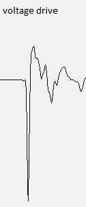

The elephant in the room isn't getting addressed. The impulses seem to be showing response differences. Is the current amp being used for its EQ?This I believe is the main reason for better sound of transconductance amps, besides emf and other things. Timing.

As I mentioned before, and it was rejected, I do compare two amps after I eq each in the listening position to perfectly flat fr response in the listening position. I do this every time I make change, no matter how small.
So impedance changing fr response argument is not valid.
I am just comparing two amps, all thing being equal. Current drive wins. Gives me chills how good the harmonic profile is, like the clarinet or oboe is right there in the air.

It seems to me that phase is playing role here.
Remember long time ago we had crt color tv? There were three electron beams which hit different light fluorophores. If they were not aligned properly, image sucked. But once it was in sync, it resulted in nice image.
Only if those two impulses are fully identical you will have apples vs. apples. Per definition phases will be identical under that condition. Sorry, but there is no misinformation here as far as I can see.
The impulses can be FFT 'd in order to obtain data in the frequency domain.
Different impulse=different .frd, whether one likes that or not. In case your equalization yields a different impulse, you still have a differences in the frequency domain or phase differences.
