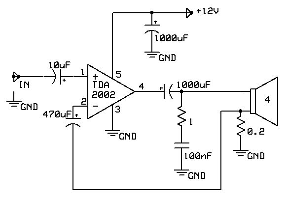

Thanks again. Please, is the attached scheme correct? Can you made some suggestion for improvement?
The trick here is that it is single ended power supply and I see that you have two blocking capacitors, so it looks OK to my eyes.
But... be careful, if you disconnect the speaker you are opening the loop of the amplifier chip (not designed for that), so you will need a permanent parallel resistor or else something is sure to go wrong. That parallel resistor effectively defines the output impedance (and also chews a bit of amplifier power). I would suggest a 100R permanent resistor, if the sensing resistor is 0.2R, then the max gain will be set to 100/0.2 = 500 (54dB max). You need to define that for safety.

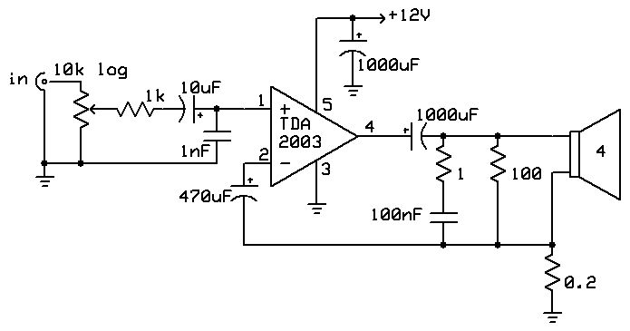

Go back to Post #1 and you will see that I used 470R and 0.33R for current sense. I got an output Z of 270 and max gain of 58dB max. That's OK too.

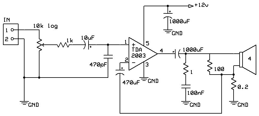

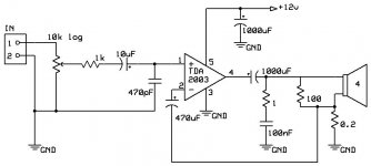

I have add the 100 Ohm resisto.. also some improvement in the input. Please, think you that all are OK, or I need made some other improvement?
I think you are almost there. The other thing is the Zobel network, I would put that, not to ground, but in parallel with the 100R resistor you just added.
Re the input low-pass filter, I would increase that 470pF to 1nF and once I have got the amplifier working, I would experiment with the 1K part of the filter, probably gradually increase it in value and settle on the value simply by listening only.
