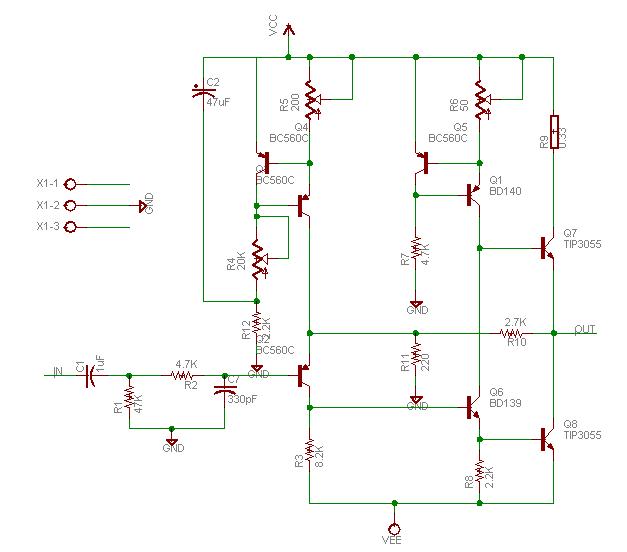

Hi guys,
I built JLH with this circuit http://www.tcaas.btinternet.co.uk/jlhupdate.htm.
The bias is set at 300mA due to small heatsink. I am very dissatisfied with the sound as compared to GC. Also substitue TIP3055 with MJL21194 with no improvement in sound. It has poor control on the lower end, rough top end and not as detail as GC. It only excel with solo female vocal. Can you tell me what's went wrong?
Thanks.

Hi Ipanema,
I haven't made a JLH yet.
On the schematic, it looks like you missed C6/C6A and C7/C7A. Rail filtering is important on amps with poor PSRR.
Feedback cap C4 may be necessary. I know it is missing off the "final" schematic.
I don't believe running the amp at low bias is a good test for a class A amp. Put some big heatsinks on, and/or use a fan.
You need to post the details of your power supply. It needs to be reasonably ripple free.
A picture of the amp may be useful too.
Regards
Hi Greg,
The local supply decoupling caps are 1000uF + 100nF (ceramic). Power supply circuit is capacitance multiplier as suggested here :
http://www.tcaas.btinternet.co.uk/jlhcapmult.htm
I use Figure 2 which suppose to sound better without C4 albeit higher offset. Offset are 10mV and 80mV for my stereo pair.
Will try higher biasing when I got a macho heasink. :D
Do you think that BC560C is inferior than 2SA970 in this application?
Thanks.
the bias is too low. depending on how loud it is, you ought to run it a little bit higher. I would suggest at least 750ma but hopefully over 1amp.
You may run it at lower voltage (like just off the +24v to reduce dissipation). alternatively, you can use mosfets as output and run this in class AB.
Disabled Account
Joined 2005
JLH vs. GC: the GC is considerably louder. and at low volume, there isn't much difference between the two. When pushed over its limit, the GC starts to sound harshier more and sooner than the JLH. When overdriven, the JLH tends to sound muddy rather than harsh.
1969 vs. others. I never tried other versions as laid out. My interest is mostly on the 1969. and I have tried the stock bootstrap, without the bootstrap and with a CCS load. Again, not much difference when working in their parameters. However, the one with a CCS tends to sound harshier when pushed. and no-bootstrap version is quite gentle when pushed.
For what I do, I decided to stay with the no-boostrap version.
