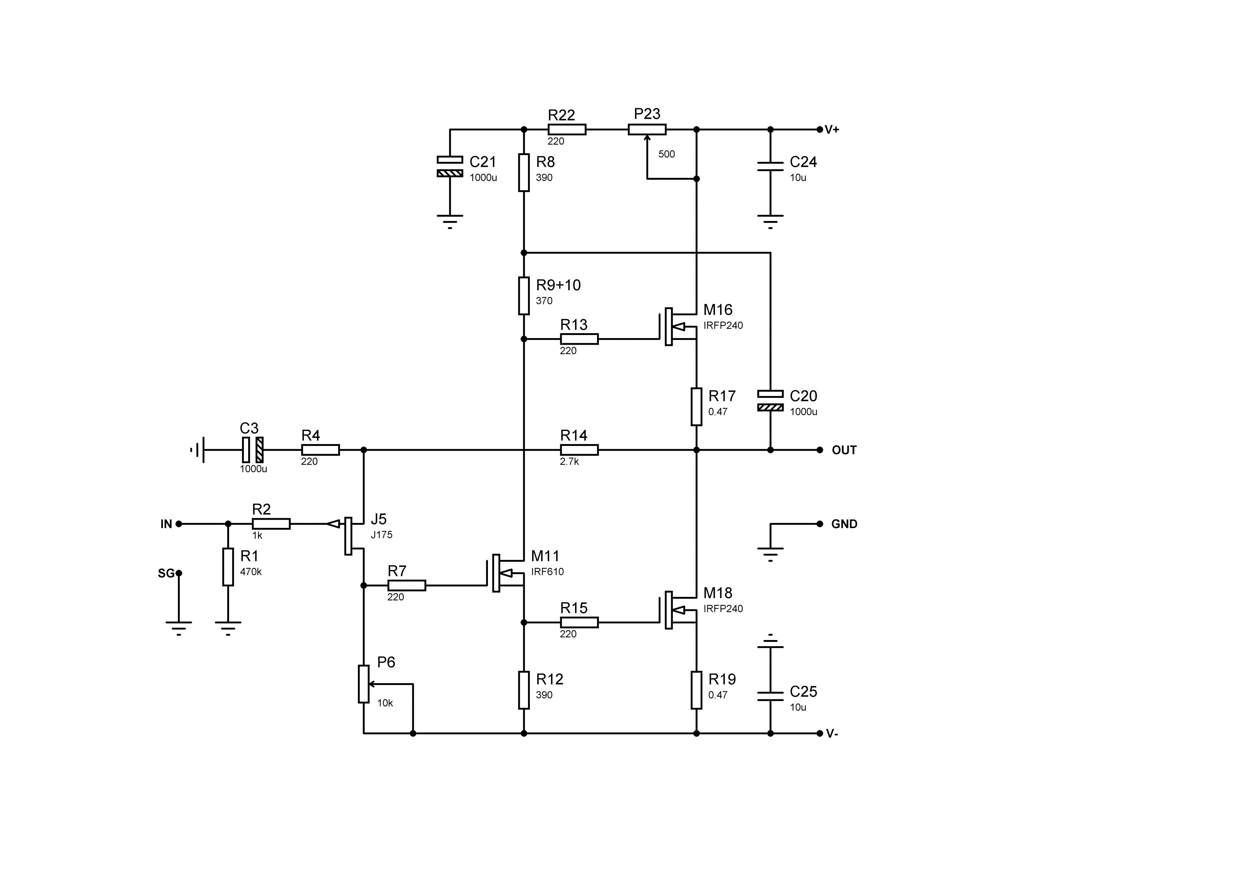

Here is the schematic. I have ordered the PCBs, and as soon I receive them, I can start mounting the components before initial testing.
I plan to use a 2x18 V 500VA transformer common for the two channels. I also have two quite large heatsinks (0.3 K/W) which I plan to use. This amplifier favours high quiescent current, so maybe I can set this as high as 1.8 A...

Yes I know what you mean. I have not quite decided yet if I am going to use a pot as done in the PLH amplifier. For the time being I have thought of using to resistors instead of the pot and then have the possibilty to change between push pull and something like halfway single ended.
This is certainly looking good to me! - Nelson can help crit the design I am not up to that - but I mean the concept and the components!
I have a pair of Conrad MF35-151.5 heatsinks rated at 0.21C/Watt and I have IRFP240s - so yes very happy with the direction this is going knutn!

Knut,
You can balance the drive on the output transistors by splitting the 0.47 ohm sense resistor into a centre tapped pair of 0.235 ohms, with the the feedback resistor R14, the bootstap capacitor C20 and the loudspeaker connected to the same point. I used this approach in the latest version of my interpretation of ZenV4 - similar topology to J Aleph.
