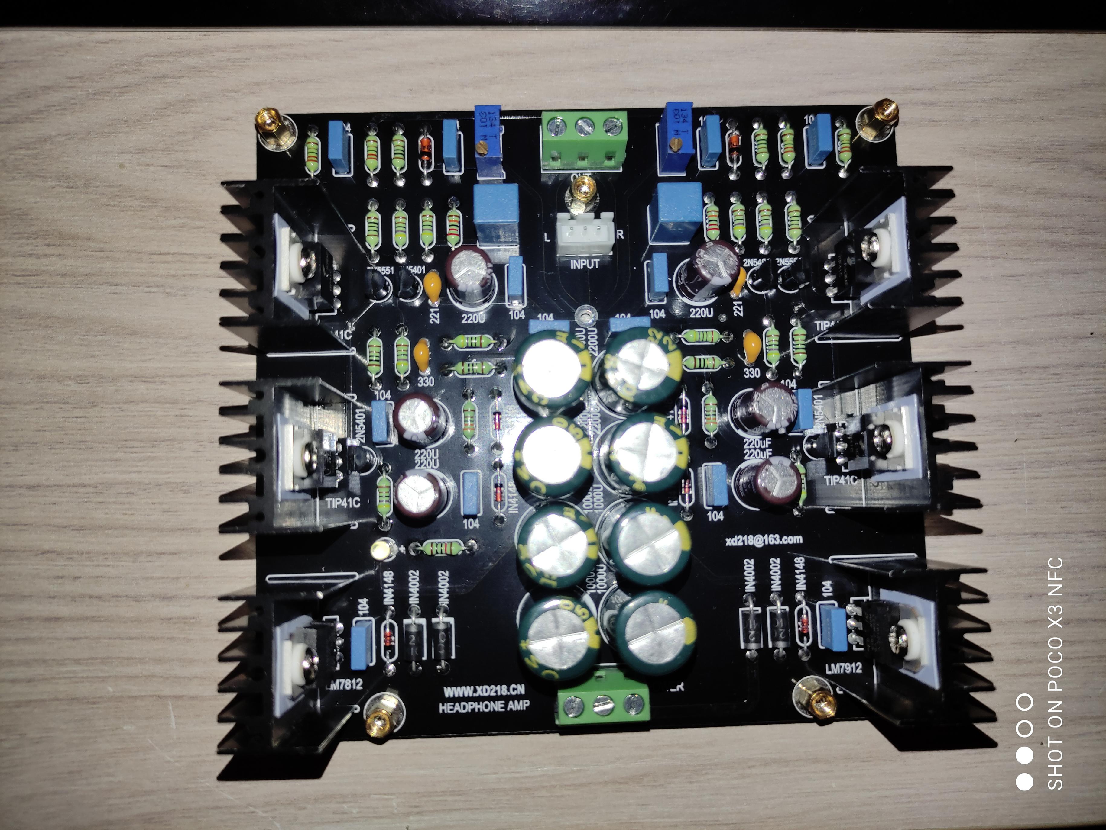

I am a beginner in diy audio, and I bough this cheap board (And As well the ha-pro2) to start to learn something.
Aiyima JLH HOOD 1969 Class A Headphone Amplifier Small Power Amplifier Pre amp DIY KITS|class a headphone amplifier|headphone amplifierheadphone amplifier class a - AliExpress
I‘m waiting the delivery, and in the meanwhile I try to follow your indication in this forum. I didn’t understand a lot honestly, but I don’t want to burn my headphone at the first try .....
Could you give me the basic instructions to test the board before to connect the headphone(32Ohm)?
Which voltage I need to check, and where?? Which will be correct value?
Where I have to insert the cap to ‘protect’ my headphone? Is it mandatory, or I will burn it surely?
Is it mandatory invert the polarity of the 2 caps?
Thank you and sorry for the questions... that It could be stupid...but I try to do of my best

surfparadise
The best thing to do is to follow Miles Campbell's instructions from post 115 to 158. They include how to measure DC offset and how to minimise it.
He modified the design to minimise the DC offset by replacing the trim pots with a wire link and changing the resistors next to/near ? them.
I found it was better to change the resistors as he recommended but to leave the trim pots in and adjust them about an hour after switch on to give zero offset. That way the DC offset was approx 70mV at switch on, which dropped to less than 30mV in a minute and dropped to zero in less than 5 minutes.

The regulators would get rather toasty, though perhaps not unmanageably so... around 2.5 W may still be doable with these decently-sized heatsinks. Likewise, the 25 V rated cap should just about cope.
As a potential workaround, you can try some 15, 18, 20 or 22 ohm, 3 W dropper resistors in series with the secondaries. Those should take quite a bit of heat off the regulators. Mount with long legs as they will get hot.
Trimpots are likely to be for output DC offset adjustment.

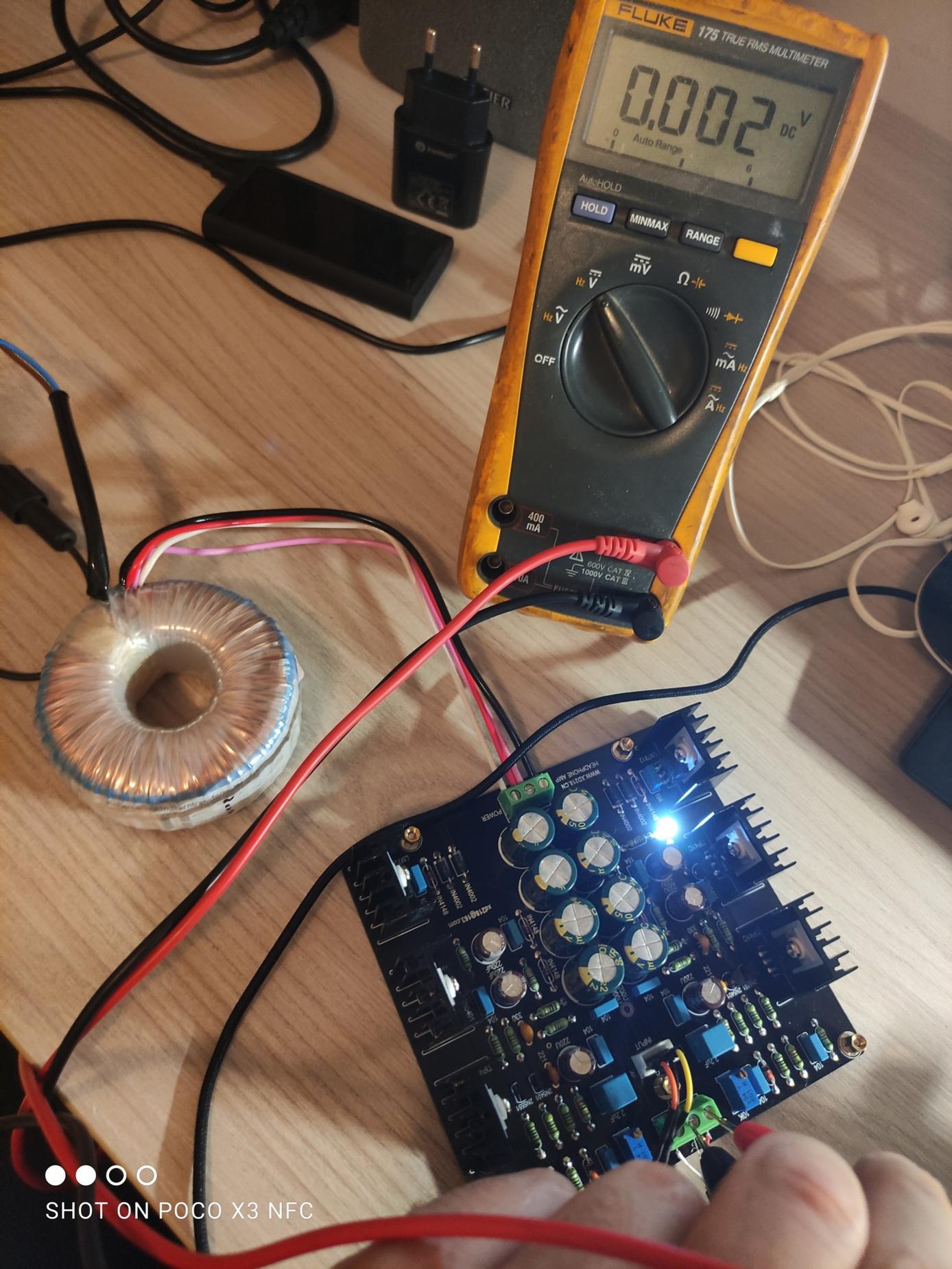

I finally got a +-12V toroidal. Heatsinks warmup takes around 10/15 mins: during that time I've been regulating several times the DC offset; after that time offset changes very slightly, in the order of couple of millivolts.
With a pair of Superlux HD668B (56 Ohms impedance) sound is excellent.
