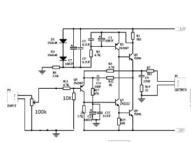

Hi Folks,
I built JHL kit(Chinnese version from Ebay) n then i converted them to JLH(original version), after i tested the amp, stil, i don't like the soundquality of the amp(the top highs/treble rolled off and the bass is weak) so i did some mods again
- VR1 10K to 100K Potensiometer
- Bypassed the C1 1uF
- Desoldered R1 47K, R3 10K, C1 100uF, D1(zener diode)
- Replaced C3 220pF with Resistor 10K,
- Replaced R5 470ohm to 1K,
then i tested them and like the improvement

'scuse me, but your mod makes just about zero sense to me. You now have a considerable output DC offset, roundabout +1.8 V or so. Not something I'd call particularly acceptable. And using a 100k pot will, if anything, only increase noise and distortion.
How did you come to the conclusion of "the top highs/treble rolled off and the bass is weak"? What did you compare the amp to, with what kind of headphones? Have you carried out a basic frequency response test (using e.g. soundcard + RMAA)?
Assuming it is equipped and working correctly, the JLH amp built according to the first schematic should have none of the deficiencies you describe.

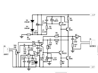

Hi there,
I'd like to know if measuring the dc offset with and without load, you see any differences.
because I measure around 30 mv of difference.
My sensation is that DC offset is unstable, and I have some problems to fix it
I changed some components:
C13 = 1,5uF instead of 1uF
R19= 10 K instead of 220K ((no technical choice, only for components availability )
VR3= 2,2 K instead of 10K (idem)
C15 = 47pF instead of 220pF
In this way I extended the range of frequency from 5Hz to 22KHz flat, could it be the cause of my problem?
Thank you in advance

Assuming you have adjusted DC offset to 0+/- 10 mV when the amplifier is warmed up, there should be no significant influence of loading on it. I've simulated with all kinds of transistors, there never was anything more than 1..3 mV of difference to be observed. There shouldn't be one either, since your load connects two nodes at virtually the same potential.
How stable are your supplies?
BTW, try finding a larger-value resistor for R19, otherwise power supply rejection at higher volume settings will suffer.
I changed psu stage with LM 317/337 instead of 7812/7912.How stable are your supplies?
maybe cause of improvvisation wired could generated instable voltage, but don't seem me if I see the multimeter.

How much drift do you get? Some is unavoidable in this concept, as you're essentially seeing 3 B-E voltage drops in series from input to output, their temperature drift included.
If you're seeing more than a few 10 mV even after the amp is warmed up, then you can consider using coupling caps. I'd use two identical 470+ µF caps back to back each, unless you happen to have bipolar ones in 220+ µF, which would be preferred.
I get a drift of 15-20mV
Referring to the schematic, we find that at DC,
1. Q4 Ic is defined by the voltage drop over R4 and
2. Q4 Ie flows through R7.
Now Ic ~= Ie and R4 = R7, hence the voltage dropping over R7 should be the same as the voltage dropping over R4.
The voltage dropping over R4 in turn is Vbe(Q3) + Vbe(Q1).
Hence the difference between output potential and Q4 base potential is
-Vbe(Q4) + Vbe(Q3) + Vbe(Q1)
and therefore the temperature drift of all three will be seen at the output even if Vb(Q4) is stable as a rock. Only one reason why simple single-ended input stages have gone out of fashion.

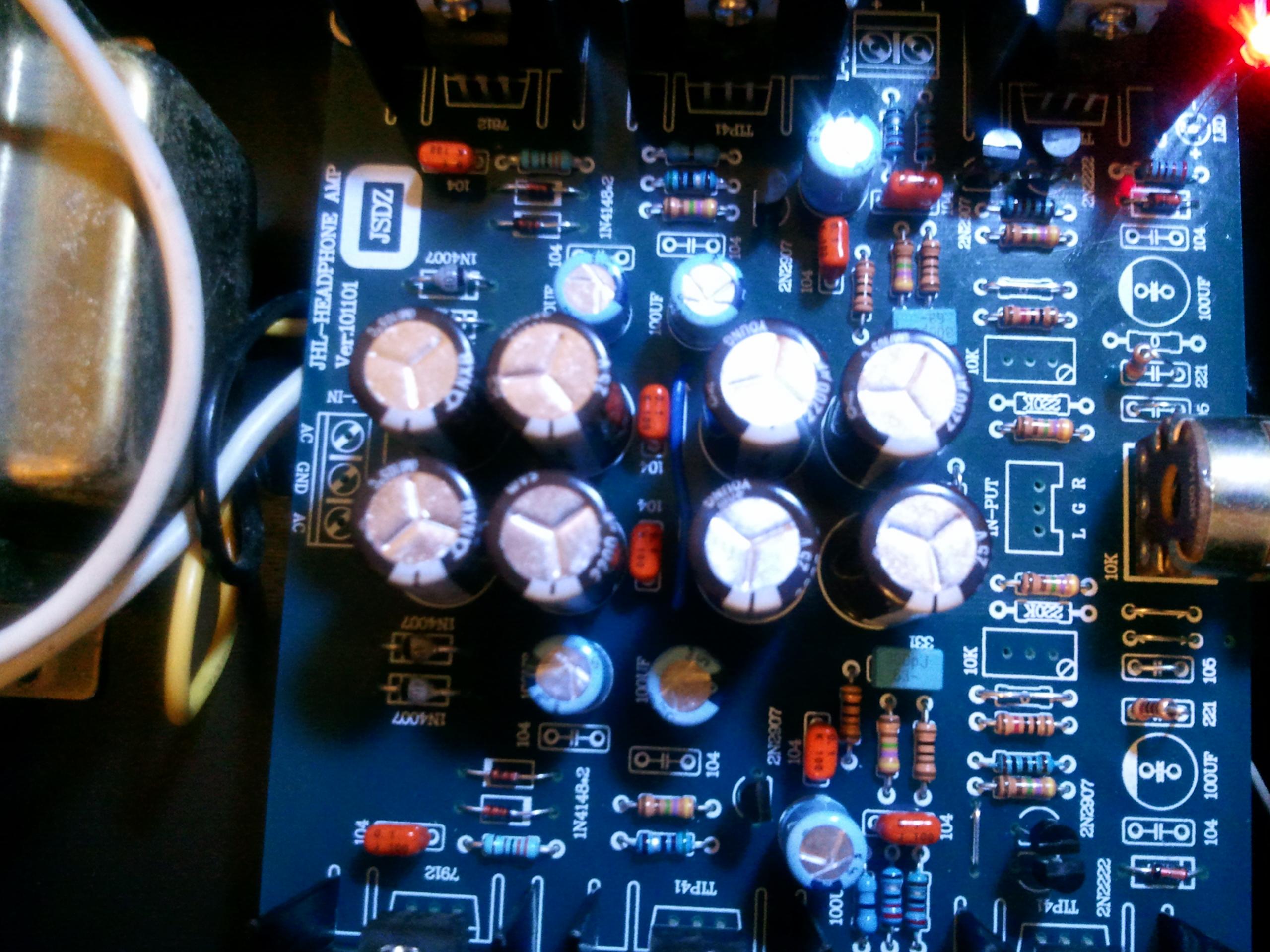

Hi all,
I have built one of these from an Ebay kit. At the moment all the parts are as supplied. It sounds reasonable to me but i've never had a head amp before and don't usually listen to music with headphone so havn't got a reference to compare it to.
My personal taste and main system are more mid forward and open sounding(this perhaps sounds contradictory but is my best interpretation of what i am hearing).
Before i start doing any of the suggested modifications can anyone comment on what difference each makes to the sound ?
Options seem to be:
Better quality electolytics - silmic ? (some or all ?)
Removing some of the film caps bypassing the electrolytics
Changing R1 220k to 47k
Changing R5 470r to 2k2 (reduce gain)
Increasing C4 100uF to 220-470uF
Increasing R9 from 2k2 to 3k3
Increasing R11 from 5r1 to 12r
Increasing C1 from .47uF to 1uF
Removing C5,R8,C8,R12
Better quality pot
Any others ?
I'd also wondered about:
Changing C3 220pF from ceramic to polystyrene
Bypassing the output electrolytic with a film cap
Adding some power resistors betwen the transormer and the board as due to my high mains voltage i have 18V going in and the reg chips seem quite hot

Referring to the modified "JHL" schematic as posted here:
If you build the amp as shown BUT leave out C11-R12 and C12-R14, it should work fine, including good stability. With these components in, it would be prone to oscillation.
What you can do:
Increasing R17/18 lowers gain if needed.
Dropping resistors for the regs. Try ~10 ohms, >=1 W.
When using a better-quality pot, stick with 10k.
Add a 10n..100n (typically 47n) cap across each rectifier diode to suppress RF interference.
Swap C23/24 to bipolar "for good measure". Higher capacity is unlikely to be needed.
Useless:
Increasing the value of C13/15 from .47µ to 1µ does not seem necessary, seeing that simulated FR only is about 0.5 dB down at 10 Hz and there shouldn't be a lot of distortion in this film cap.
The value of R9/10 doesn't make a great difference either way.
The only bypass caps to make any kind of sense here are C17/18 and possibly C30/36 (though I'd think the latter are too far away from the amp to make any kind of difference).
C15/16 (220p) should already be NP0 so no improvement is expected here.
