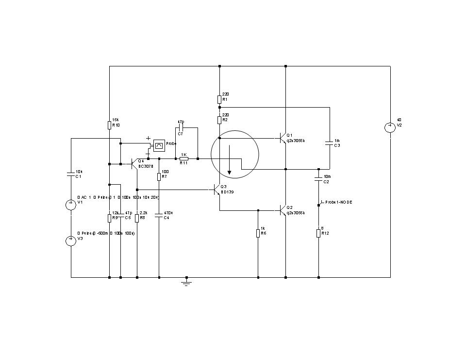

Hi Marco
One design problem in the JLH which I have a concern with is that if the output were to clip, or even if the input signal were to be so fast that the driver could turn on quickly, the upper output transistor might be driven backwards.
In this case, the upper 2N3055 could be killed, due to excessive Vbe(reverse), and then the driver might be killed too.
Here's a pic where the circle illustrates the problem zone.
A solution might be to add a current limit in the driver and add a fast medium current diode in series with the base of the upper 2N3055.
If you have oscillation a small cap may help to suppress this. I've posted a circuit before with MJL3281's in the output (1592)
THe only other problem could be thermal runaway but with tons of heatsink I'd be surprised if this were the case...
cheers
John
cheers
John

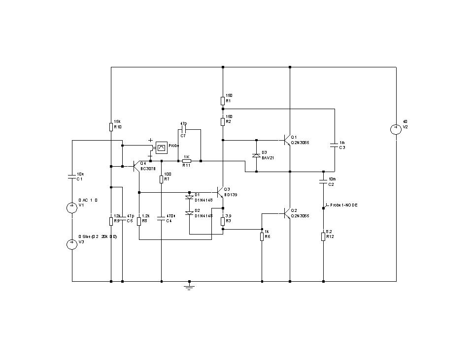

Hi Marco
A couple of diodes for protecting the driver, and two possibilities for the upper 2N3055 diode.
Instead of connecting a diode in series, you could connect a diode in anti-parallel to shunt the reverse current in the base if it were to occur.
As long as the driver can take the power during short circuit/overload the upper 2N3055 should survive.
Diagram shows how.
You mentioned that you run your amp at high voltages. COuld you possibly be running your 2N3055's into their SOA limit?
Original RCA transistors did 1.9A @ 60V. Unless you use "H" versions you may not get this performance anymore. a few years ago, Motorola 2N3055's only did 2.9A @40V then downsized to 0.2A @ 60V.
Latest version from ON semi does 2.9A @40V, then downsizes to about 1A @ 60V - better than older devices but still not as good as RCA's.
If this is a problem you may want to try using MJ15003's or MJ21194's.
cheers
John
Diagram shows how.
cheers
John
this seems the best solution to me. I'll try.
by the way, in my amp both the 2n3055 in a channel fail at the same time. I suppose the second one fails as a result of the failure of the first one under reverse bias?

SO I have every expectation that the MJL3281 version will sound superb. When I get to listen!
Marco - I think that you may be near the limit of SOA for ordinary 2N3055's. You may like to try ON Semi 2N3055's in case their improved SOA helps. I suspect your amp may be oscillating too - this could reverse bias the base junction without you noticing (without a scope). You could try a 47 pF capacitor across the feedback resistor too even for "slow" 3055's. If the DC level changes it might indicate that that was a problem. Sometimes poor wiring can lead to oscillation (stray inductances, etc).
The simulated distortion for the protected JLH was the same as the unprotected one.
cheers
John
