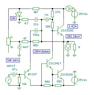

PS. Here's one to play with.

:) Of course it all makes sense and goes a long way to explain why your iteration of DOZ using multiple bd 137/139 devices sounds the way it does as the following explanation by Andy Groves formerly of HI-FI WORLD and nowdays AUDIO NOTE designer wrote in reply to a readers query in theFeb '95 issue of HI-FI WORLD DIY supplement wrote>:" ls it just coincidence that some of the best sounding solid-state amplifiers use multiple pairs of output devices? This cuts the current density in each of the transistors, reducing or eliminating trans conductance droop."< btw any chance of a layout drwng of this version please? cheers

i have posted the schematic the pcb and the technique i am using to parallel all those transistors.
i do not use a pcb for the paralleled transistors,i simply wire them "by air", if this is well done, i can assure you tha absolutelly no hum will occur .
if you paralel 50 transistor for each of these amps you will have
equivalent of a Pd=625W, and a capacitanceof 280pf transistor at an ft of 190Mhz
to compare it with the nice 2sc5200 devices, ve can see that those are rated 150w each so we will need at least 4 of them
so we will have 600W Pd , (less tah the buch of bd137 i know...)
an ft of 30Mhz....
but at a capacitance of 4x200=800pf, imho this capacitance is starting to cause an roll off at higher frequecies
(after all this is 0.8uF).
anyway the 2sc5200 are very nice devices, so if you like those, you will probably love the 50xbd137, 50 for each amp is a nice number since in the store they will give me a 20% discount for 100 devices, i can have 100xBD137 for somehing like 15 euros,
even cheaper than 4 X 2sc5200! (at least in this store).
anyway, i'm starting my classes at the university, so i'm afraid that i will have to leave my experiment for now...
anyway , please if someone has tried this, write to me especially if you think that the results are not good, i am very interested since a plan to calculate (design is a too big word for me) an A-class , single ended, that works with single power supply (not a +0- power supply), i think the best , maybe ,is to modify
rod's design of the 20watts a-class.
i do not like the version of dual power supply because , there is some transistors that do not draw always the same current, as rod explains it is perfectly normal for a single ended with dual supply .
