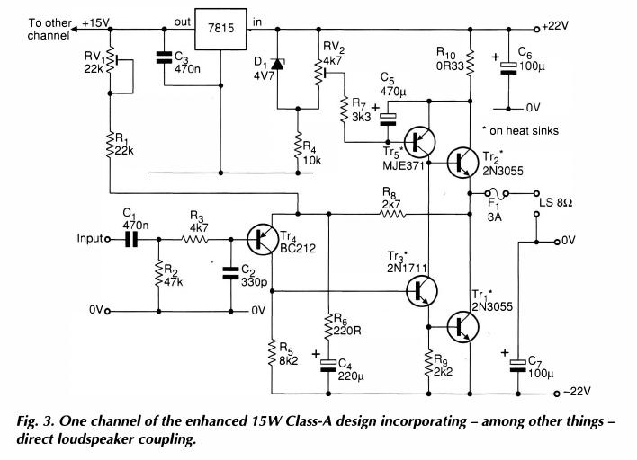

And here is my proposal.
Nothing novel in the compensation scheme. It uses phase lead correction, together with resistors in series with the base of the output transistors acting as "sprog stoppers". An input network provides a degree of protection against slew rate limiting distortion, with a 47 ohm load to makes sure this is resistive at high frequencies. On the output I have added a Zobel network which is probably not essential but recommended to reduce stray pickup from leads etc. at high frequencies. It's a true Zobel in that the capacitor and inductor operate at the same frequency (1.6MHz) so as to not burden the output stages beyond their limit as many networks add another parallel load, but it will mean careful layout still. Don't skimp on the 10nF Zobel capacitor - use a high current type for low impedance. I've seen "any old capacitor" get quite hot in some circuits.
All the electrolytics are large values to improve LF response.
The bias potentiometer has to pass up to 20mA for lowest gain transistors and should therefore be a 1W type even though it should not dissipate more than 400mW.
Depending on the models of transistor used, it offers half to one fifth of the distortion simulated with older TIP3055 type devices at 10kHz, the best figure being 0.05%, at 8W into 8 ohms. Distortion naturally reduces at lower outputs.
Caveats: only simulated. Simulations may not include quasi-saturation so the distortion near full output might be higher. To offset this use a higher voltage power supply (36V) and increase the heatsink accordingly.
I might even build this to test it!
P.S.- the input resistor is only there for simulation testing. Recommend 100k for real not 1k. And add a 1k resistor on the output side of the capacitor, both to provide pull-downs for biasing in the event that inputs and outputs are not connected.

I would not recommend JLH's solution because the 1nF feedback capacitor is large and creates a small problem, but the real culprit is the 1nF and 100 ohm on the base of the driver transistor. That really kills the gain in the PNP input transistor, which is operating at a low current and will lead to cutting off for a fast input signal. Adding a resistor in series with the feedback capacitor corrects the phase at high frequencies, and the sprog stopper resistors become useful when using high speed transistors.
But you are welcome to try JLH's solution if you prefer.

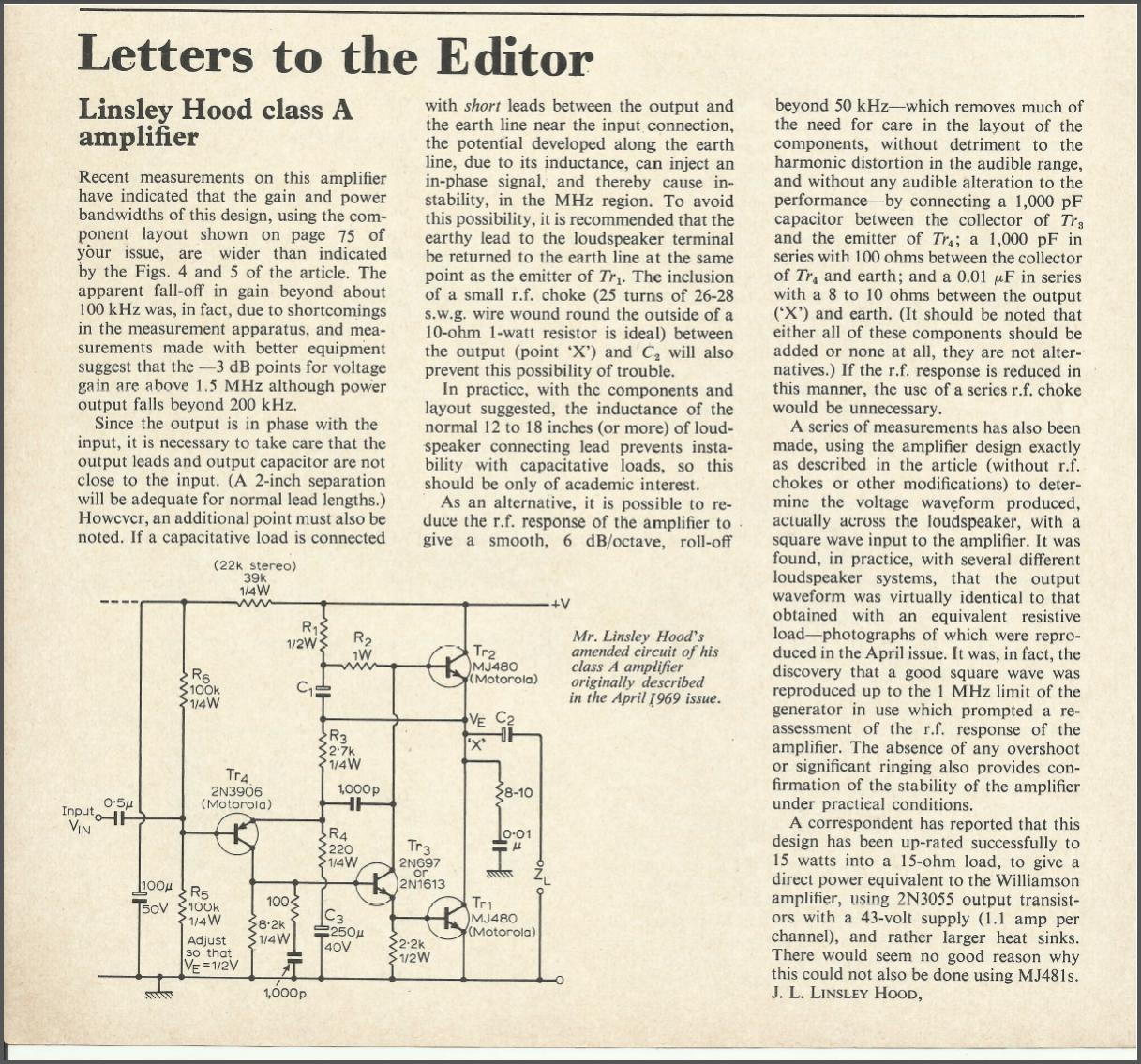

Ok go back to his original article and a comment about what sets the output voltage. No standing current adjustment - what does the dc and ac feedback do?
He tries different gain arrangements on the output transistors. As the best figure matches his main graph at 9w he is likely to have done all at 9w but the problem is still likely to be the mismatch. He also says
and for the lowest possible distortion with any pair, the voltage
at the point from which the loudspeaker is fed should be
adjusted so that it is within 0.25 volt of half the supply line
potential. The other results are summarized in Table 2.
but doesn't say how. The bias point of the input transistor could be changed. Later it looks like he shows 2 resistor values in that chain. I think these bias values extend the LF. I have no other info on this one, Or have and haven't really looked at it.
The top transistor is effectively working as an emitter follower - performance some what different to the other that is driving via it's collector.

In another article he points out it doesn't do the transient response much good - think it's the AB amp that on that score doesn't match the original 10w in that respect but power dissipation is a lot lower. There was an interesting letter later from some one about transistors used in AB that pointed out flaws.That really kills the gain in the PNP input transistor,
Setting the centre rail voltage is quite a simple matter of replacing R8 (in the original circuit) with a 22k resistor and series 47k pot to trim it. Chinese kits I think provide something like that. The reason that was important is because the current in the resistors in the collector of the drive transistor then conducts the optimum base current needed by the output transistors. If the centre rail is offset, the output transistor currents will either become limited or the dissipation will be higher than necessary. Seems to me to be a power issue as much as distortion. I would usually recommend setting the centre rail for symmetrical clipping for maximum power.
(A bootstrapped emitter follower is not really an emitter follower as the drive impedance to it is increased. That has the effect of making it operate more or less as a common emitter amplifier, though with bootstrapped resistors the impedance on the base is whatever the bootstrapped resistor value is. For lower gain transistors that has to be lower, which increases the parallel current to the base and increases distortion).
Simulations suggest that there is marginally lower distortion if the centre rail is slightly higher than midpoint, but it is very marginal.
