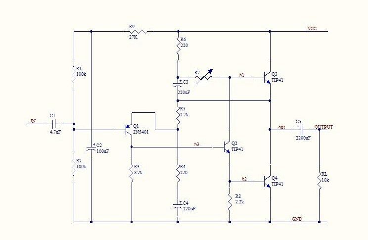

Replace R4 (220) with another (680 ohm).
You can reduce R5 to 1kΩ (in parallel). Gain decreases, distortion decreases due to the higher NFB.
The signal can also be attenuated with a 10 kΩ pot at the amplifier input.
I replaced R4 for a 680 ohm and I'm in the 7th heaven.

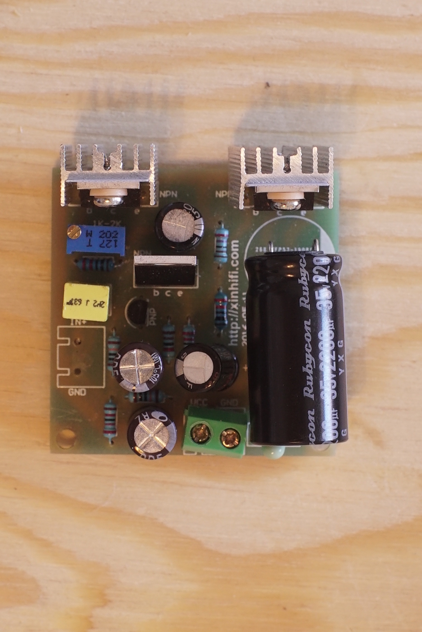

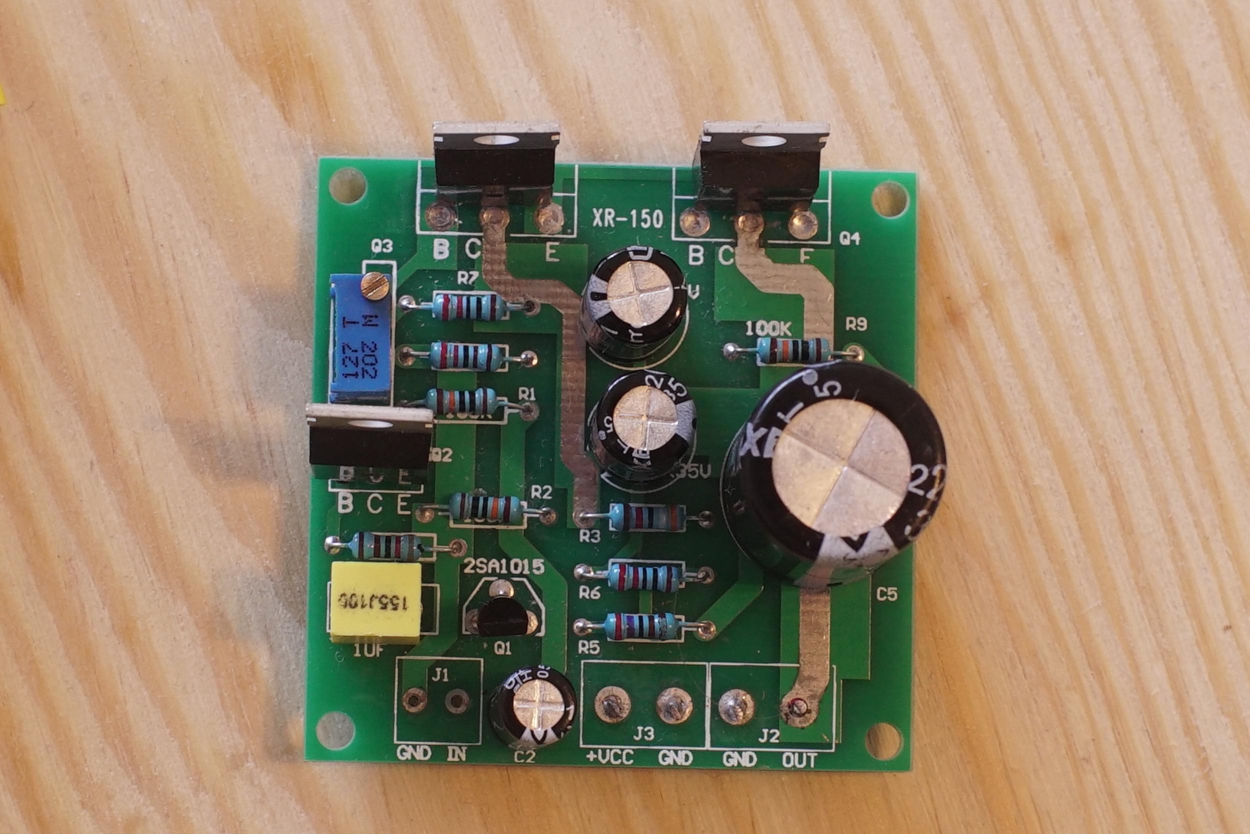

Just for the record, the seller of the mentioned eBay publication (named "tubeshunter") doesn't seem serious enough to me, since the kit in the publication and the diagram (!) don't correspond to what I received from him. The boards in the publication are double layered, whereas the ones I received are single (with quite narrow circuit paths). Besides, the diagram published–original JLH –is for 5 capacitors, whereas the kit received has 7 capacitors. The two extra caps go before the line output, one of them ceramic. I tried to complain but the seller simply insisted this is a JLH
Anyways, maybe those extra caps are the reason why I noticed a big difference of sound between that kit and another mentioned board I got from a Chinese retailer, which sounds much less muffled in my opinion. I analysed and wrote down the circuit of the latter and this time it is exactly the same than the diagram published (but not sent) by the eBay seller.
In attachment you can see both boards, one has more capacitors than the other.
Domingo: In attachment you can see both boards, one has more capacitors than the other - Do reverse engineering. Draw up a diagram for the PCB. You can find a resistor color coding table on the Internet.
The circuit on the right (1969mini) contains the main part of the 1969 amplifier. Power filter capacitors, LED indicators, etc. may be added to other manufacturers' boards.
I got a couple of the boards on the right, labeled XR-150, to experiment with as headphone amps. I haven't listened to them, but the distortion measured quite good completely stock. The only caps missing are the power supply input filter caps, which you can easily add yourself. Their value depends on the supply being used.

I just wonder what the bias current is for the one on the left. It might be set for a very low bias current which might explain some of the observations.
The ones I bought look like the right photo.

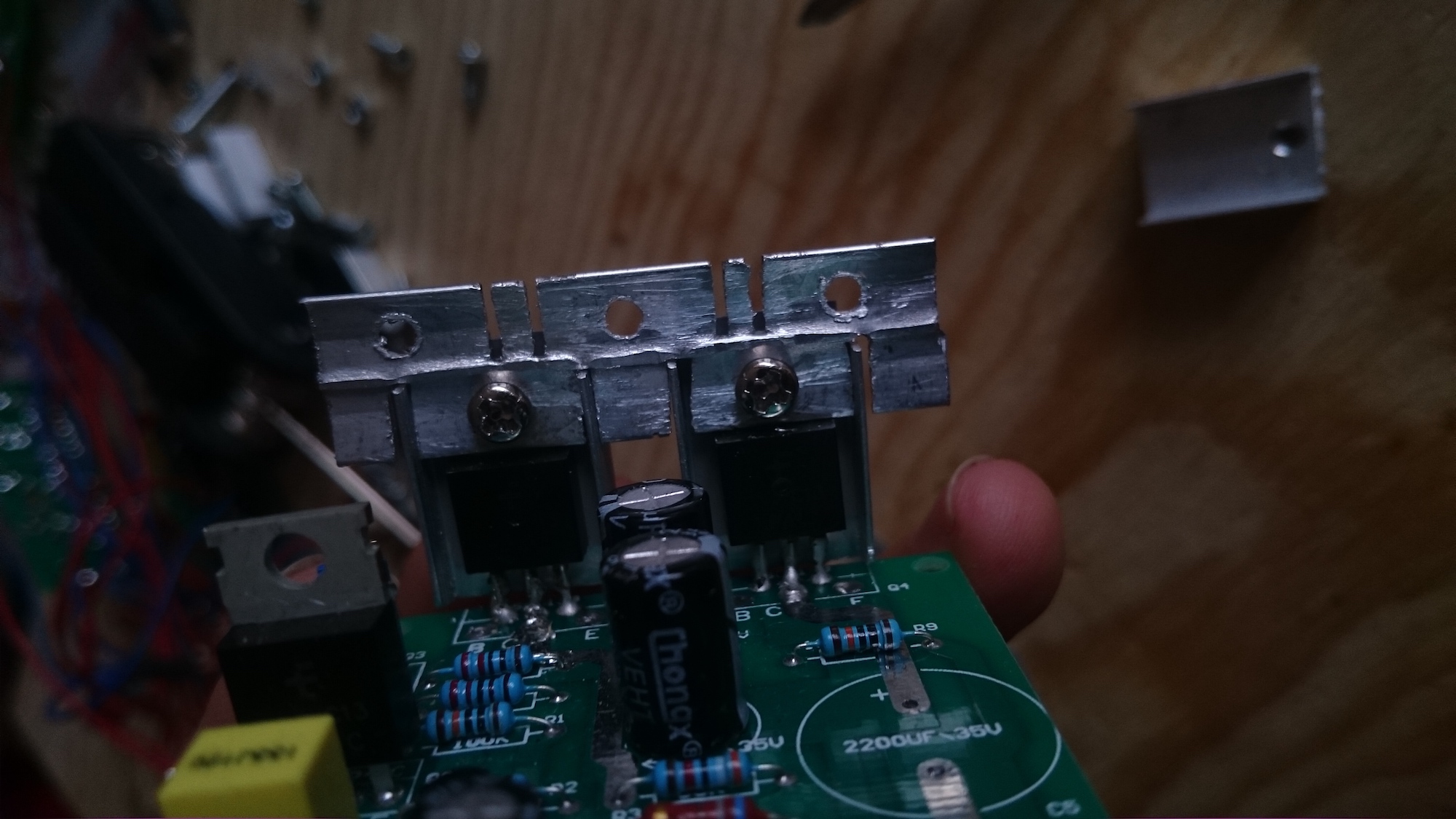

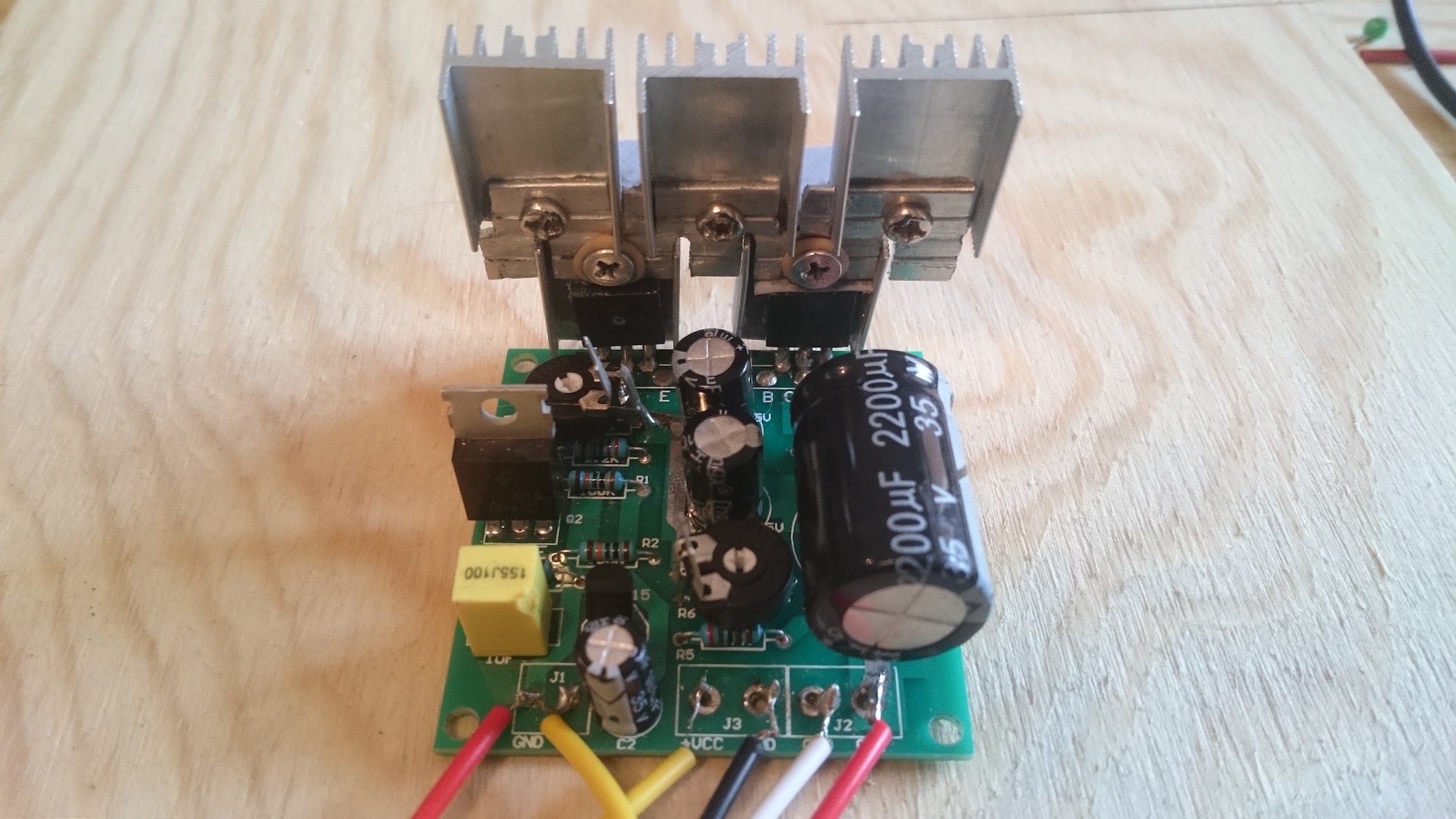

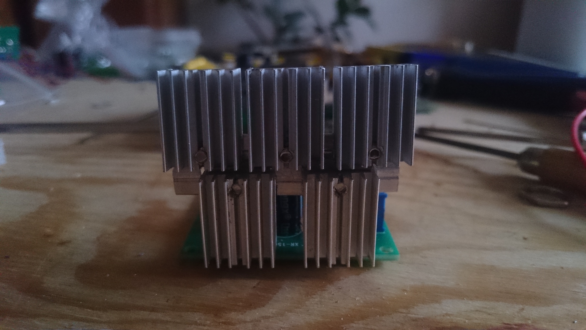

@kronzilla: I added new heatsinks for security, using a piece of aluminium to bring together 5 of those little pieces I had (my space box space is limited). Challenge was to maintain electric isolation but so far it's enough for the bias current range in which I'm testing, between 0.25-0.05A.

I'm reducing gain using a(nother) 2.5K pot I installed in place of the 220ohm resistor before the feedback capacitor (R4 in the diagram shared here again, R6 in the X-150). As resistance increases gain decreases and around 1.1k distortion dissapears for me. I also tried modifying the 2.7K resistor before the PNP emitter (R5 in the diagram), as resistance lowers gain decreases. Reduction with R5 didn't seem to give results as sharp or solid as reducing R4 though, but this was difficult to compare side by side and I wonder if there should be in theory a difference between both methods of gain control, or rather they both do the same (ie. increase NFB because of voltage division).
@chumingo: My apologies, I reduced the gain before testing. With no level control you were no doubt exceeding its limits. I replaced R4 with 1.5k for gain just under 10dB. My dacs output over 2VRMS so that is plenty for my most voltage-hungry headphones. If I decide to use it, it will have a 10k pot on the input, plus some resistance into Q1's base to limit the current with the pot wide-open. Q1 is an unbranded 2SA1015 on mine. I plan on replacing Q2 with something faster and higher Hfe.
I like your custom bracket for the heatsinking. I will be surpriised if it is enough, though.
Jbau: My Q1 is the same. Limiting current at the base of Q1 sounds interesting, I wonder how different would that be from limiting the input signal directly.
I consider the input signal as gold that I wouldn't like to trash away into a pot's resistance, to then amplify the signal again. That's why I'm searching for a way to leave the DAC's signal intact and limit the action of the amplifier itself. Is that what the increase of R4 does? Or does R4 decrease gain just because it increases negative feedback?
Do you know the answer to this @OldDIY? I understood from a previous answer of yours that the increment of R5 increases NFB, but what about R4? It does the same? Sorry to insist on this question.
On the heatsink: To avoid short circuit I carefully cut off the head of a plastic spacer and insert the remaining little tube in the hole of the bracket. So each transistor has two plastic spacers, the one visible in the picture and another headless one hiding in the bracket's hole. There are also two insulating micas in each transistor. One mica on the side of the heat sink and another on the bracket side (not visible in the 1st two pics that I took before isolation). Also M3 screws had to be changed for longer ones. The system works but has to be done very carefully especially the placement of the headless bushing in the bracket's hole. Using sticky compound helps and temperature distributes quite nicely all around. But I understand if you think this is meant to We all are ain't we
