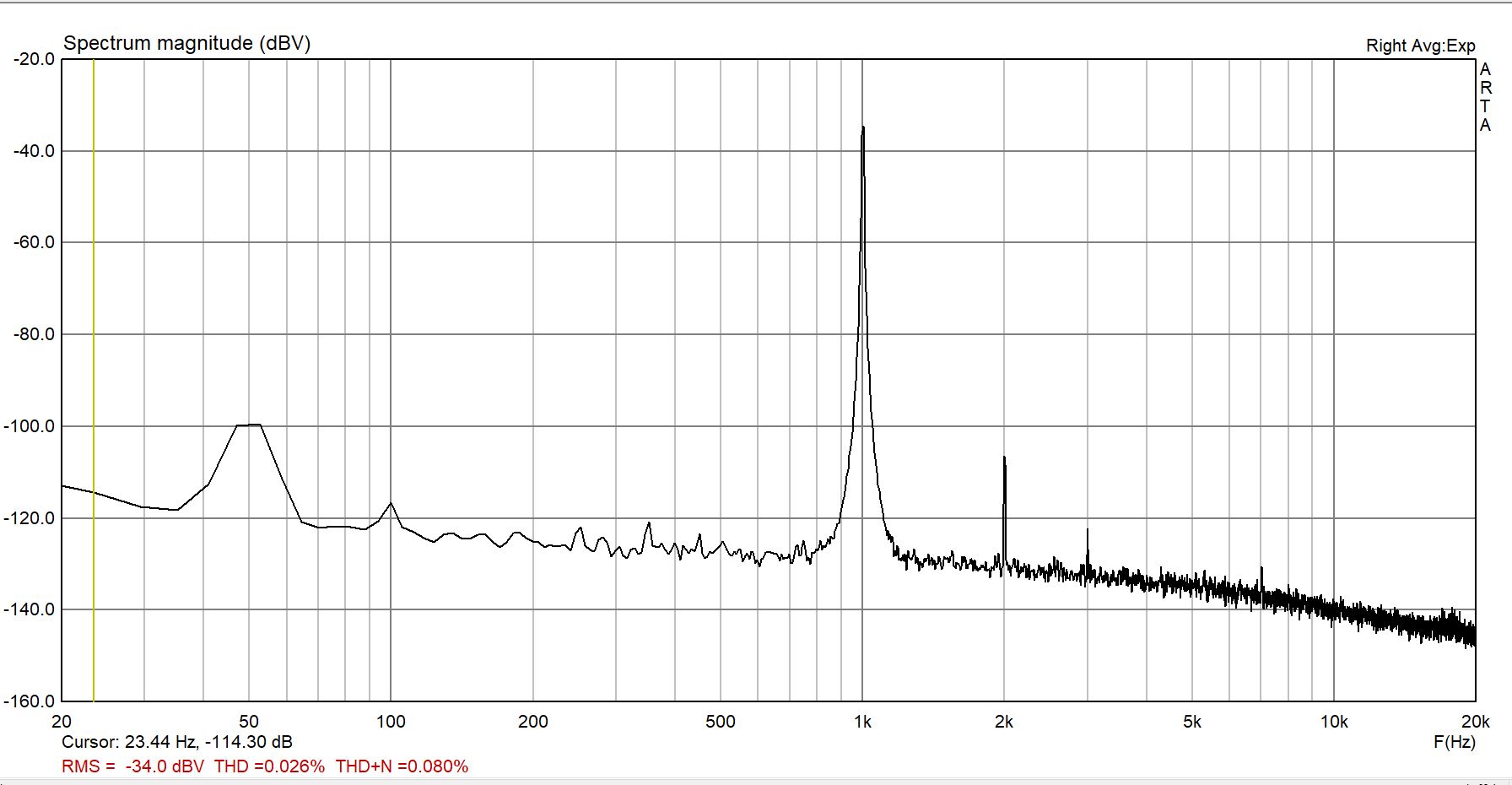

today i measured my JLH with EMU (24V @ 1.2A BC560 + BD139 + BD911(matched) ) - not bad - attached picture for 1W @ 8 ohm dummy load.
Clean up to about 6-7W in audio range ... then begins the harmonic "forest" ... below 1W THD approx. 0.007%. 50Hz Noise are high from my measurement "setup".

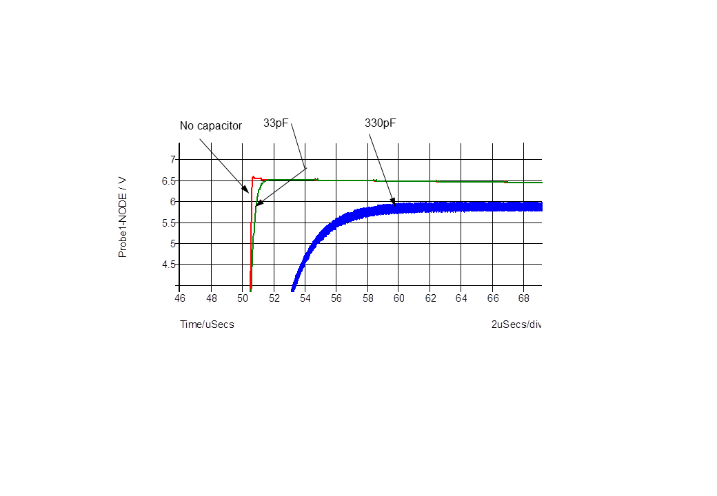

I'm looking at the 1969 article in which JLH says under the heading "Stability, power output and load impedance" - " the author has not found any combination of L and C which makes the system unstable, although the system will become oscillatory with an inductive load if R3 is shunted by a small condenser to cause roll of at high frequencies"
R3 is the 2k7 feedback resistor.
There may be some misunderstanding about fitting a phase lead capacitor on the JLH. I agree that JLH said that the "system will become oscillatory" but so will other designs if the capacitance is large. When JLH made that comment he might have been thinking about using such a capacitor to limit the frequency response of his circuit once he realised its bandwidth was higher than originally thought. If a large capacitor is added, the phase shifts it causes can lead to instability. By large, we're talking about capacitances in the region of 100pF or more. For example a 220pF capacitor across 2.7k will give a -3dB at 267kHz. And cause oscillations in simulation, so almost certainly in practice.
A small capacitor on the other hand is stable in a Tian probe with 90 degree phase margin and better than 30dB gain margin, using 2SC5200's. It might be better to have a larger margin. So it seems to me that a small capacitor is acceptable and I have used 33pF successfully with a speaker (inductance) attached without problems. Compared with a "bare" 2SC5200 which had a phase margin of 70 degrees and gain margin of 20dB.
However that should be stable, but with less margin.
Another problem with a phase lead capacitor is that the UGF is higher. So that might be an issue with feedback if wiring and layout are unsuitable. Filtering the input won't change the stability issues unless the input conditions are improved by the addition. The input impedance to the first transistor may be problematic with some preamps as the JLH input impedance was high. A high input impedance from the preamp will cause the input transistor frequency response to fall - and that may cause unwanted phase shifts which may mean adding a phase lead causes problems.
I haven't exhaustively investigated this but those are some of the issues I have uncovered.

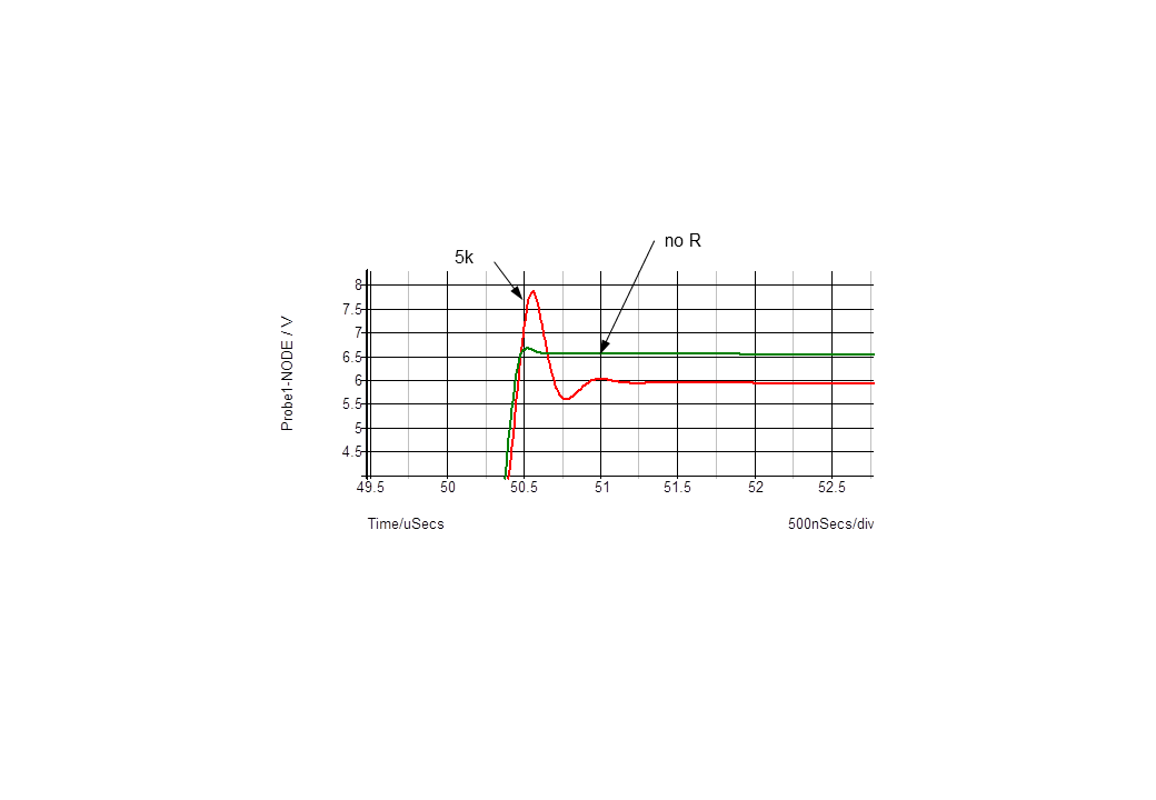

Nigel- interesting video. Somehwere buried in this thread is one of my posts showing the simulation results of rise time of an old 3055 (the 2N3773 was worse, though, and I think the presenter might have chosen that deliberately - I'd never have used a 3773 in an audio amp, but did use them for a high power power supply once) compared with an epi 3055 which tied with the 2N3716 but all were beaten by a 2SC5200 or MJL3281A.
Diagram is for MJL3281A andy_c model with 200uH-5ohm dummy load.
