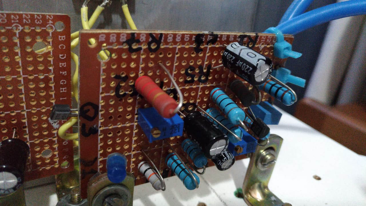

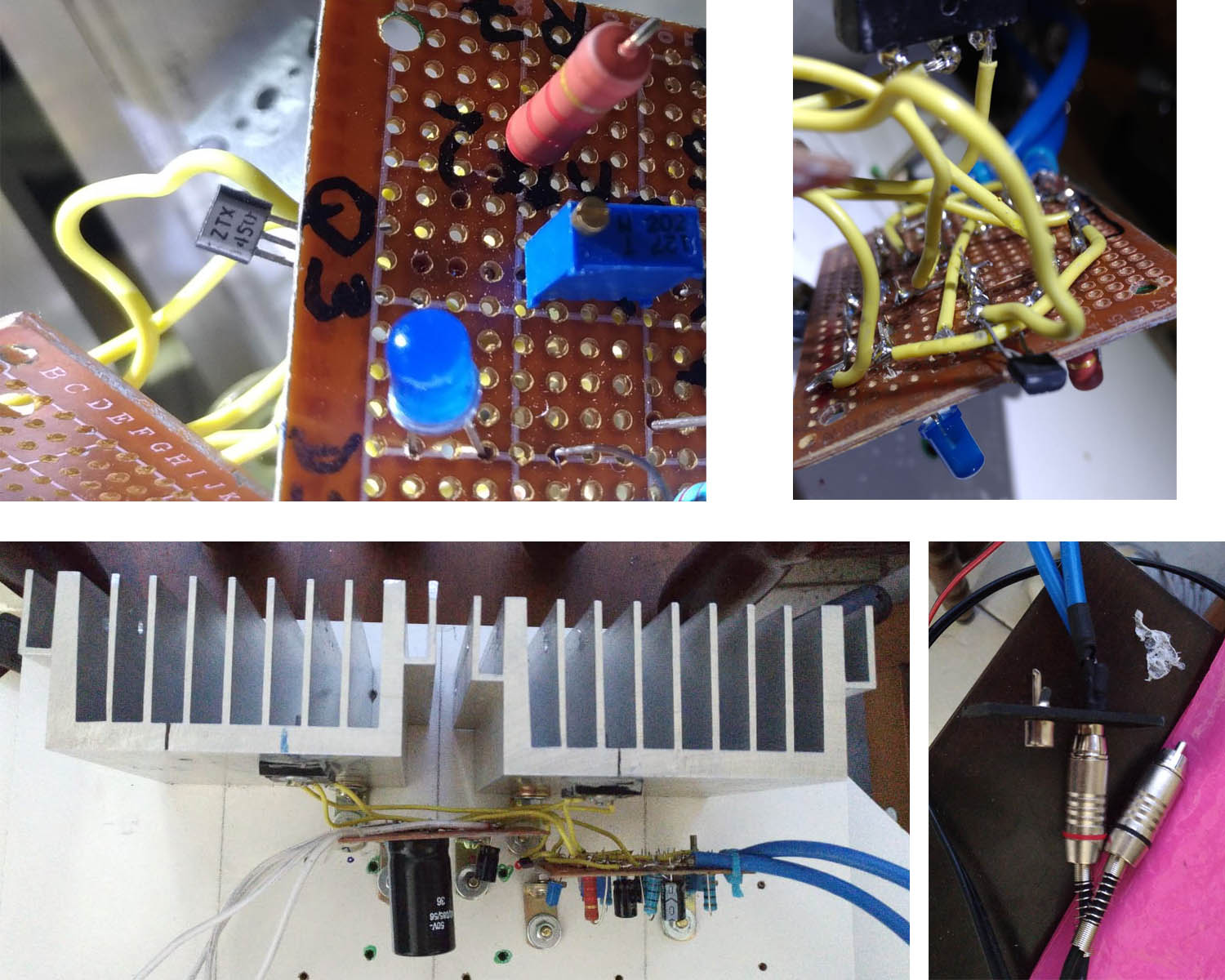

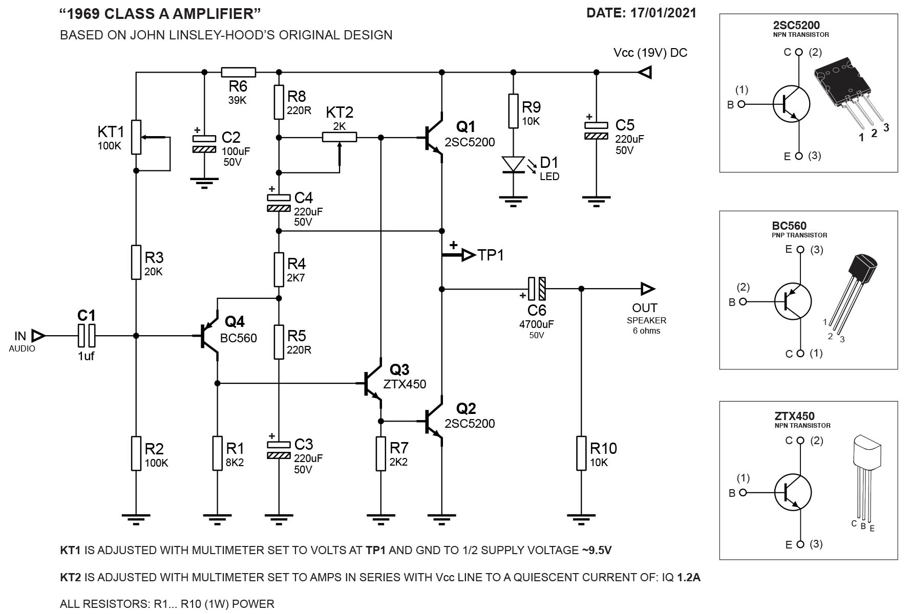

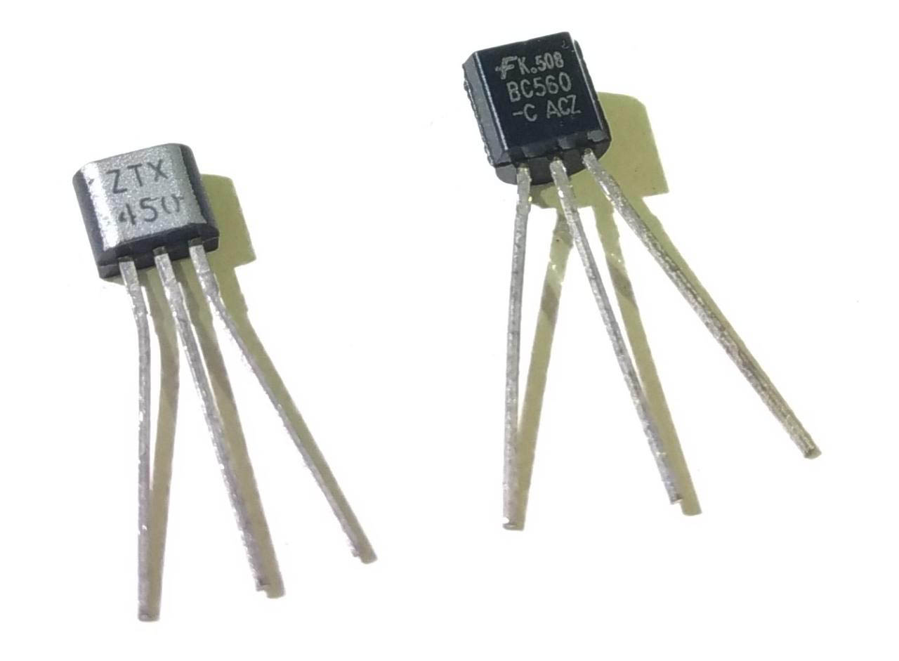

Update Circuit Q3 and Q4
Hi, altus fidelitas.
I did an update on my circuit.
I replaced the Q3 and Q4 transistors.
Q3 (before: 2N1711, now: ZTX450).
Q4 (before: 2N2907, now: BC560).
I'm still doing some tests.
Thanks for the tips guys!
You could consider replacing 2N1711 with a ZTX450. It has better gain and linearity than both the BD139 and 2N1711. I used it in my recent build and it sounds good.
Some concerns that it comes in a tiny E-Line package, but its specs add up and they were not at all warm when I measured them.
I replaced the Q4 (2N2907) with a BC560, a low noise signal transistor. But original ones are difficult to get these days with lots of fakes around. Apparently BC850 shares the same die as the BC560 but its in a SMD package.

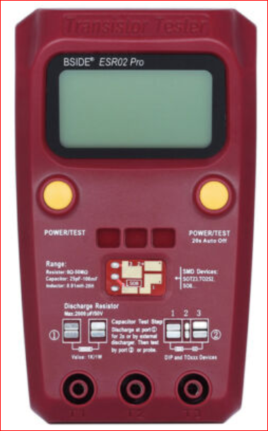

The attached image is of an unusual Chinese component tester adapted for SMDs but I can't recommend it because the display is awful, it's now way overpriced, a 9V battery is required and it does no more that any other ATMEL 328 based tester. However, I think its SMD test feature is more or less along the lines of yours and it has gold plating on the contact pads which does improve the consistency of measurements a little in my estimation.Not sure how to handle SMD devices as they can be difficult to contact but I have used a small PCB layout with a small spring loaded pin on top, but keeping them in place is sometimes tricky..
A clip that keeps the little devils in firm contact is probably essential but not if it can slip and launch them to oblivion instead. It wouldn't be all that difficult to copy the jig essentials and adapt it to your existing instruments with some gold plated copper foil pads on a board. Then add a mask or close fitting jig cut from sheet plastic to keep any particular outline SMD aligned correctly on the contact pads. The pads could simply couple to your own preferred semi testing device via PCB pins, header and 3 core ribbon or whatever suits your purpose.
Gold plated leads are almost mandatory for reliable contacting.

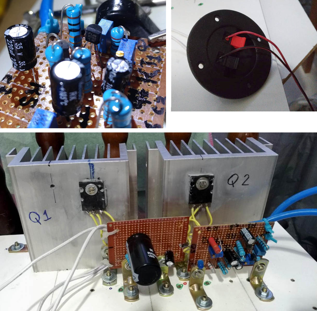

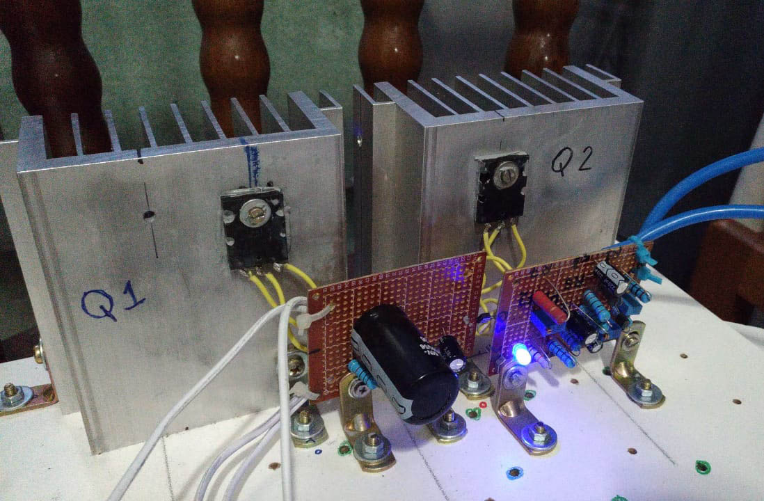

My 2SC5200s have arrived. 4 out of 5 have very healthy gain (150-170 range). The 5th one is way down at 58. Good thing I only need 4.
I'll be continuing to plan the cooling solution and will probably start building the circuits soon. I am cheating by using a PCB kit from ebay.

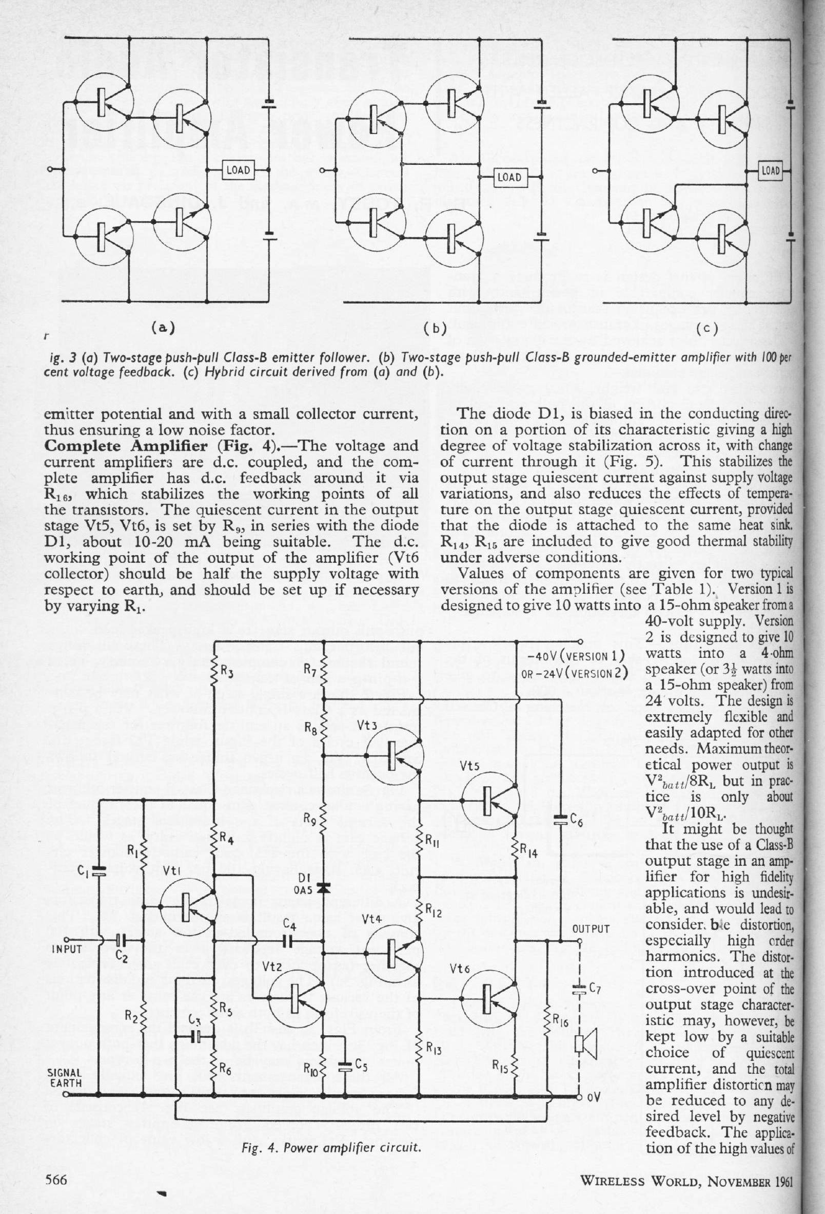

PNP stages require the collector load negative to the emitter.
This example on Douglas Selfs site by Tobey and Dinsdale (1961) is typical.
http://www.douglas-self.com/ampins/wwarchive/Tobey & Dinsdale power amp Nov61 p2.jpg
