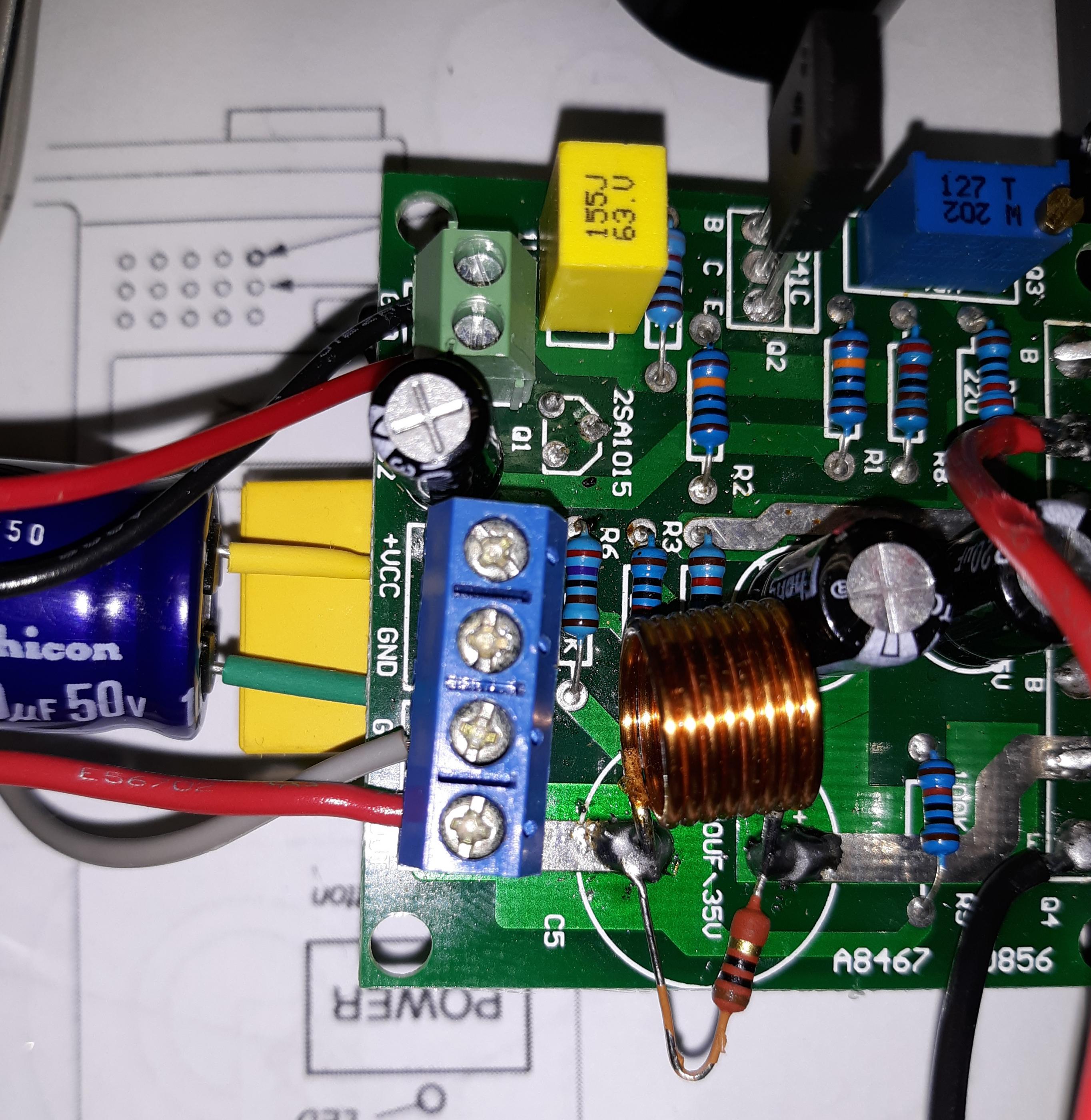

I need some help interpreting the results of an experiment I tried on the mini1969.
As shipped there was an unpleasant distortion with what I will call loud or dense mixes such as hard rock. My latest change significantly improved this but I am not sure why. Before the change there seems to be a combination of a mid and high freq and fatiguing distortion. Plus an unpleasant characteristic a bit like a mild cold or slightly plugged ears. (I find it hard to describe.) None of this is gone now, however it is quite a bit better.

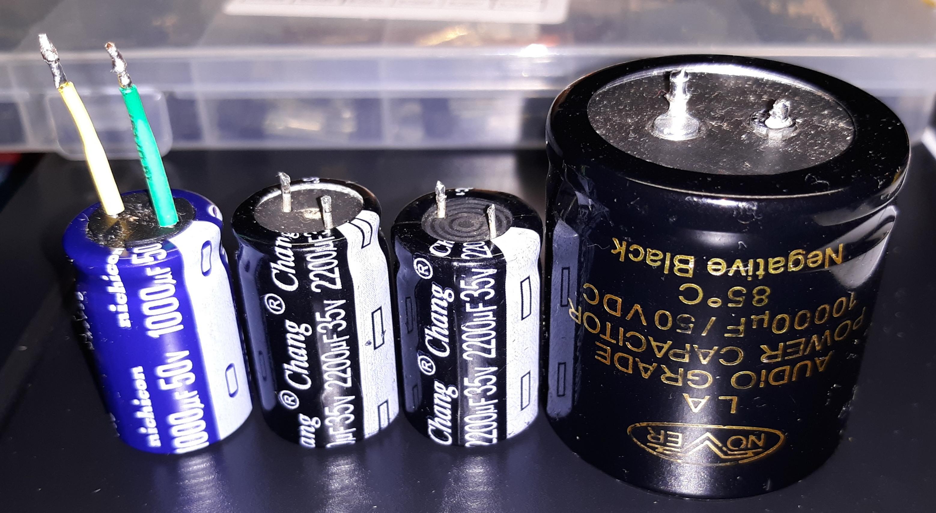

So the problems were present as shipped and were not really much improved with the changes I had made which including the following for the output caps:
1. I left the factory installed 2200 uF 35 V "Chang" branded capacitors installed.
2. I added a 0.47 uF MKP to the bottom of the board and left it there.
3. Then I added a Nichicon VX series 1000 uF 50V to the bottom of the board and left it there.
4. Then I left all of the above caps installed and used 16 AWG copper jumpers to install an external 10,000 uF 50V Nover "Audio" Power Supply filter capacitor. (It might be fake and I had removed it from an Ebay purchased power supply filter board that I then populated with known genuine caps.)
None of those made the big improvement. Now here is what made the big but not total improvement:
Next I removed all of the above and installed an inductor (and parallel 10 Ohm) resistor like a jumper where the original factory installed 2200 uF 35 V "Chang" branded output capacitor was installed.
I did this because I am afraid of oscillation with the genuine TTC004 driver and LJM kit D1047 outputs installed in one channel. (I had also earlier removed the 2SA1015 input transistor and soldered a genuine KTC1845 input transistor to the bottom of the board.)
I made the same changes to the other channel which is genuine TTC004 driver with genuine TIP35C outputs. Both channels had a similar sound and similar distortion.
For the output capacitor I used the "out" terminal to connect the same 10,000 uF 50V Nover "Audio" Power Supply filter capacitor. (With the same 0.47 uF MKP soldered to the terminals of the cap.)
The difference is striking but I am not sure why.
Is it because I installed the inductor (paralleled by the 10 Ohm) due to fear of oscillation?
Or is it because I removed the 2200 uF 35V "Chang" factory installed output cap? (The "Chang" caps on each board look a little different on the bottom, see photo.)
I have enclosed pictures of the capacitors and the location of the "jumper" over the original output capacitor location (inductor and 10 Ohm).

I hate to say it, but this is where a 'scope shines and you could then probably identify what type of misbehaviour the amplifiers are actually up to. To attempt some answers, the coil/resistor combo is unlikely to cause problems but I wouldn't use it when there is already a massive output cap. in series, as that forms a likely nasty (even if damped) resonant circuit.
Though I'm not clear on what parts you have to work with, I'd revert to original condition and retest each module to be certain whether they both have the same problem. Then you'll know whether it's a parts quality/design problem or its an error, bad part, soldering etc. Replacing the TTC004 with something slower would be a better way to check for oscillation if you have no direct means of checking it. Maybe BD139 or even 2N5551 would be ok to use for a brief test at low output level.
