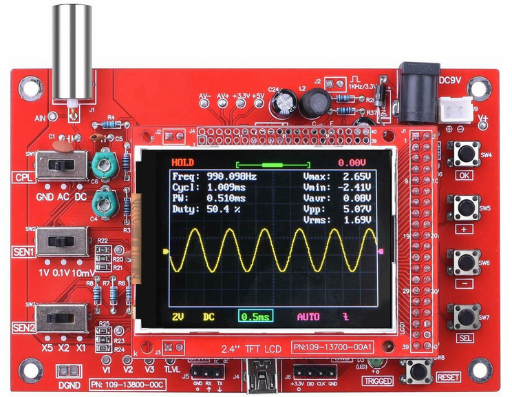

Well I never bought a real oscilloscope for home. I have several Arduino based ones that I built but those top out at 1MSPS.
I do have the little oscilloscope shown in the attached photo. I will try that. My experience looking for oscillation mainly involves spectrum analyzers on RF amplifiers. So should I just look for a sharp versus fuzzy/broadened output waveform with say 10 kHz input sine wave? Should I input a 10 kHz square wave and look for ringing?

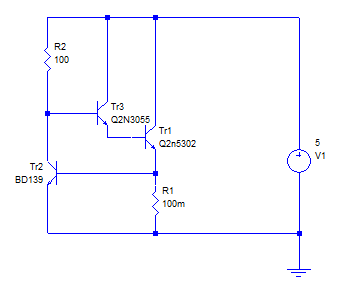

I had in mind a simple circuit to power a device. You can probably find resistors to suit. This one simulates at 7A in the test device (Tr1) with the models used.
Circuit is not critical, almost any suitable transistors can be used eg TP41 for the driver, and the current limiter. 2N3055s tend to have high gains around 100-500mA so can provide useful drive for (even higher) power devices.
That reminds me of a Darlington booster with current limit to boost the current capabilities of a three terminal regulator.
I should be able to build that easily with spare parts from repairing amplifiers. So I think that passes the test of using parts readily available to other DIYers who might want to provide measurements from their own real versus fake output transistors.

To measure the temperature of the device you need a thermocouple mounted as close to the metal tab of the device as possible. If the tab is accessible when mounted (TO-218/ TO-220 for example) that would be a good place for it. If it is only a surface plate (TO-264 etc) then you could either mount the thermocouple directly under it on the opposite side of the heatsink, or possibly, drill a small hole though the sink to allow the thermocouple to contact the metal plate (but that will change the thermal resistance a bit!). There should be direct contact between the transistor being tested and the heatsink, ideally zero degrees per watt, but you may get 0.1 using thermal compound (or these days a graphite film).
I guess you have arduino projects, or A DMM, which can measure temperature with thermocouples.
Integrators are fine too, if the voltage is limited. What voltage range do they work on?
No, I've not got one of those either. Though my little meter is hand-holdable.

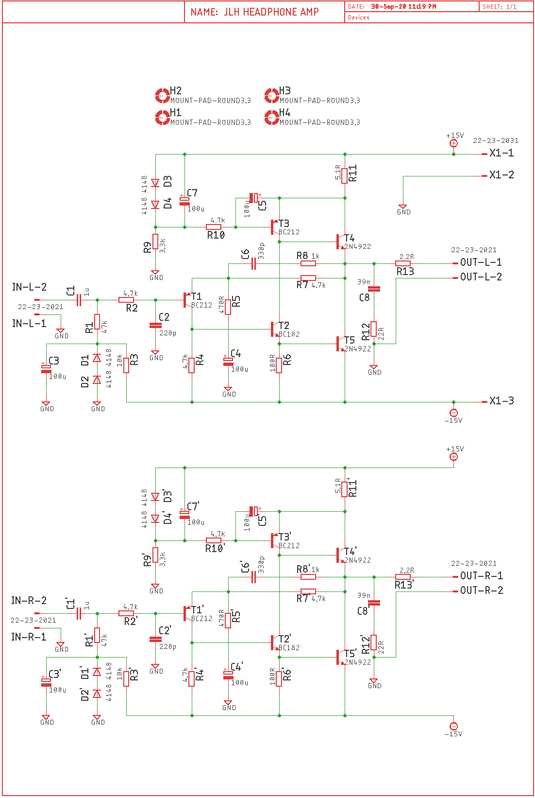

I came across this JLH HPA sch on The Class-A Amplifier Site - JLH Headphone Amplifiers website. has anyone built it?
Also any suggestions regarding sizing of resistors and setting up?

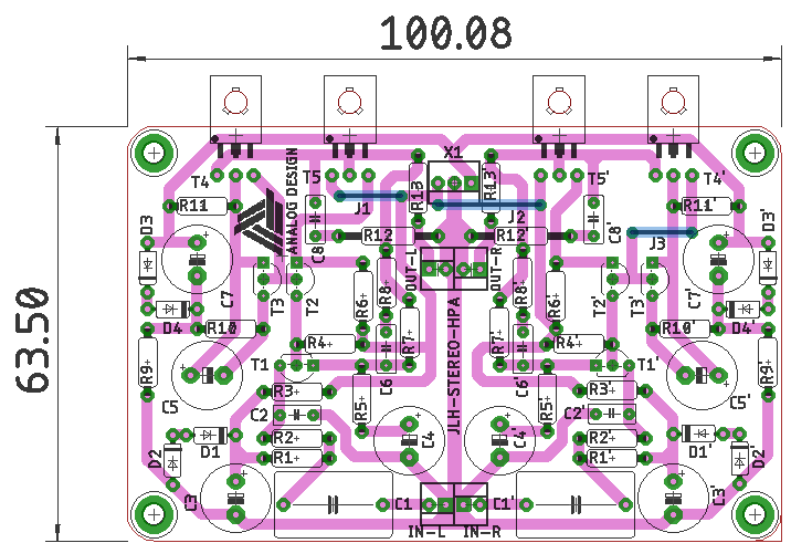

PS Rough layout is attached, for reference of packages used.

Hmm, a 5 transistor JLH? I don't think you want to get involved with that design as there are a few HPA designs that follow the original JLH design and you wouldn't enjoy having to defend this particular variation unless you had compared it with one similar to the original, yourself.Hi,
