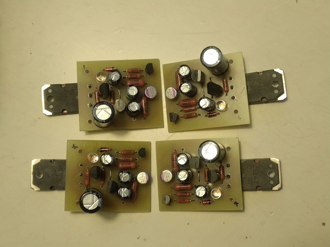

The measurements improved on the Zerozone NPN board with 2SC5242 (originally with TIP41C) when I was able to increase Iq. They seemed happpiest between 1,5-1,8A with the 19V brick. That is a little high though, just generating more heat without extra output..
I used 5,6 & 1,8ohm resistors in series as load, and jumpered the 1,8ohm during measurements, and distortion jumped up abt 10dB with that small change. However, that is when the Iq is adjusted for minimum distortion in the 7,4ohm load. With some small adjustment in Iq, a few dB's decrease in distortion could be gained back with 5,6ohm. It is now around -90db for single sine and IMD with 7,4ohm.

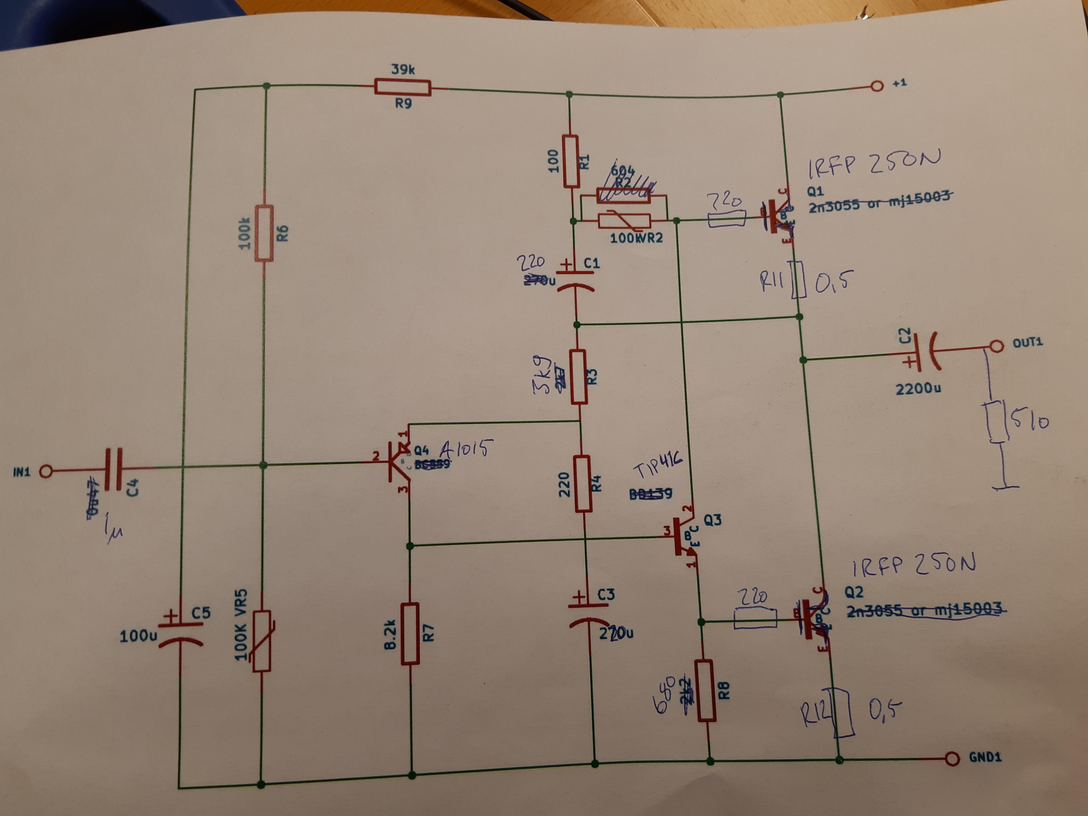

I remembered your suggestion and did a quick and dirty test and replaced the current source mosfet with a bipolar today. Still with a 220ohm 'gate resistor' on the base of the bipolar.
Distortion increased quite a bit, and distortion spectrum now looks like a standard JLH with a little bit high distortion, second harmonic at maybe -56dB, and the others falling from this. With dual FETs, it had almost only 2nd and 3rd harmonics, both in the -80dB range. Iq seemed more stable with the bipolar.
It does have an overshoot on the negative flank with square input with both versions, but the overshoot was more narrow and possibly a bit smaller with one bipolar.
In favor of the fet-version is the ability to drive low impedance, very little increase in distortion with lower impedance.

The FET-version has some resistors already, but maybe your idea is a series resistor after the feedback point?
Sketch of the circuit from post 5776:
https://www.diyaudio.com/forums/att...h-10-watt-class-amplifier-20200108_133906-jpg

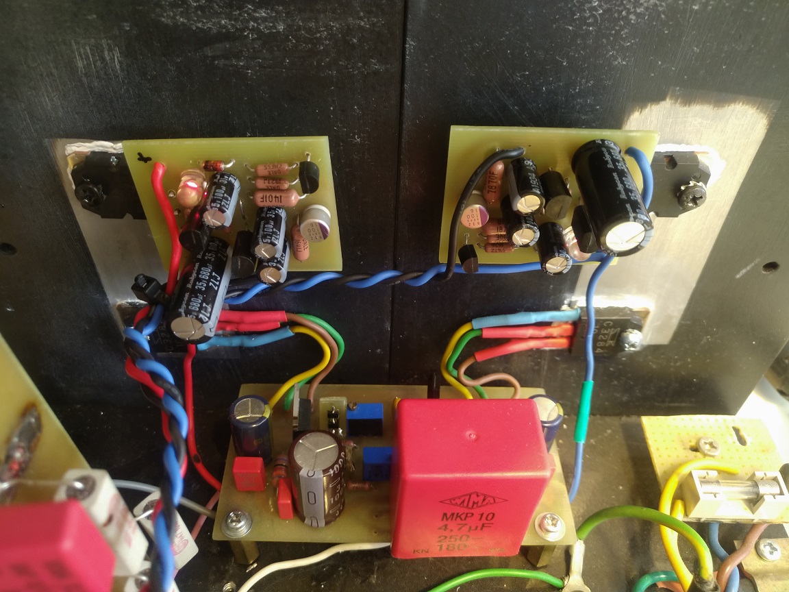

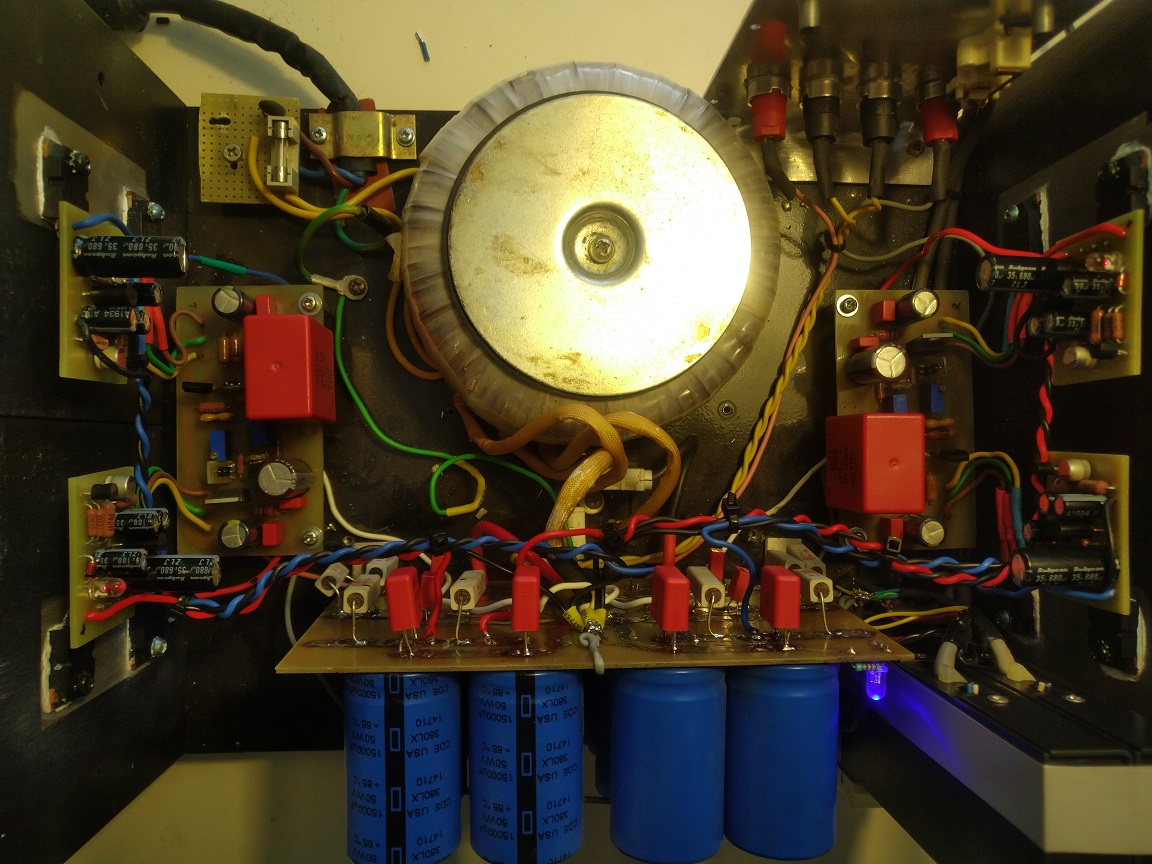

Today I finally finished all four regulators for my JLH69. Two for positive and two for negative voltage. Now the power supplies of both channels are separated by regulators. The voltage drop is about 3V, the current through each is 2A and the output voltage from the regulators is 19V. The scheme remained the same except for changing R1 to a higher value (18.2 to 24.9 ohms). In ltspice I have an improvement of almost 20dB, the difference is only in 2A less current through the regulator.
I haven't done any big measurements yet, but the first test results are better than the 4A version.
Also, hearing tests are better, even my wife hears the difference.

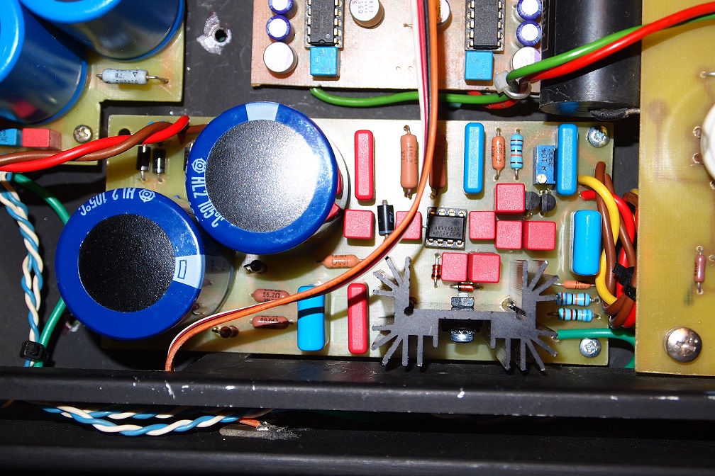

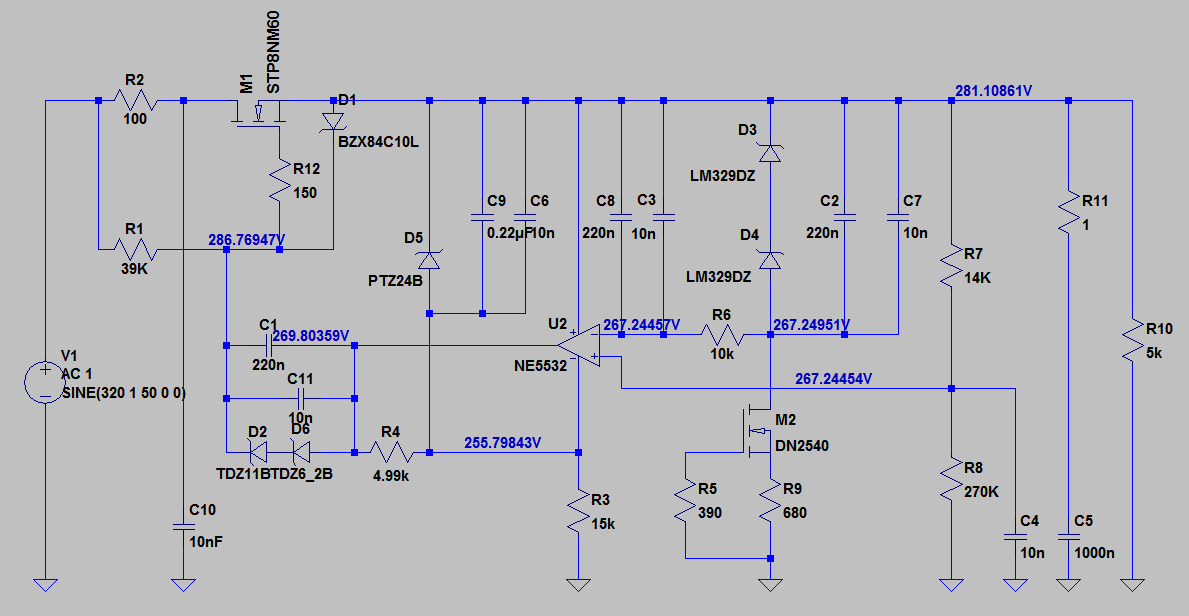

For my valve DAC I use this shematic, orginal is from ARC LS25MKII.
This is the best HV reg. I ever made.
