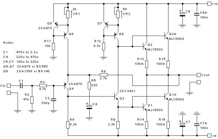

I'll take it apart again when I get some free time, but in the meantime I've attached the schematic.
I've not seen the PNP version before so I am interested in how you are going.
I ran the supplied .pdf circuit into LTSpice and got the following*:
250 ohm to bias at 1Amp.
Max potentiometer value of 100K yields balance voltage at 9.6ish volts.

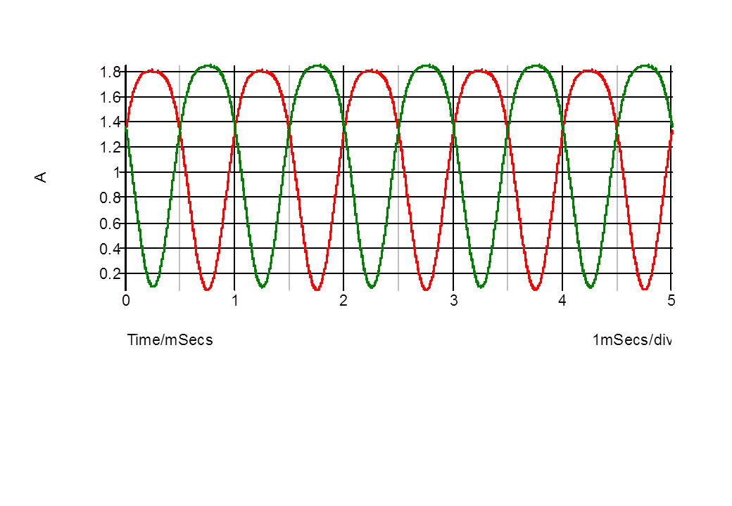

Simulation at 23V supply, 10V peak into 8 ohms 0.08% at 1kHz.
Data sheet shows slight decrease in gain at below 2V for 2A current, hence with approx. 11.5V per side I limited the output to 10V peak, 8 ohms.
Comparison with NPN (2N3055 (epi)) output THD at 10W (30V supply) 0.24%
Transistor currents illustrated for 3055. 22% distortion, mostly 2nd harmonic, in each!
