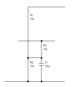

That's right. I think what people will do knowing how this thread goes is use 30 000 uf then add the capacitance multiplier. What I should have said is 1.3 V plus whatever ripple peak to peak.
I just had a thought. And yes it's been thought of. I have never tried it. LD1084 could be used. A regulator as capacitance multiplier.
https://www.ednasia.com/news/article/lm317-cleans-up-but-doesnt-regulate
So you could use a gyrator. (just a concept) Could also incorporate a Zener easily.

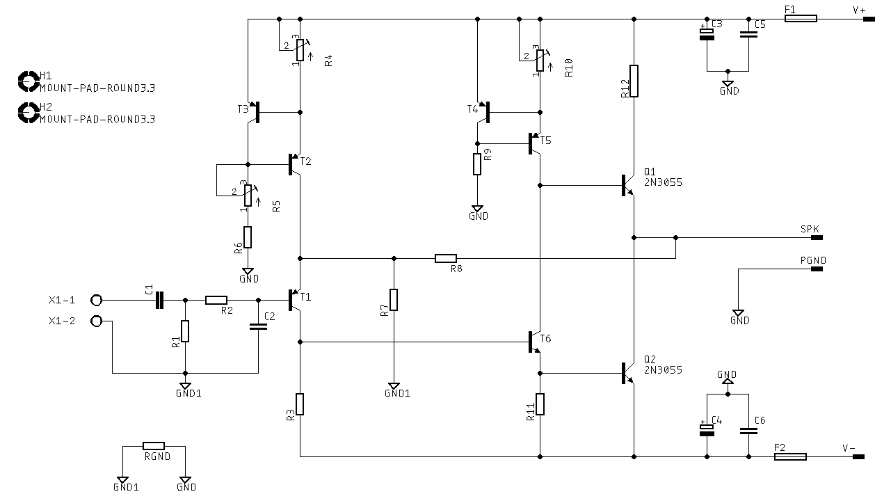

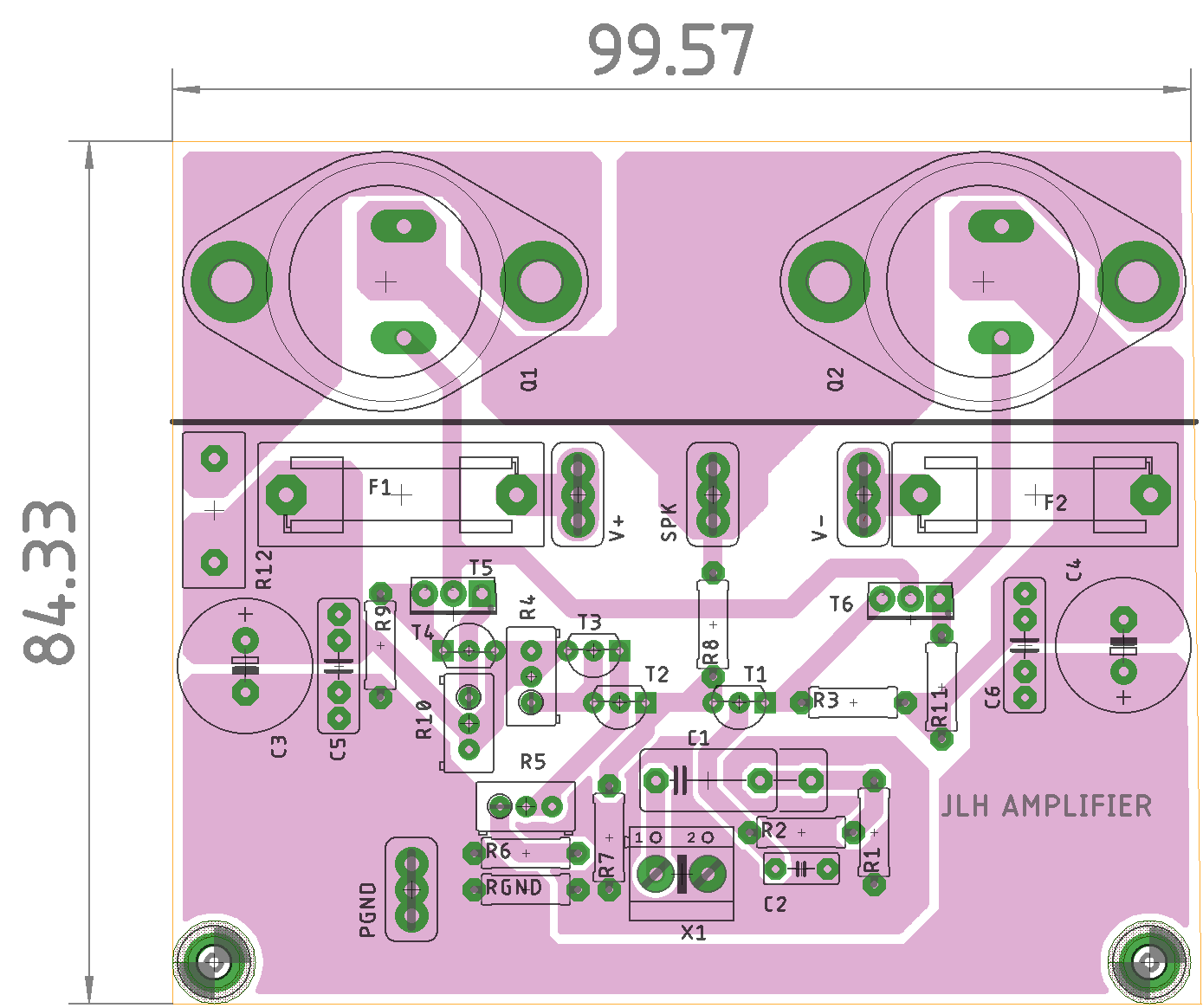

here is something I drew quickly. Although not very optimal, I always like to keep signal traces as short as possible. Height of PCB can be made smaller too, lots of open areas.
I drew the ckt as per fig 2 of The Class-A Amplifier Site - JLH Class-A Update
A very nicely compiled site as shared by Ian Finch.
It also informs on how to connect grounds of amp to PS and SPK grounds.
Pl dont take it as final for your layout, make your own after reading thro the link.
regards
Prasi
edit, i used BC560 cbe transistors for to-92 instead of 2sa970 in the layout.

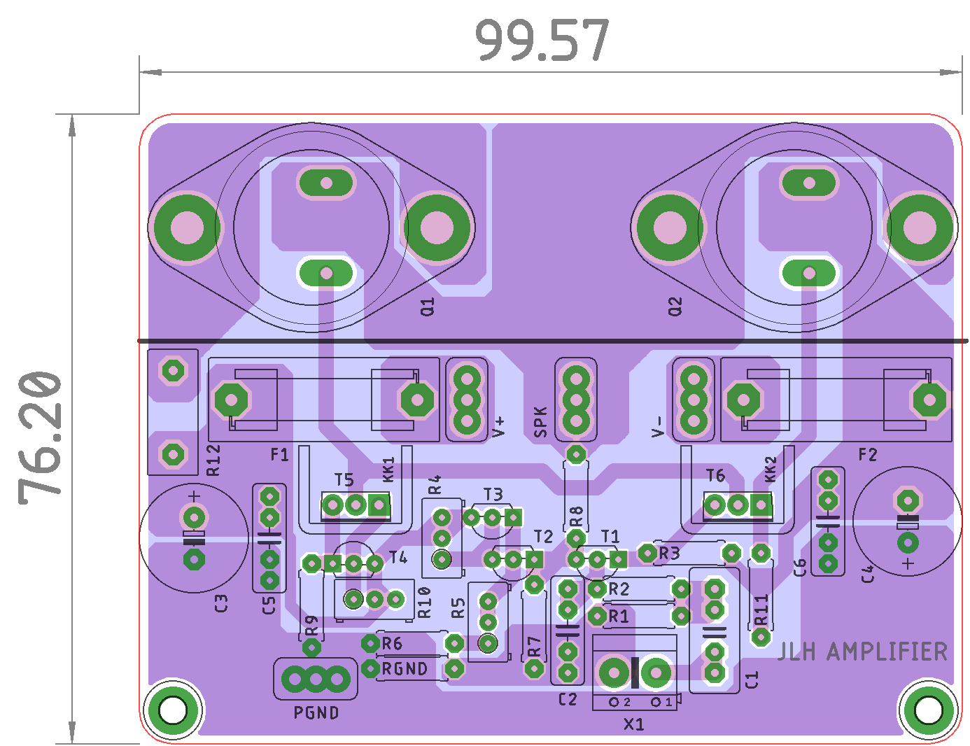

arrangement of components near i/p, heatsinks for the T5/T6, reducing the size a bit and placing a contiguous ground plane on top (blue) results like this.
regards
Prasi
